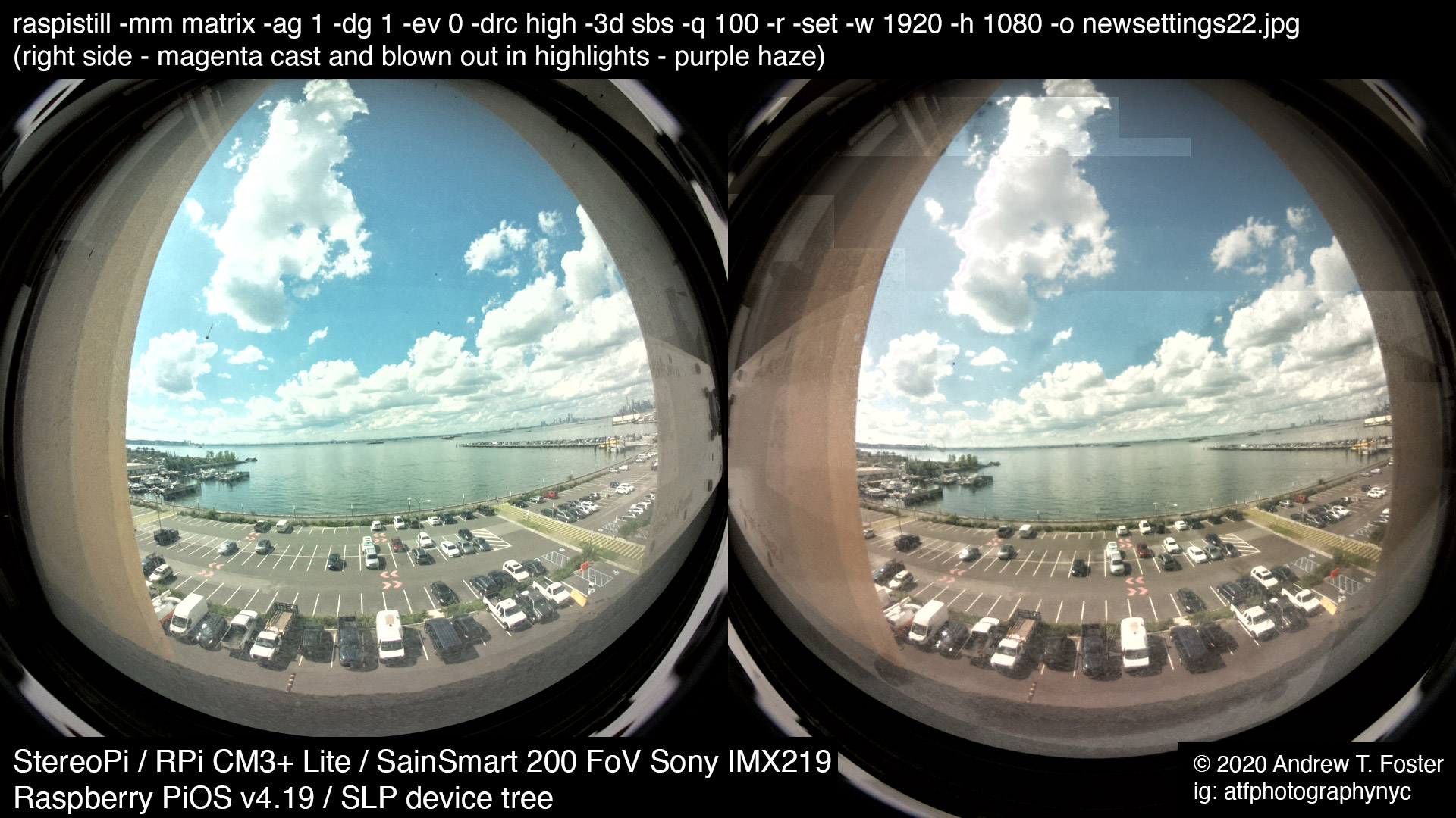

I had a chance today to load up the Raspberry Pi OS (minimal), installed all updates, etc. and gave it a few tests.
Unfortunately this didn't solve the issue with the SainSmart 200 degree FOV cameras _or_ the official Raspberry Pi v2.1 cameras.
After I installed the new version of the OS and got everything updated, I ran the test you mentioned below:
The first result showed the same effect as before using the SainSmart cameras:

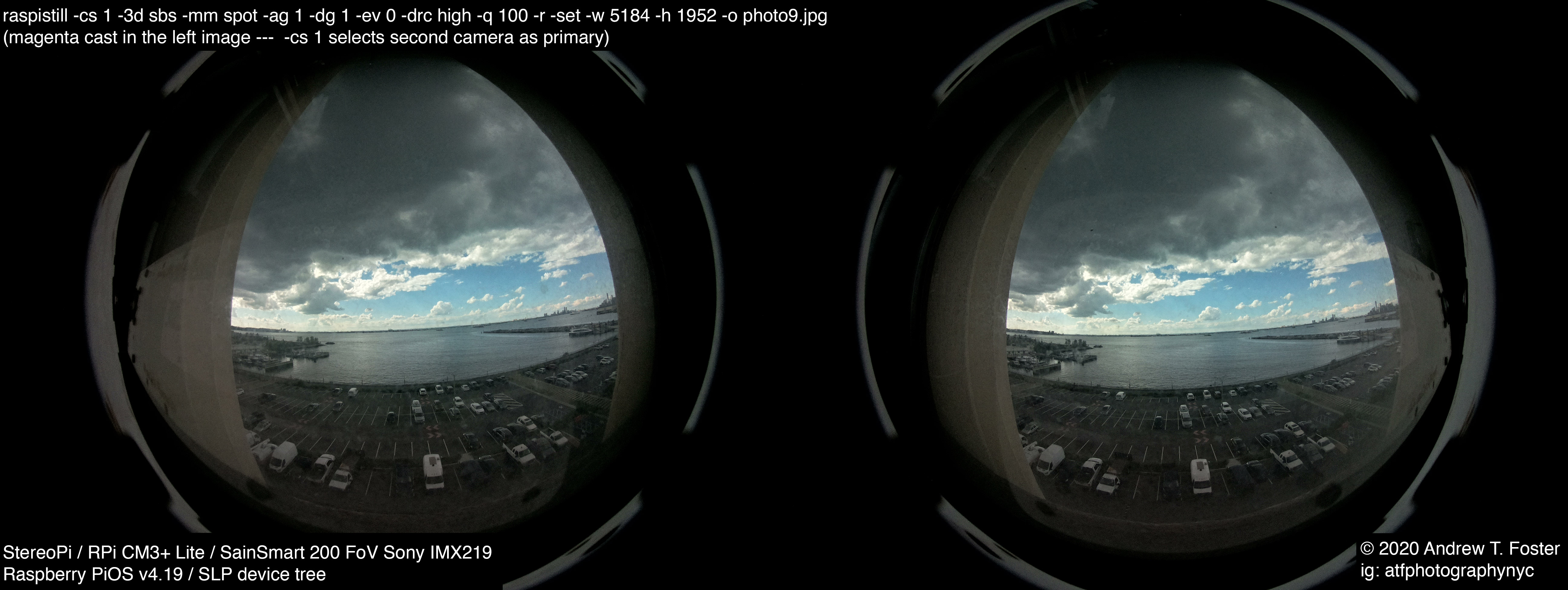

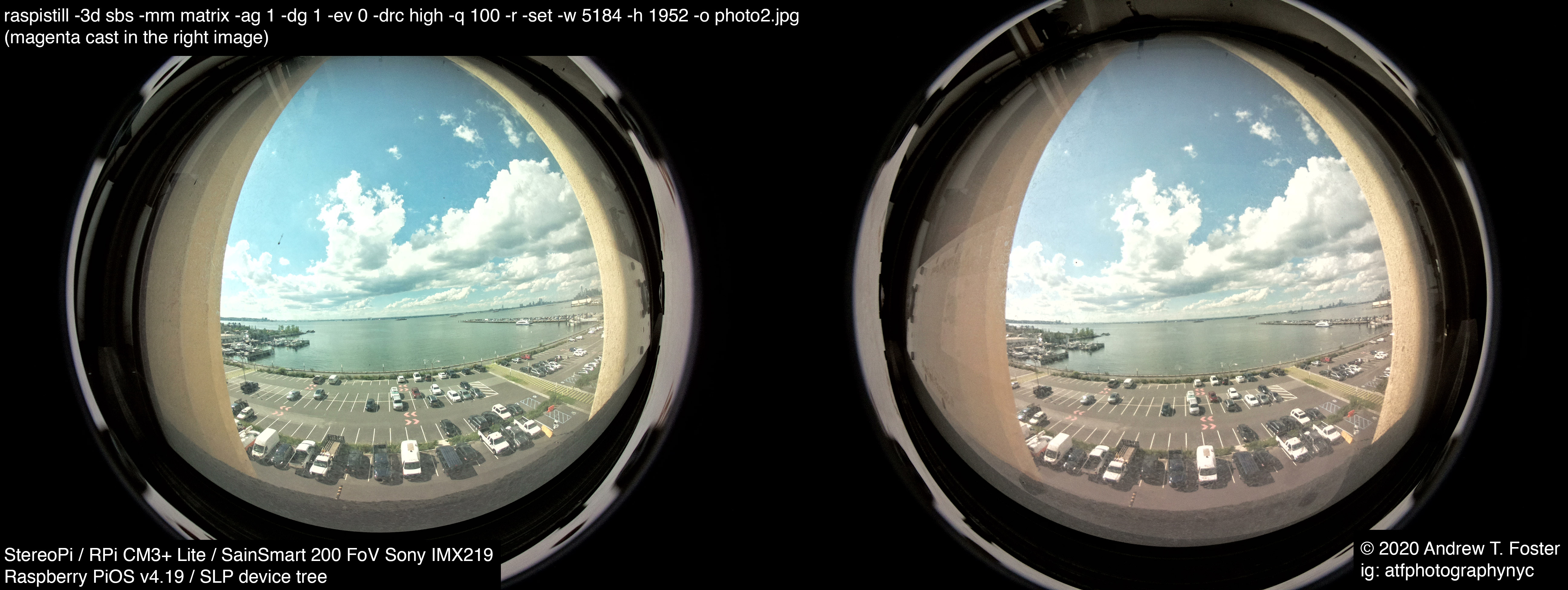

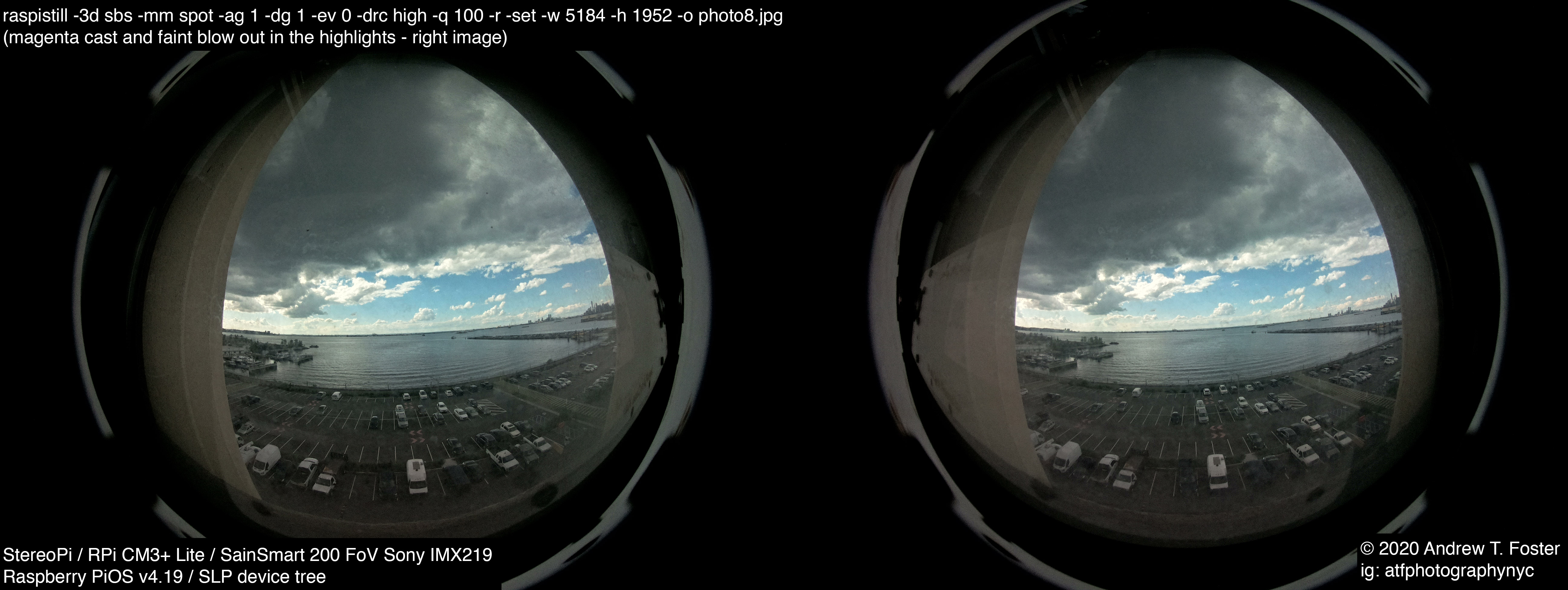

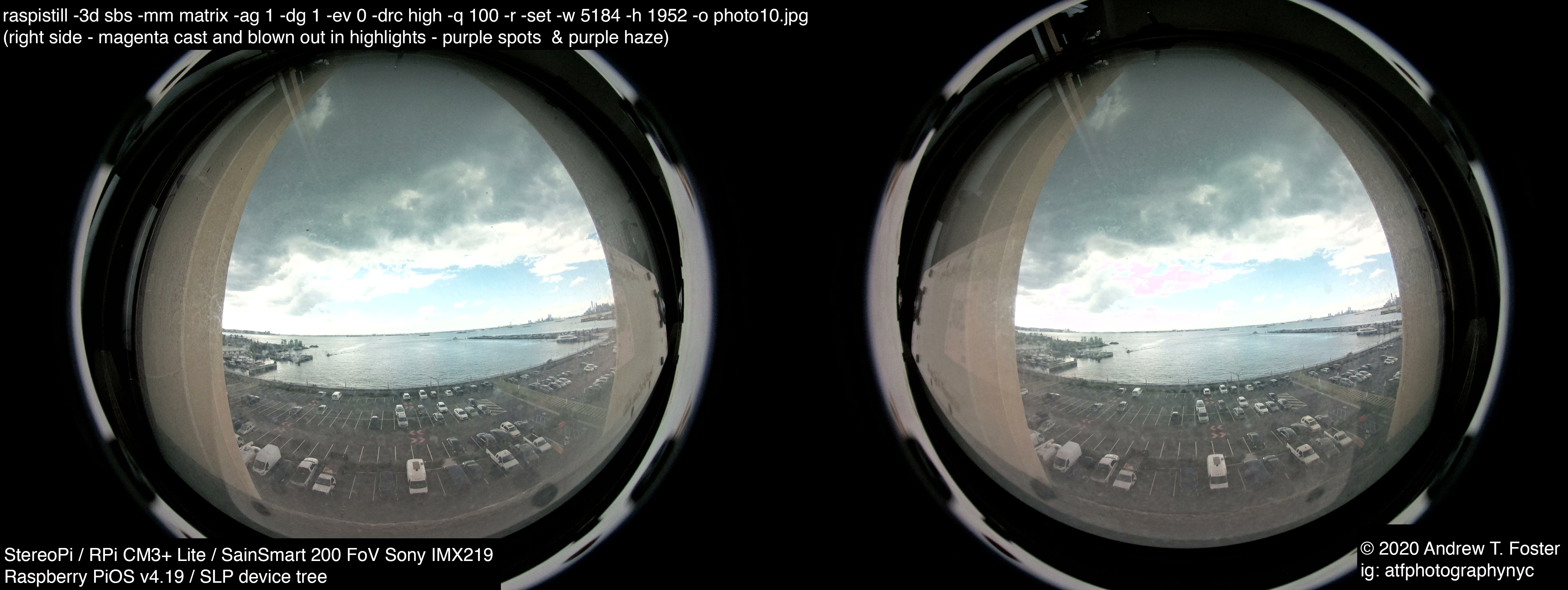

In the first frame, Magenta in the right image and purple spots or purple haze in the highlights.
Capture Command: raspistill -mm matrix -ag 1 -dg 1 -ev 0 -drc high -3d sbs -q 100 -r -set -w 1920 -h 1080 -o newsettings22.jpg

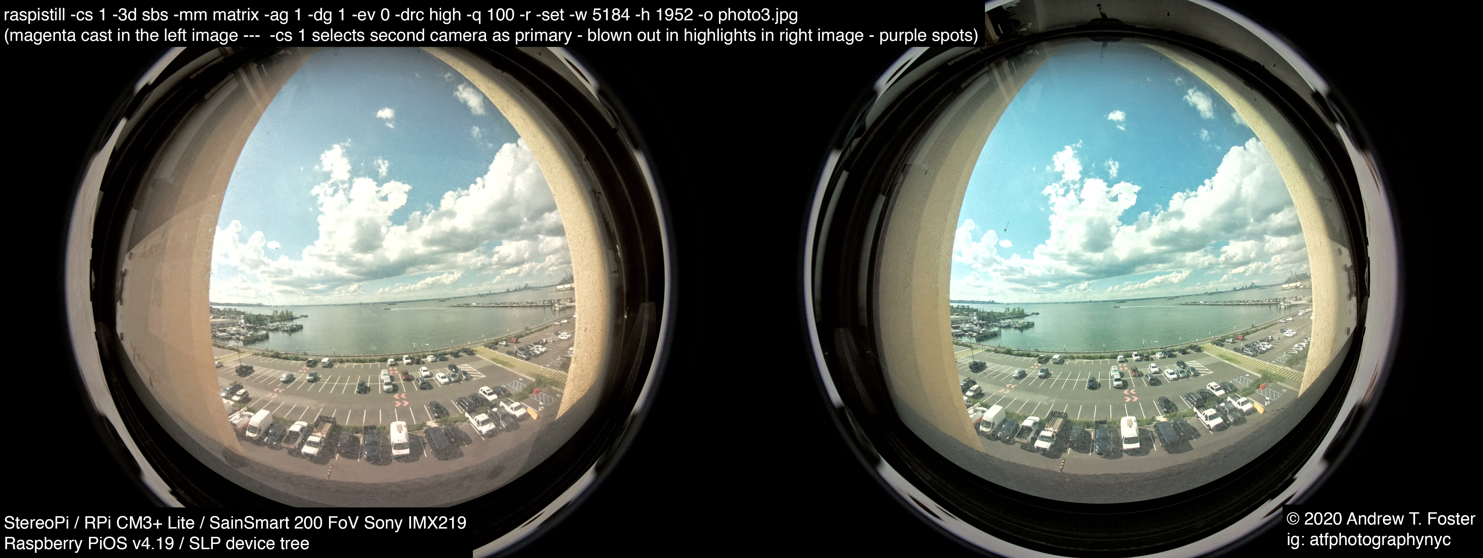

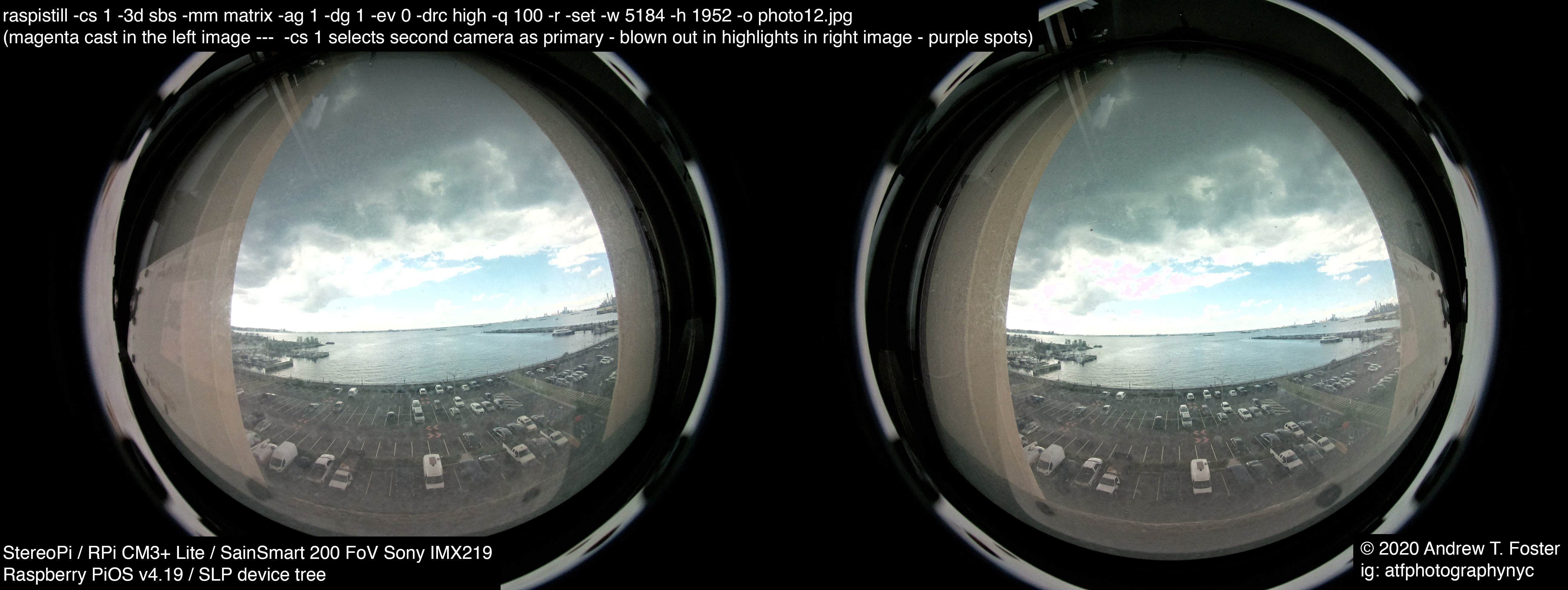

The second frame of the first test the magenta moved to the left, BUT the purple spots and haze in the highlights did not change.
Capture Command: raspistill -cs 1 -mm matrix -ag 1 -dg 1 -ev 0 -drc high -3d sbs -q 100 -r -set -w 1920 -h 1080 -o newsettings23.jpg
The next test first image shows a similar problem with the magenta but somehow the purple spots are barely visible:
Capture Command: raspistill -3d sbs -mm matrix -ag 1 -dg 1 -ev 0 -drc high -q 100 -r -set -w 5184 -h 1952 -o photo2.jpg

In this next test I tried some adjustments to the command line parameters for raspistill. By modifying the meter mode (-mm) and setting it to spot instead of matrix. The results were far better than any of the other images so far. The magenta was still in the right image, but it was much reduced.
Capture Command: raspistill -3d sbs -mm spot -ag 1 -dg 1 -ev 0 -drc high -q 100 -r -set -w 5184 -h 1952 -o photo8.jpg
The second frame of this test shows the magenta move to the left side, but no visible blow outs in the right.
raspistill -cs 1 -3d sbs -mm spot -ag 1 -dg 1 -ev 0 -drc high -q 100 -r -set -w 5184 -h 1952 -o photo9.jpg
In this next test I tried some adjustments to the command line parameters for raspistill and used -mm matrix for these two images. The magenta was heavy in the right image and the purple haze is pronounced in the highlights.
Capture Command: raspistill -3d sbs -mm matrix -ag 1 -dg 1 -ev 0 -drc high -q 100 -r -set -w 5184 -h 1952 -o photo10.jpg
The second frame of this test shows the magenta move to the left side, but the purple haze remains in the highlights on the right.
Capture Command: raspistill -cs 1 -3d sbs -mm matrix -ag 1 -dg 1 -ev 0 -drc high -q 100 -r -set -w 5184 -h 1952 -o photo11.jpg

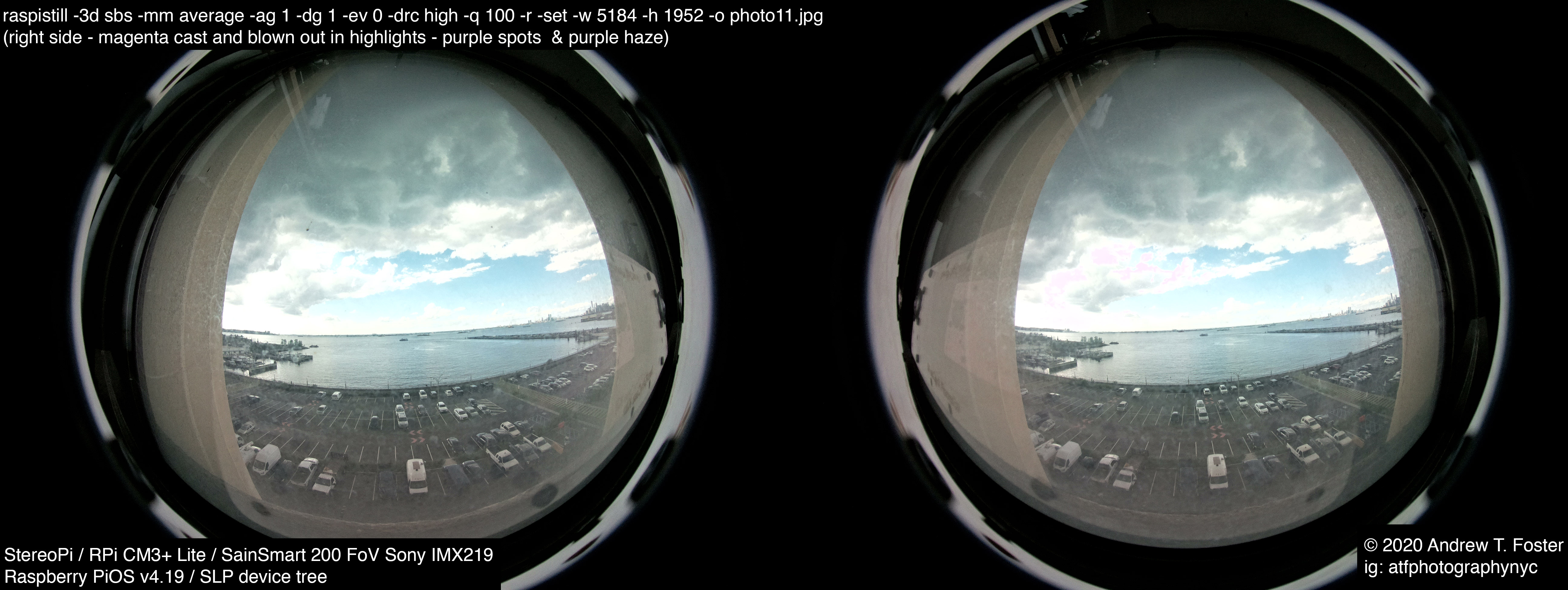

At this point, I decided to try another completely different set of the cameras. The images below all use the same model that I acquired of the SainSmart from the same vendor.
With the cameras swapped out, I noticed that the new set of cameras has far less of a magenta cast issue. It's still there but it's not as pronounced as the other camera set. I have _no_ idea why this true. In this test I tried some adjustments to the command line parameters for raspistill and used -mm average for these two images. The magenta was much lighter in the right image but the purple haze is still pronounced in the highlights.

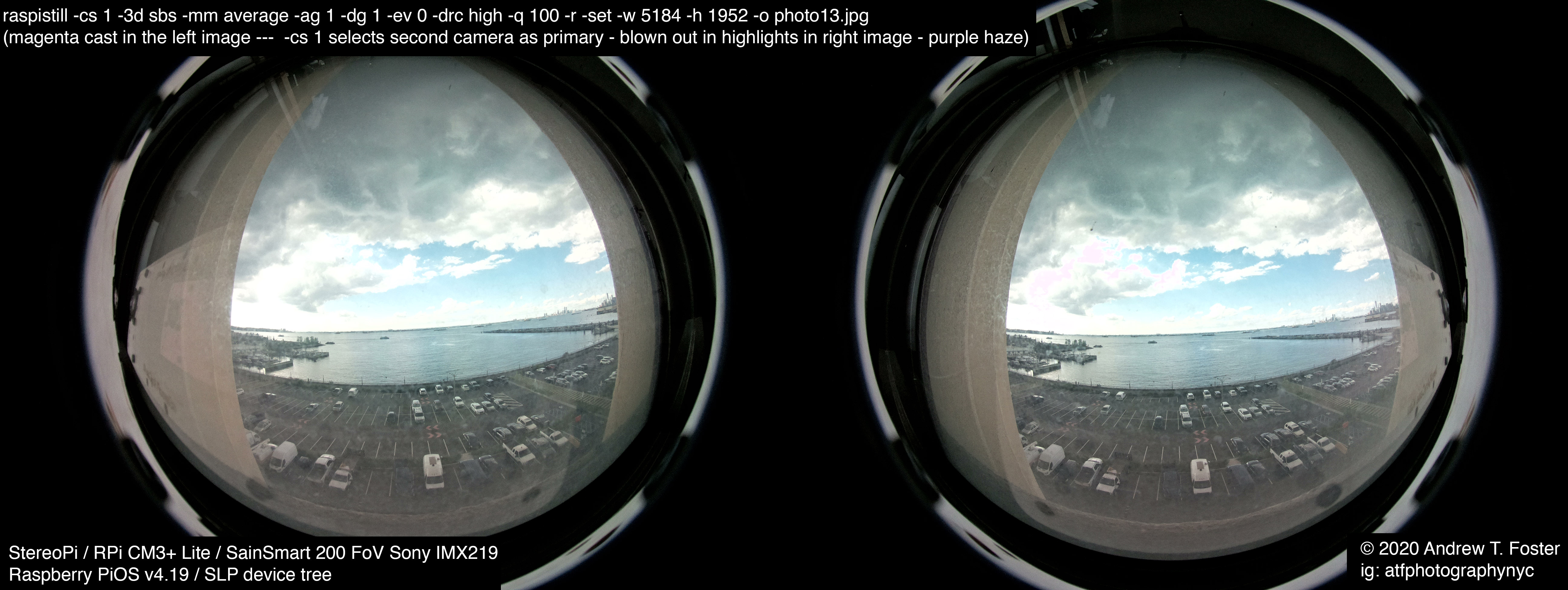

Capture Command: raspistill -3d sbs -mm average -ag 1 -dg 1 -ev 0 -drc high -q 100 -r -set -w 5184 -h 1952 -o photo12.jpg
Capture Command: raspistill -cs 1 -3d sbs -mm average -ag 1 -dg 1 -ev 0 -drc high -q 100 -r -set -w 5184 -h 1952 -o photo13.jpg

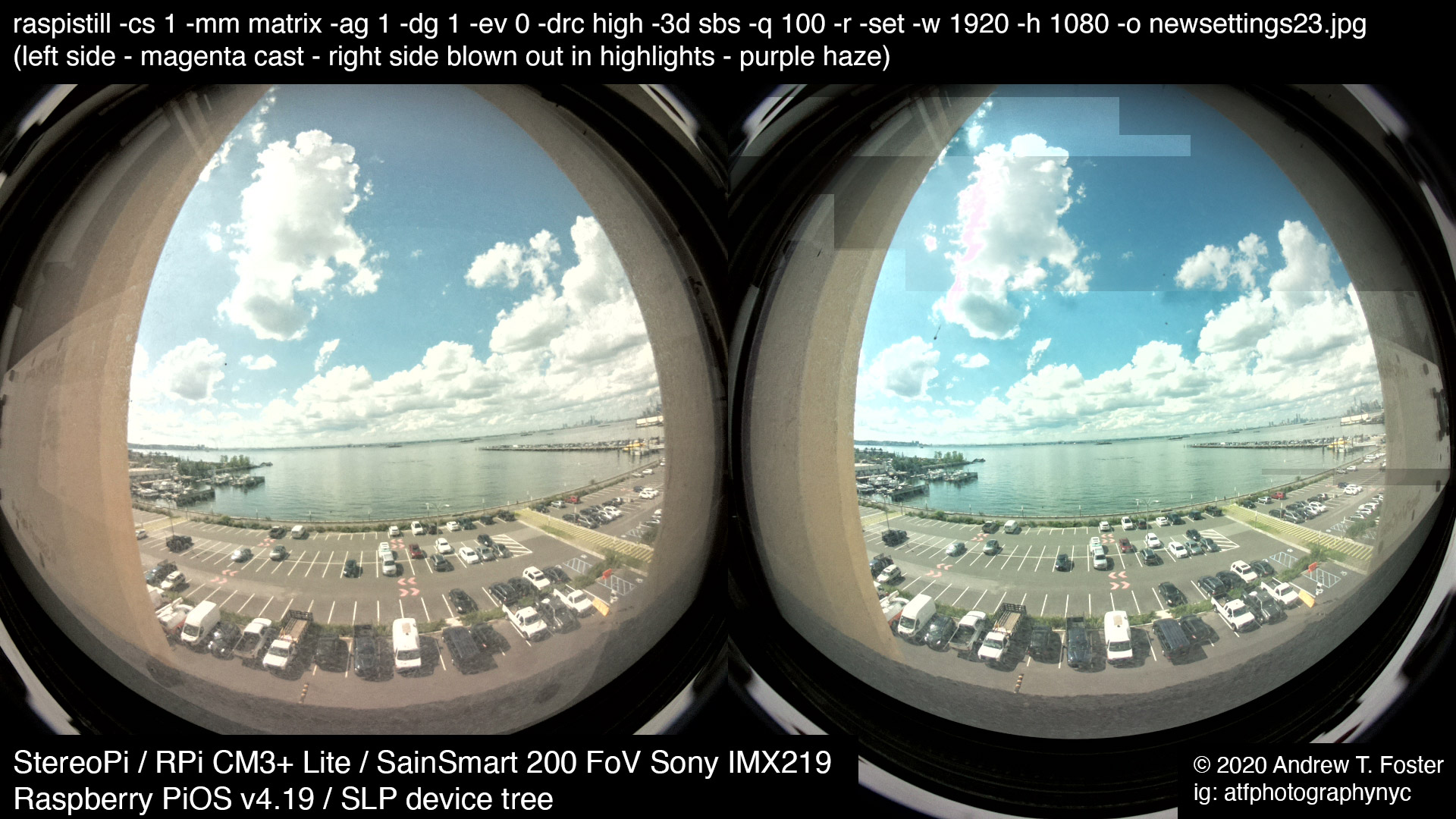

So it seems that there are two issues:
1. A magenta cast is covering the image in the camera that is receiving settings from the host camera.
2. In the right camera, the highlights are blown out and change to purple dots or a purple haze regardless of using the -cs (camera selection) command.

Posted: Fri Apr 09, 2021 6:25 pm
Aftphoto, thank you for your tests!
Could you please do the last test - check the same thing using the latest stock Raspbian and our dt-blob.bin?
In my own experience, this effect appears only in some special conditions. Like image should have both extremely dark areas (corners on the fisheye photos) and extremely light (sun or sky). I'll ask RPF again to fix this.
