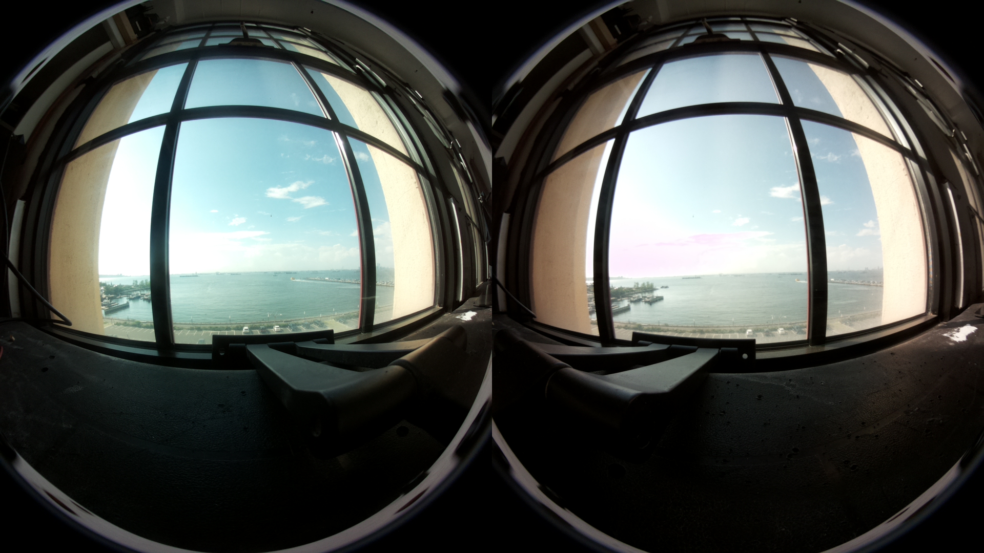

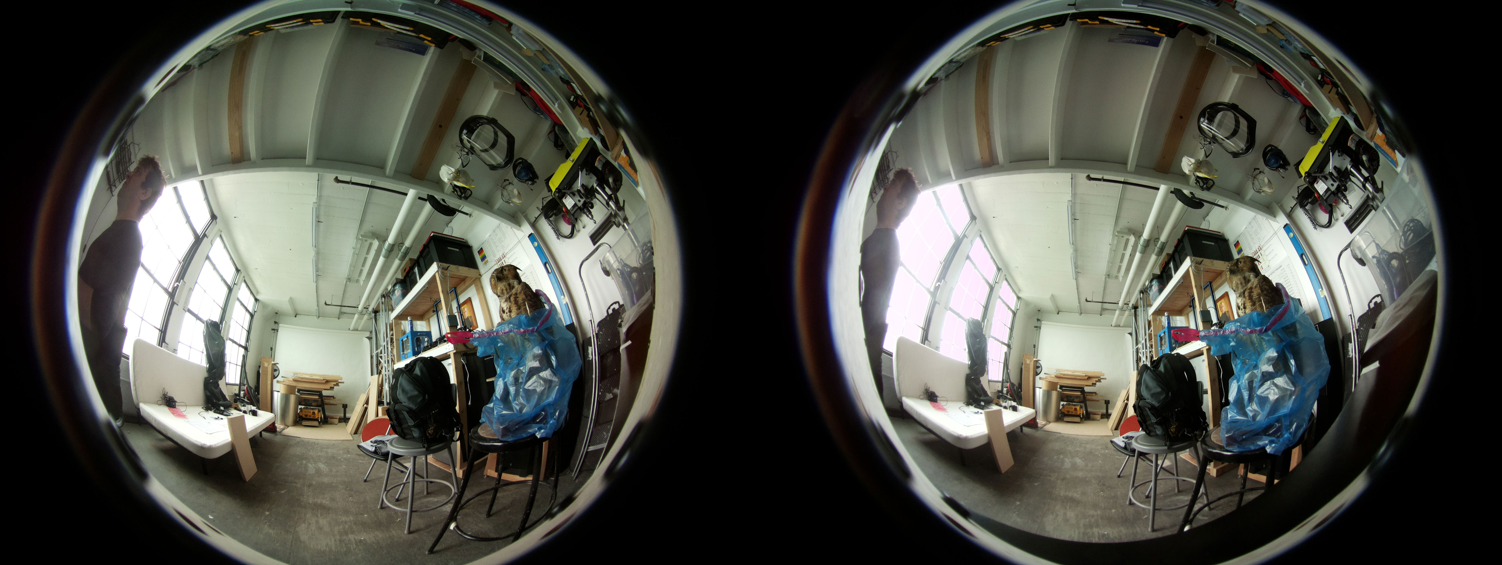

I'm having an issues with my StereoPi that I acquired a few months ago. I finally got around to setting things up and I'm getting a strange problem with one of the camera inputs.
My setup;
StereoPi
CMS3+ lite
SD Card
SLP Install
On the right side camera input (if looking out like the camera perspective), the right side camera is displaying red or magenta in areas of high brightness. To make sure it wasn't a cable or camera issue, I've tried all different cables (and lengths) and cameras from Waveshare and the official Raspberry Pi 2.0 camera. The right side camera port also seems to be slightly more blurry on all three of the cameras.
Is this something that I can adjust in software or is something defective and the board needs to be exchanged?
Thanks for any help!

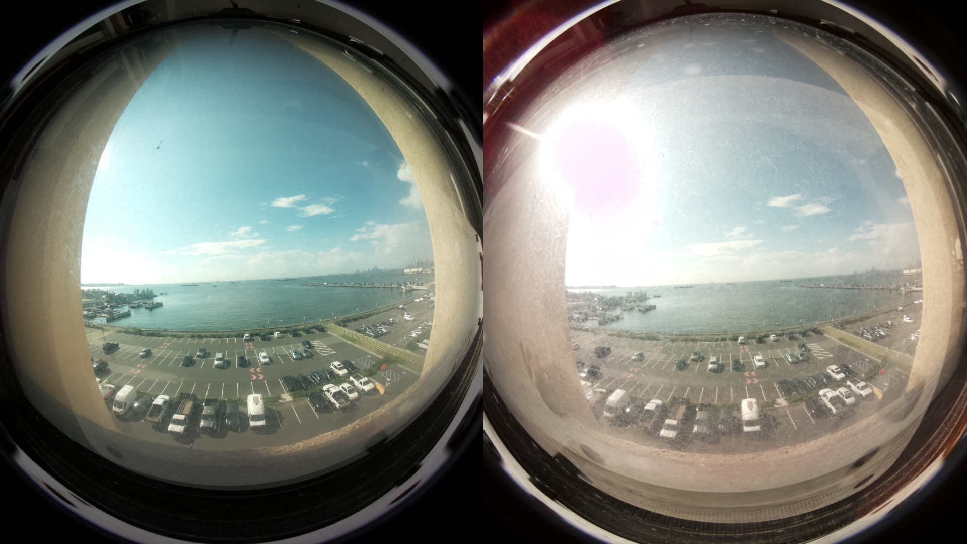

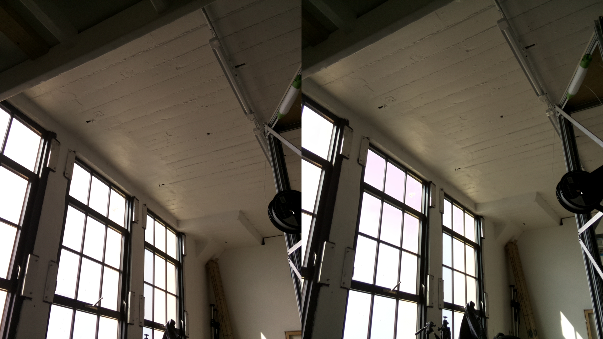

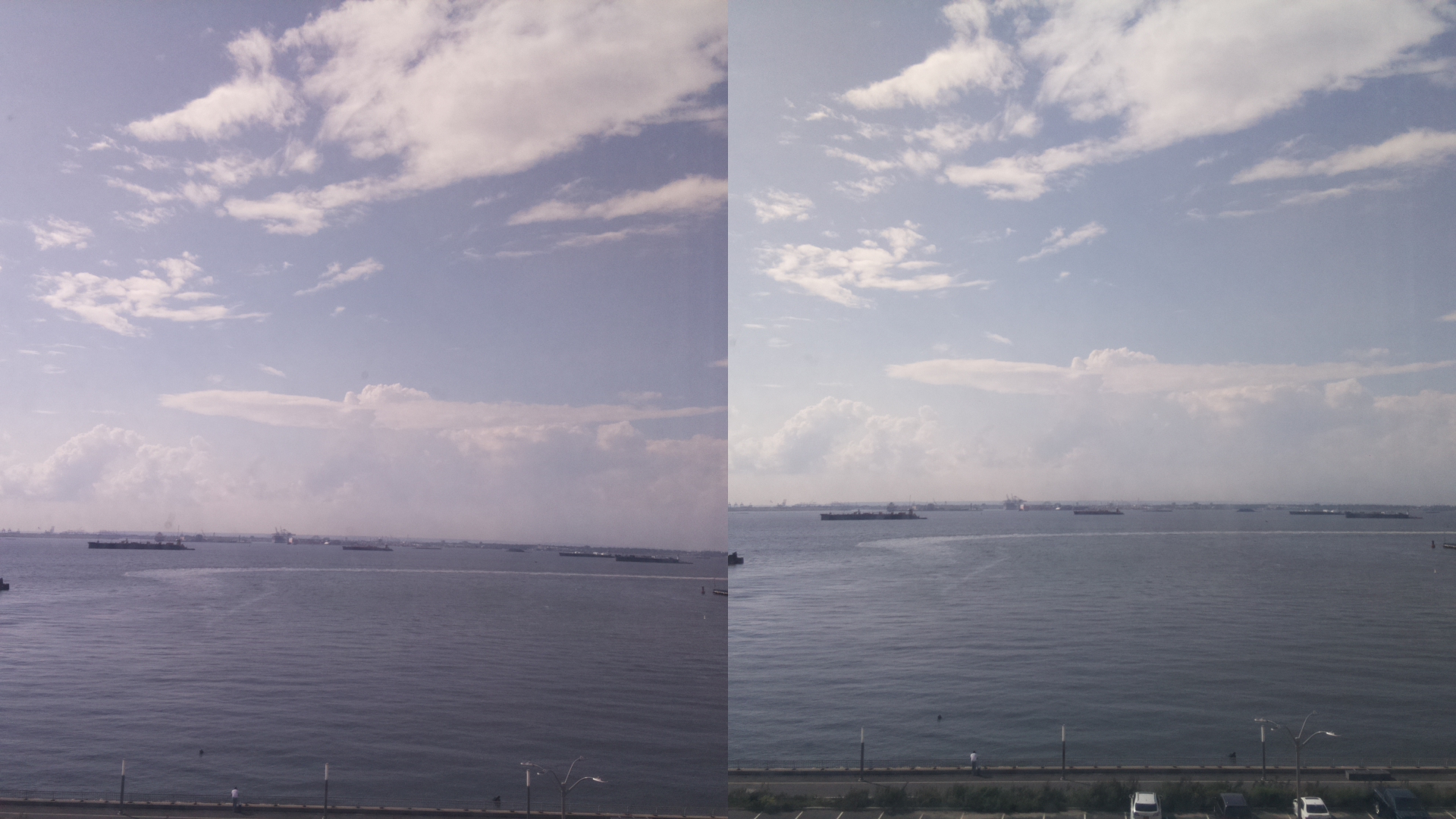

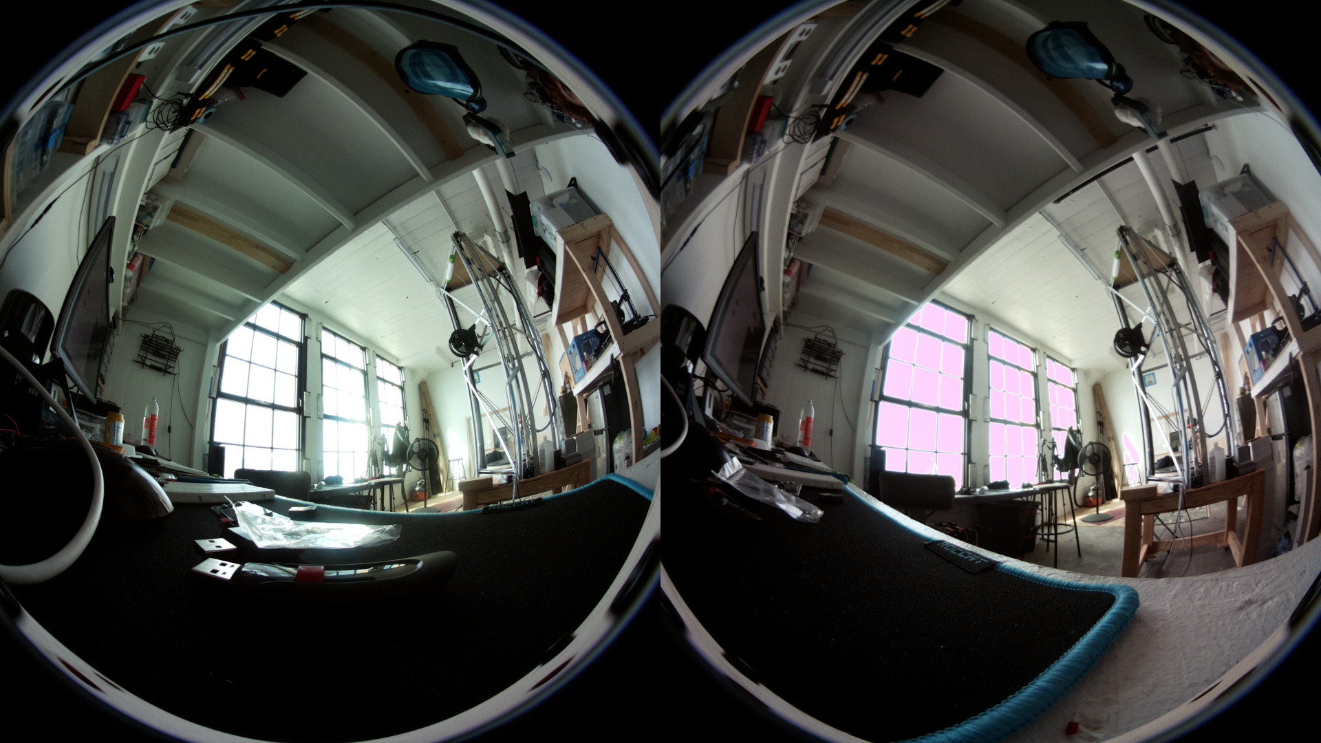

I had a chance today to load up the Raspberry Pi OS (minimal), installed all updates, etc. and gave it a few tests.
Unfortunately this didn't solve the issue with the SainSmart 200 degree FOV cameras _or_ the official Raspberry Pi v2.1 cameras.
After I installed the new version of the OS and got everything updated, I ran the test you mentioned below:
The first result showed the same effect as before using the SainSmart cameras:
SainSmart Cameras 200 Degree FOV with Raspberry Pi OS:
Out of curiosity, I moved the cameras closer to the window to see what it would do with the change in dynamic range.
Close to window:
Away from window:
Against window:

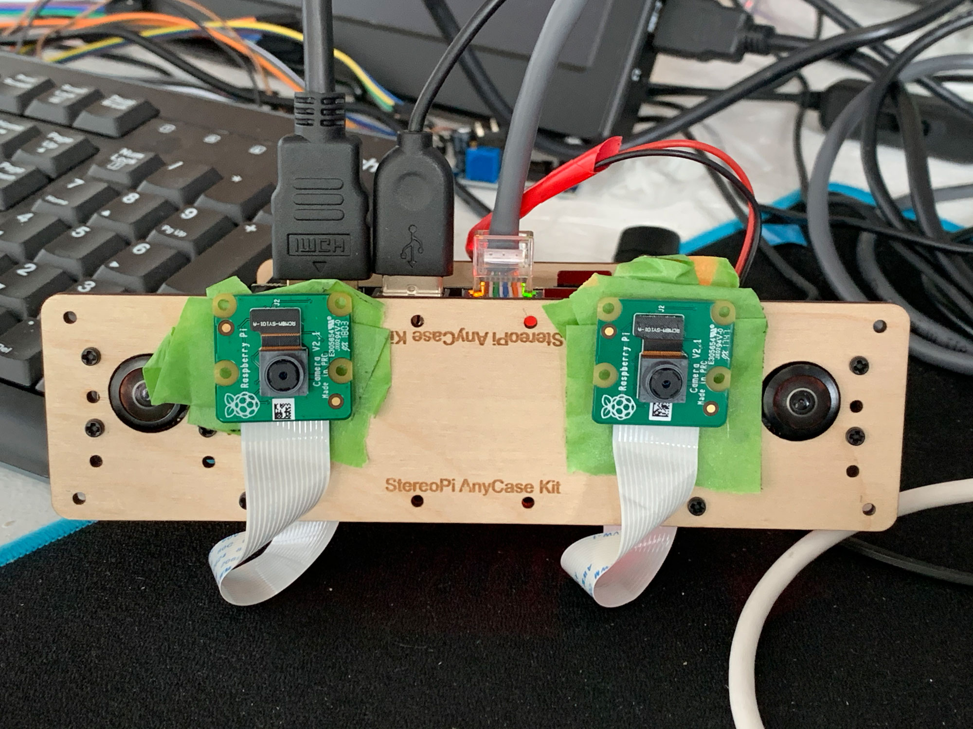

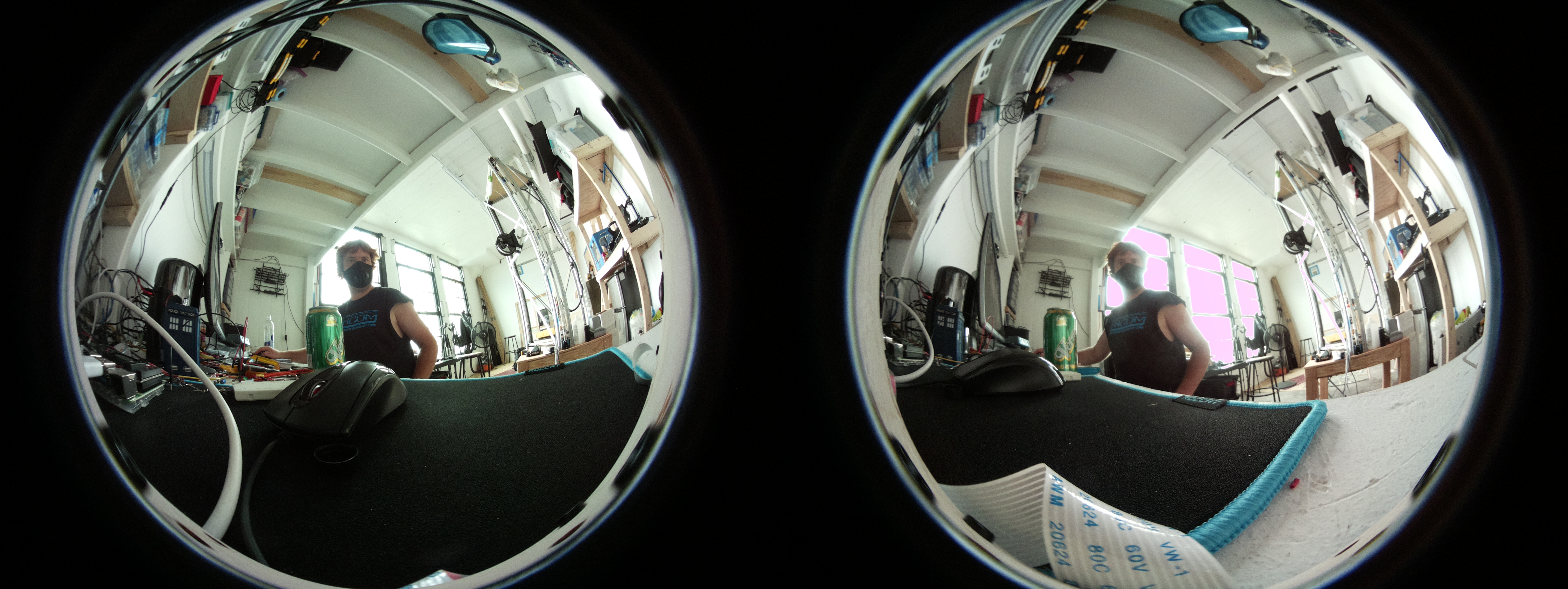

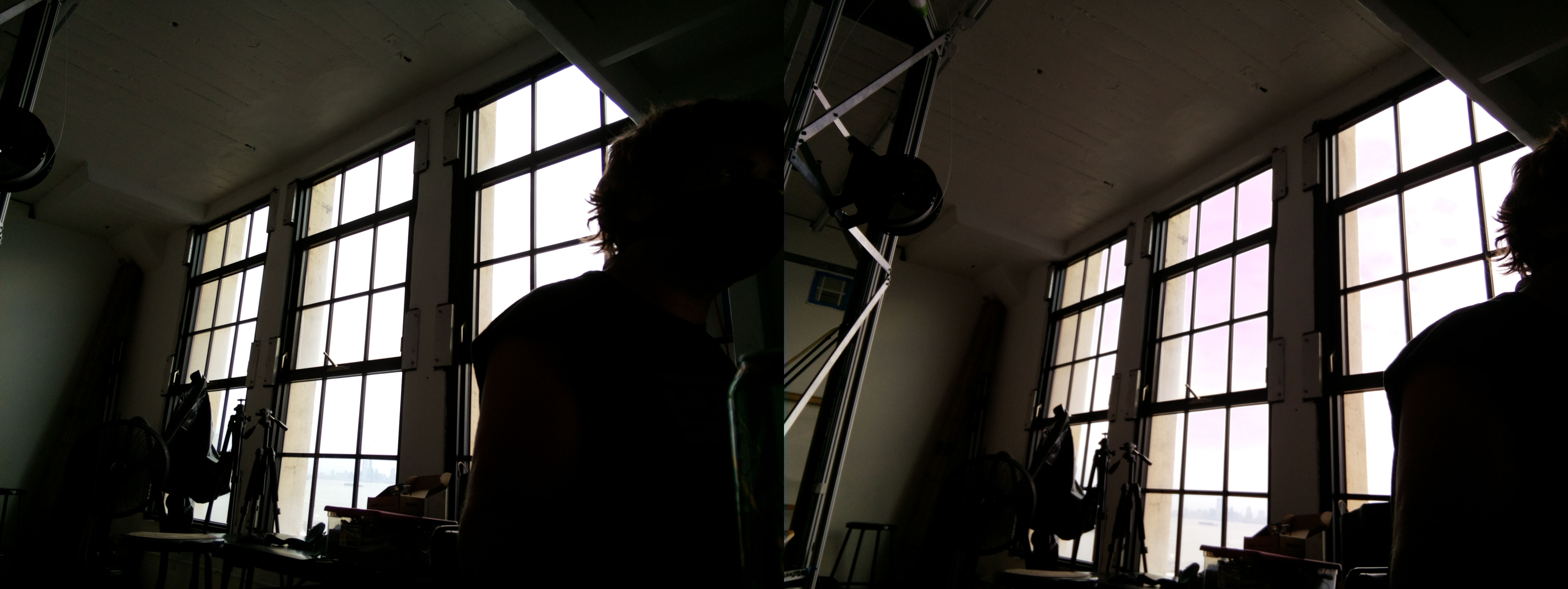

At this point I decided to try the official Raspberry Pi v2.1 cameras with the Raspberry Pi OS and got some strange results. In the first image, it seemed fine but then I noticed some magenta but this time it's in left camera.
Raspberry Pi v2.1 cameras w/ Raspberry Pi OS:
On the second test, I changed the perspective and white balanced with a quick flash of my hand. You can definitely see the magenta back in the right camera, similar to the SainSmart camera.
On the third test, I placed it up against the window and the results are quite a bit different between the two cameras. Any thoughts?
Oh and sorry about the Pi cameras not being quite level. Ha!
Thanks!
A
(Another from the window with the SainSmart 200 degree)

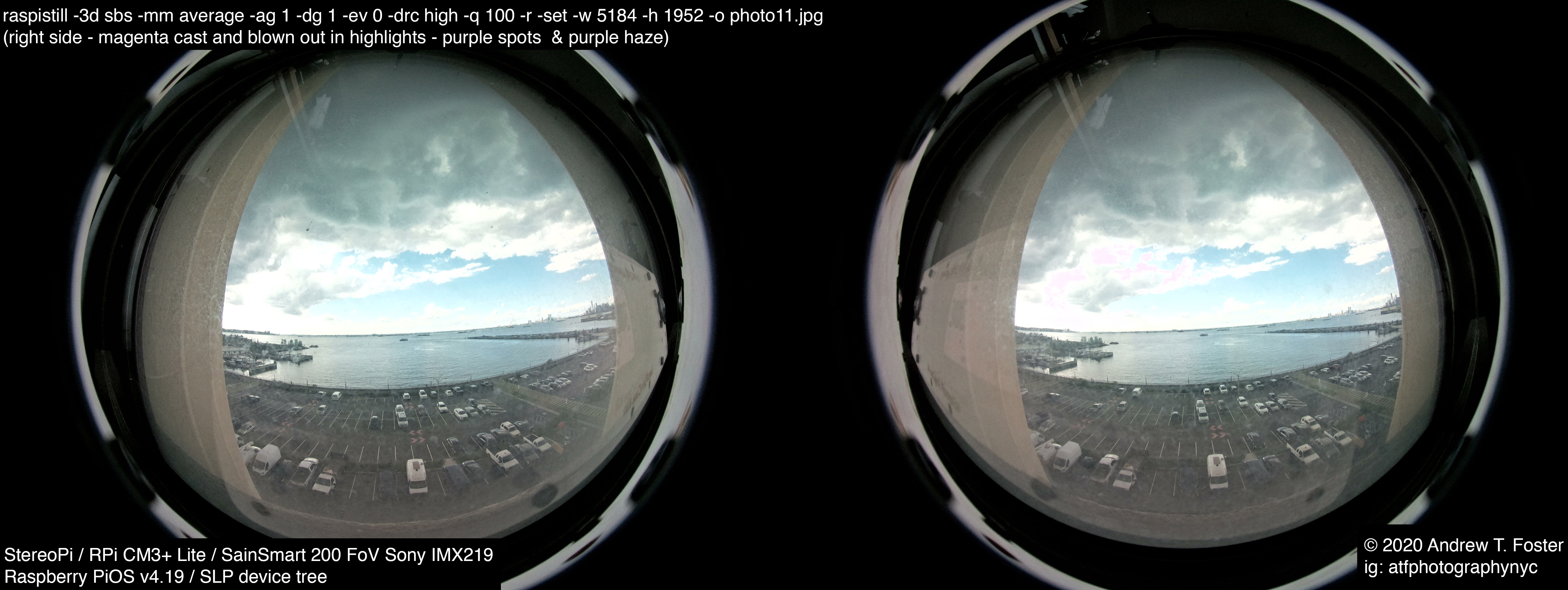

I ran a few tests yesterday as requested. Let me show you the results for the camera switch request;
"To confirm this hypothesis, can you please do one more test, and do a software switch of the cameras. To do this, add the "-cs 1" option to your capturing code. I.e. for your "raspistill -3d sbs -w 1920 -h 1080 -o newtest.jpg" try to run "raspistill -cs 1 -3d sbs -w 1920 -h 1080 -o newtest.jpg"
In this case, your magenta color effect should "jump" to another camera."
The same setup as before for the first set;
StereoPi
SainSmart 200 degree FoV - SONY IMX219 - CMOS 1/4 Inch - 3280x2464 - Focal length 0.87mm - Aperture (F):2
CMS3+ lite
SD Card
Raspberry Pi OS 4.17 with the device tree blob

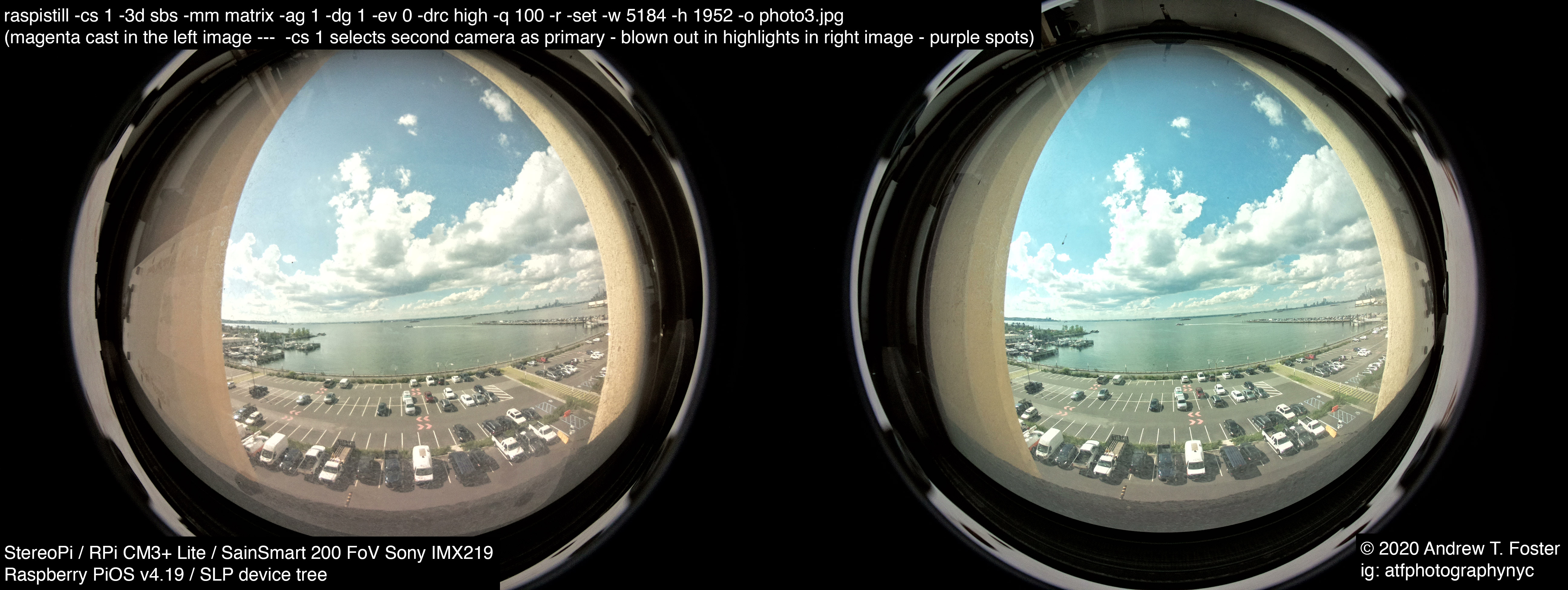

The first test showed similar results.

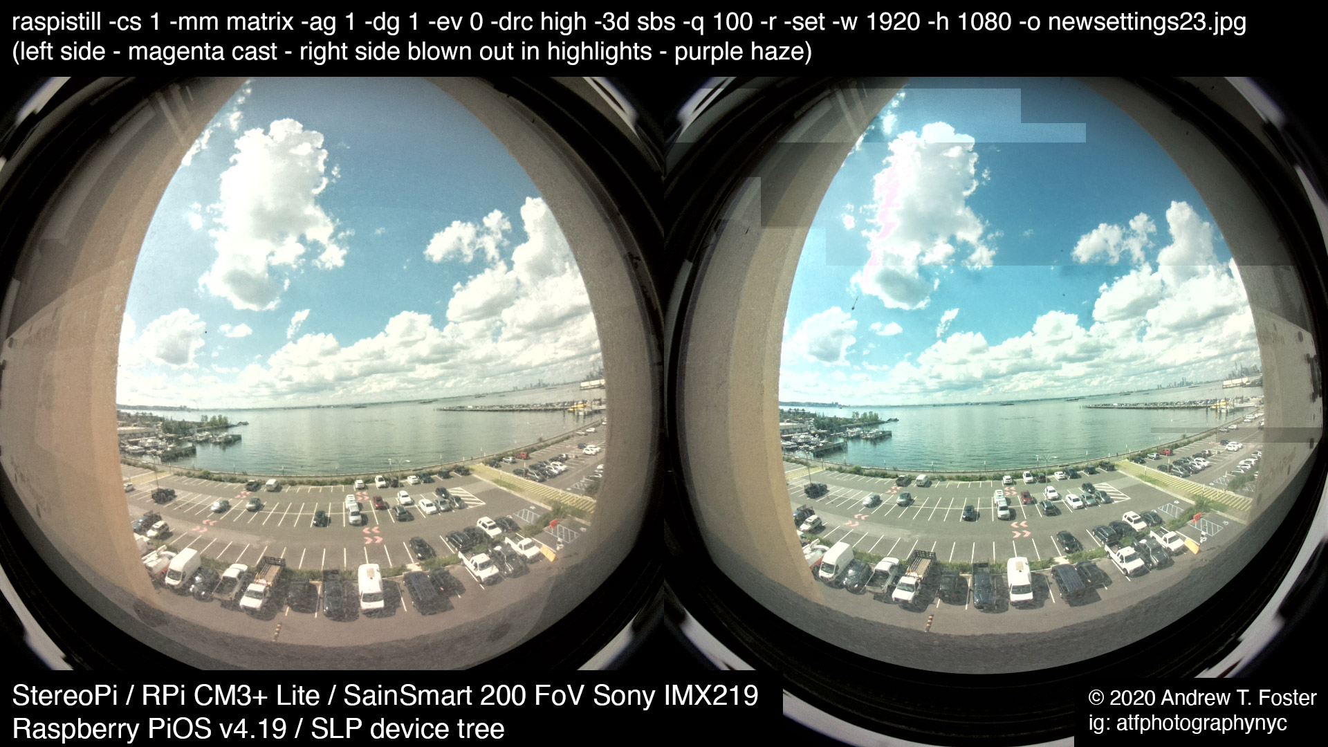

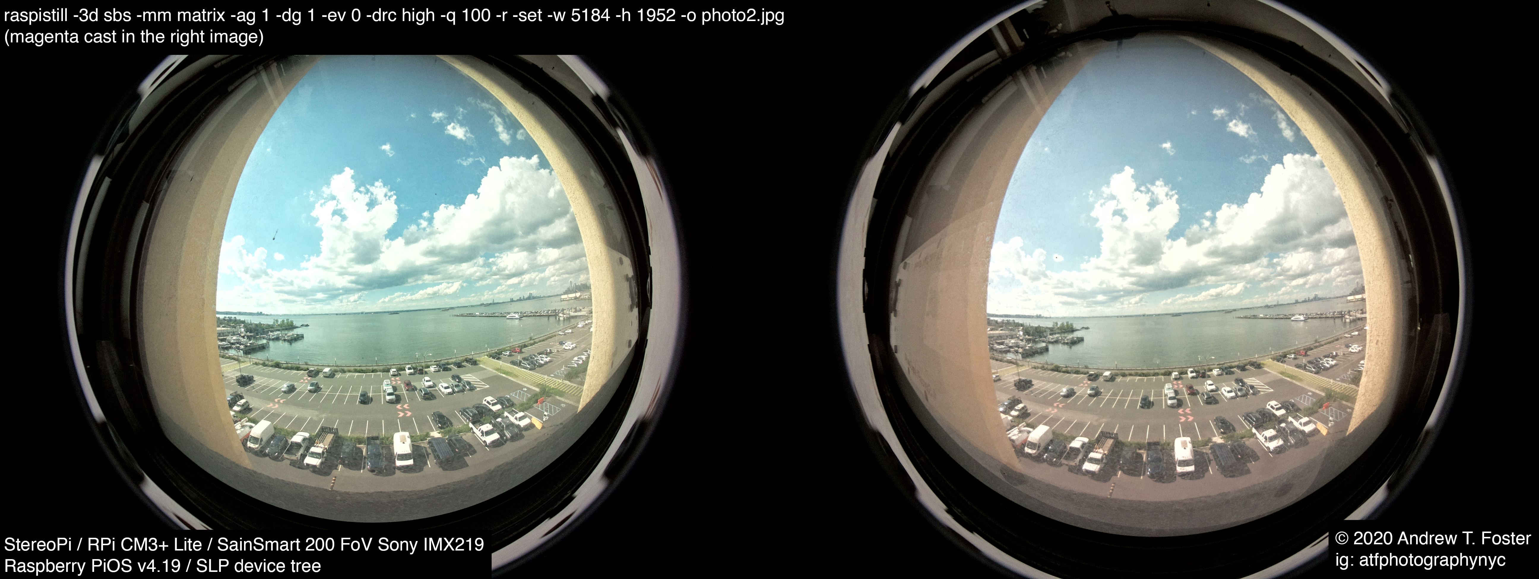

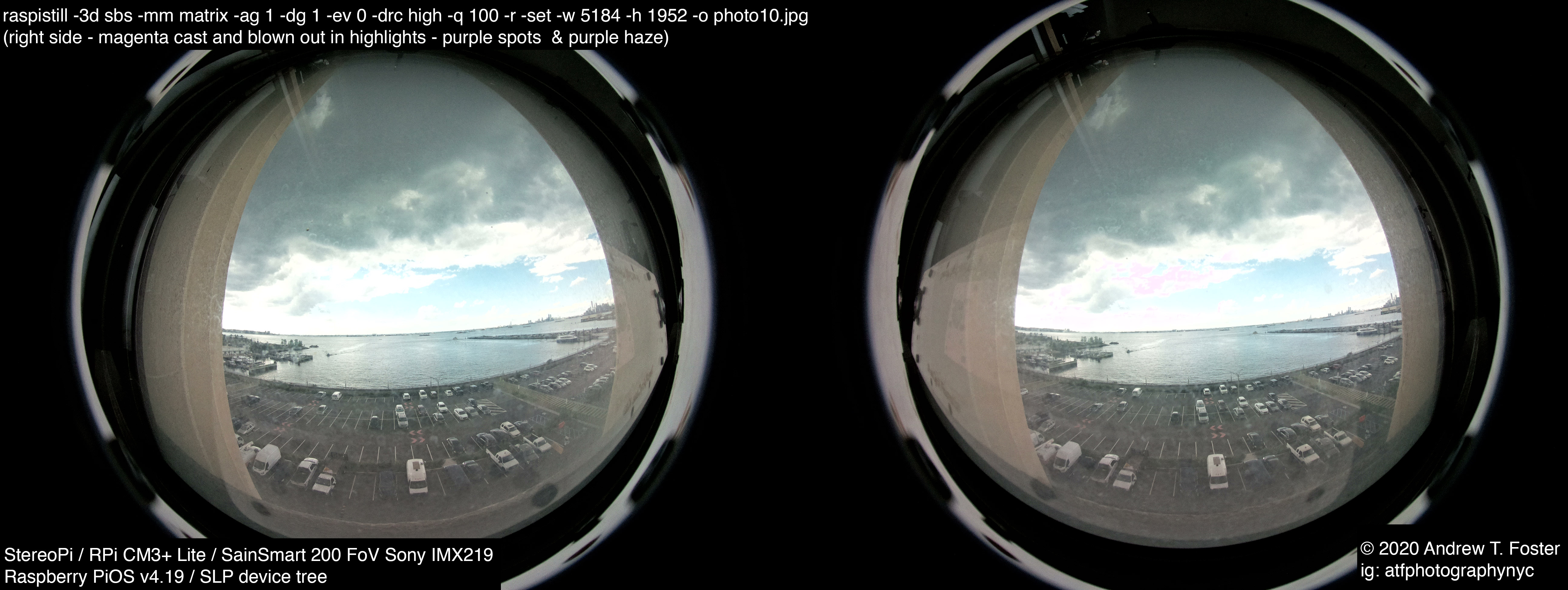

In the first frame, Magenta in the right image and purple spots or purple haze in the highlights.
Capture Command: raspistill -mm matrix -ag 1 -dg 1 -ev 0 -drc high -3d sbs -q 100 -r -set -w 1920 -h 1080 -o newsettings22.jpg
The second frame of the first test the magenta moved to the left, BUT the purple spots and haze in the highlights did not change.
Capture Command: raspistill -cs 1 -mm matrix -ag 1 -dg 1 -ev 0 -drc high -3d sbs -q 100 -r -set -w 1920 -h 1080 -o newsettings23.jpg

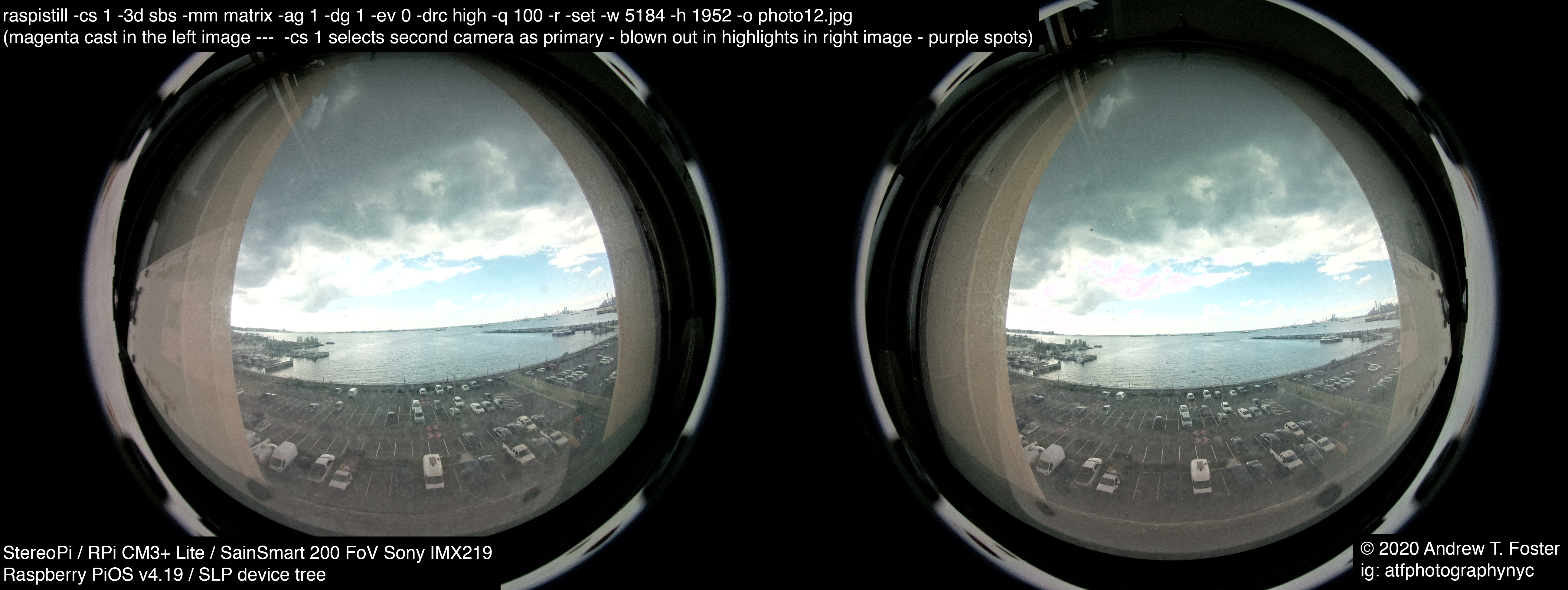

The next test first image shows a similar problem with the magenta but somehow the purple spots are barely visible:
Capture Command: raspistill -3d sbs -mm matrix -ag 1 -dg 1 -ev 0 -drc high -q 100 -r -set -w 5184 -h 1952 -o photo2.jpg
The second frame shows the magenta has moved to the left. No change in barely visible spots on right.
Capture Command: raspistill -cs 1 -3d sbs -mm matrix -ag 1 -dg 1 -ev 0 -drc high -q 100 -r -set -w 5184 -h 1952 -o photo3.jpg

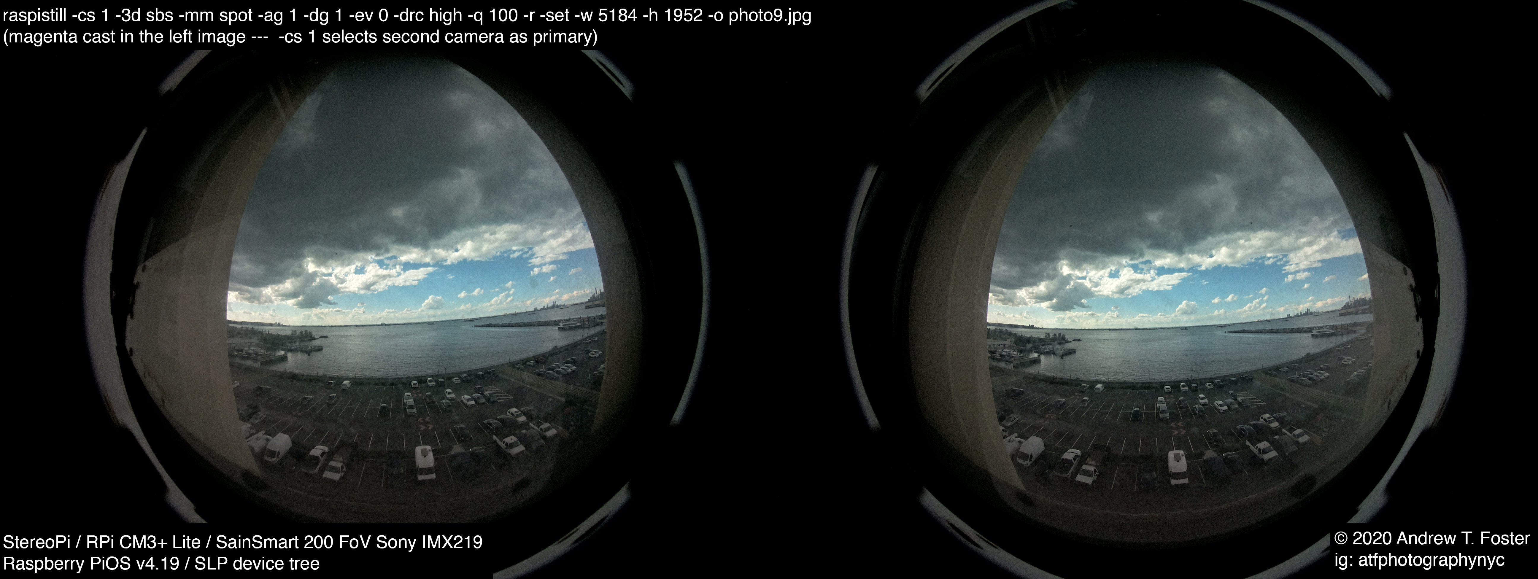

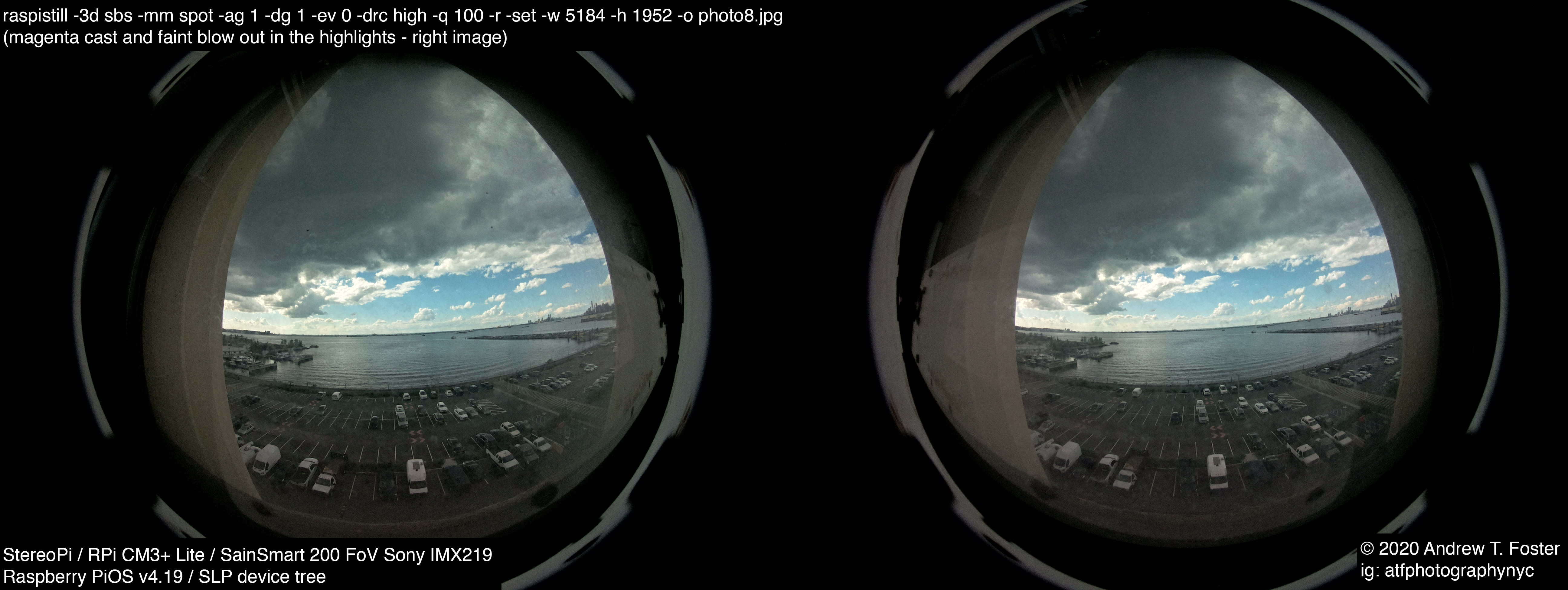

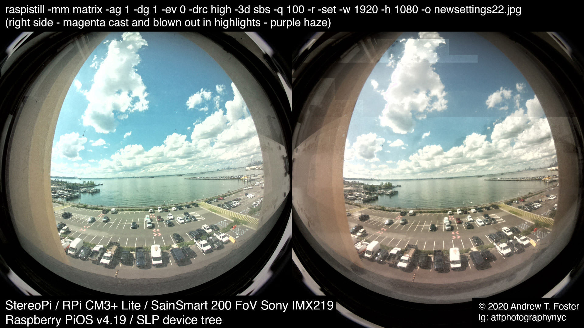

In this next test I tried some adjustments to the command line parameters for raspistill. By modifying the meter mode (-mm) and setting it to spot instead of matrix. The results were far better than any of the other images so far. The magenta was still in the right image, but it was much reduced.
Capture Command: raspistill -3d sbs -mm spot -ag 1 -dg 1 -ev 0 -drc high -q 100 -r -set -w 5184 -h 1952 -o photo8.jpg
The second frame of this test shows the magenta move to the left side, but no visible blow outs in the right.
raspistill -cs 1 -3d sbs -mm spot -ag 1 -dg 1 -ev 0 -drc high -q 100 -r -set -w 5184 -h 1952 -o photo9.jpg
In this next test I tried some adjustments to the command line parameters for raspistill and used -mm matrix for these two images. The magenta was heavy in the right image and the purple haze is pronounced in the highlights.
Capture Command: raspistill -3d sbs -mm matrix -ag 1 -dg 1 -ev 0 -drc high -q 100 -r -set -w 5184 -h 1952 -o photo10.jpg
The second frame of this test shows the magenta move to the left side, but the purple haze remains in the highlights on the right.
Capture Command: raspistill -cs 1 -3d sbs -mm matrix -ag 1 -dg 1 -ev 0 -drc high -q 100 -r -set -w 5184 -h 1952 -o photo11.jpg

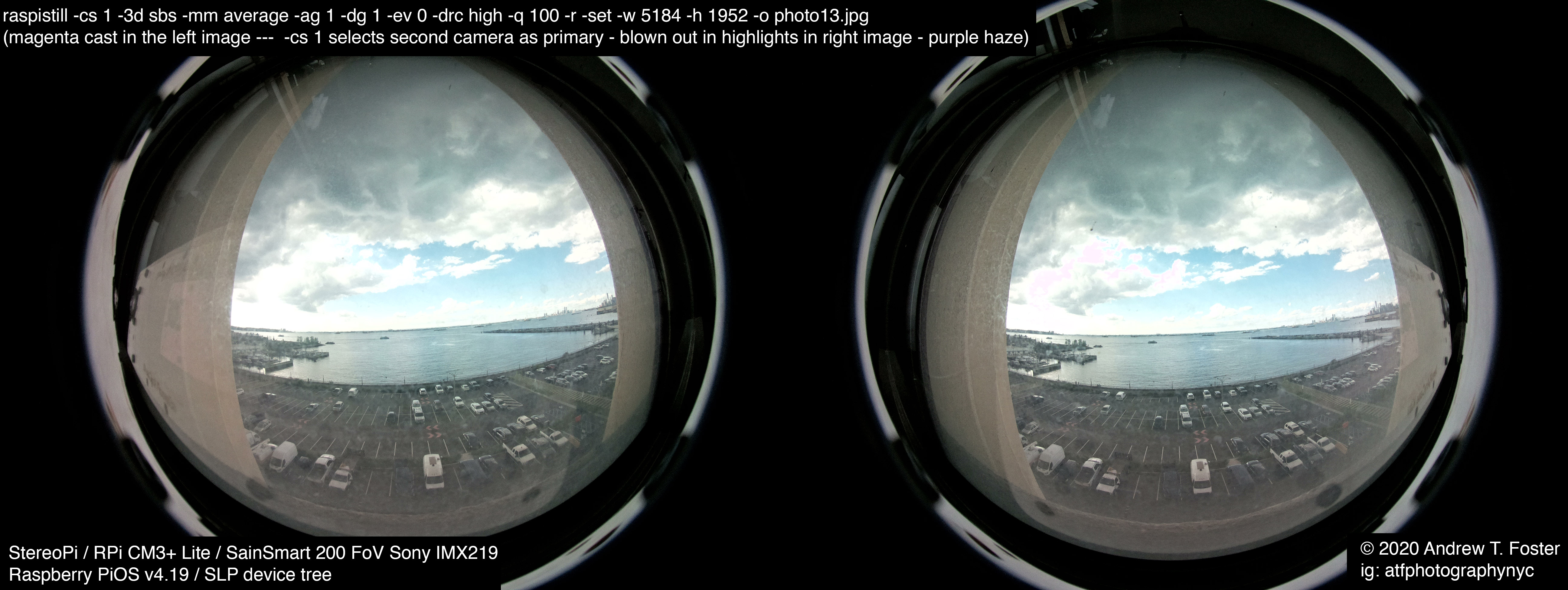

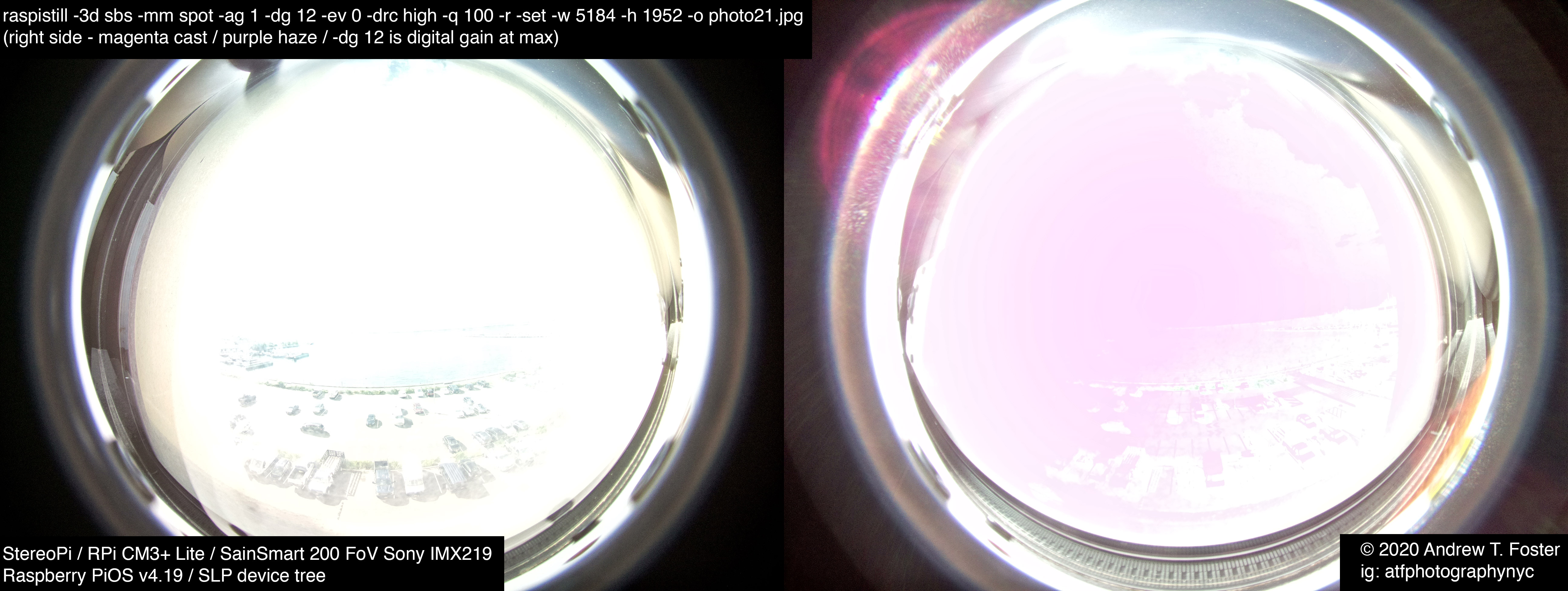

At this point, I decided to try another completely different set of the cameras. The images below all use the same model that I acquired of the SainSmart from the same vendor.
With the cameras swapped out, I noticed that the new set of cameras has far less of a magenta cast issue. It's still there but it's not as pronounced as the other camera set. I have _no_ idea why this true. In this test I tried some adjustments to the command line parameters for raspistill and used -mm average for these two images. The magenta was much lighter in the right image but the purple haze is still pronounced in the highlights.
Capture Command: raspistill -3d sbs -mm average -ag 1 -dg 1 -ev 0 -drc high -q 100 -r -set -w 5184 -h 1952 -o photo12.jpg
Capture Command: raspistill -cs 1 -3d sbs -mm average -ag 1 -dg 1 -ev 0 -drc high -q 100 -r -set -w 5184 -h 1952 -o photo13.jpg
So it seems that there are two issues:
1. A magenta cast is covering the image in the camera that is receiving settings from the host camera.
2. In the right camera, the highlights are blown out and change to purple dots or a purple haze regardless of using the -cs (camera selection) command.
StereoPi
CMS3+ lite
SD Card
Hope this helps and I labeled everything correctly.

One more image. This image was a test when I was playing around with the parameters for the analog and digital gain.
I had cranked the digital gain up all the way to see what the effect was on the image.
raspistill -3d sbs -mm spot -ag 1 -dg 12 -ev 0 -drc high -q 100 -r -set -w 5184 -h 1952 -o photo21.jpg
You can really see the magenta in the image on the right.
Thanks!
Thanks!

Had change to pull the stereopi back out today and gave the command a try to switch back to the old AWB.
Unfortunately, no change in the image in regards to the magenta cast in the second image.
Is this something that also affects the new StereoPi? How is anyone using the StereoPi with the magenta casts?
Anyhow.. back in the drawer it goes for now.
Here are the commands I used for capturing and the two results.
sudo vcdbg set awb_mode 0
sudo vcdbg set awb_mode 1
raspistill -3d sbs -mm average -ex auto -q 100 -r -set -w 5184 -h 1952 -o AWB_0.jpg
raspistill -3d sbs -mm average -ex auto -q 100 -r -set -w 5184 -h 1952 -o AWB_1.jpg
