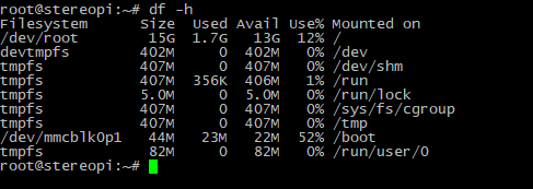

Secondly, i tried df -h and found out the partition table:

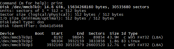

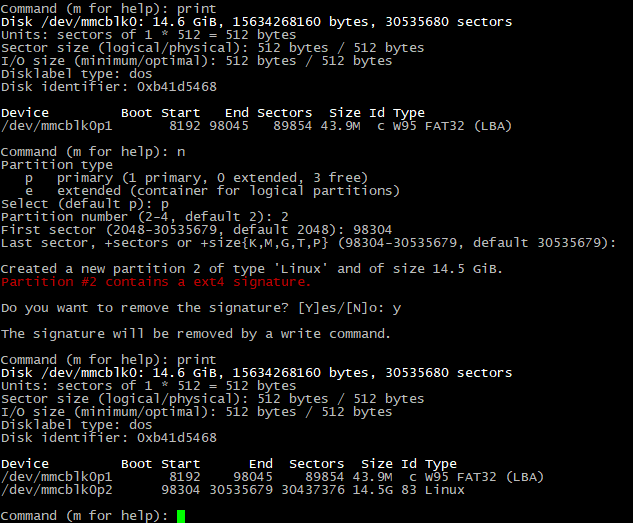

And tried to resize following the man here - https://raspberrypi.stackexchange.com/q ... -partition
But after delete partitions and reboot - stereopi went to endless reboot ((

On a Linux desktop with sd card reader, I used gparted with success. If you change the partition table with fdisk, you say where to search for new data but without moving the data themselves, hence the inability to boot.

fdisk is a low level utility that modifies the partition table. You can work on such low level, but with extra caution and by knowing how the system works.
The step-by-step tutorial on your link (that I did not see at first read) is okay-ish, except that it destroys all partitions after the second one, which is not really a problem in the context of the question (a swap partition is somewhat optional). But this flaw is problematic with SLP because, as said by realizator, it tries to recreate a FAT partition at boot if it does not exist, but at a position which is not compatible with your new mapping.
You can probably resize with similar method at low level, but you should add a FAT partition (and perhaps format it, I do not remember exactly) to avoid the related script to trigger.

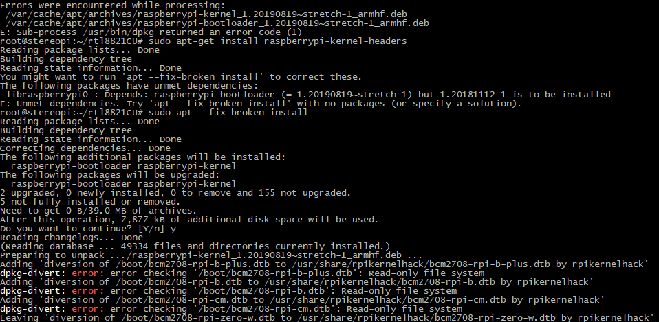

Trying to install sudo apt install raspberrypi-bootloader raspberrypi-kernel leads me to errors: read-only filesystem o_O
But i`ve already remount the filesytem as rw!

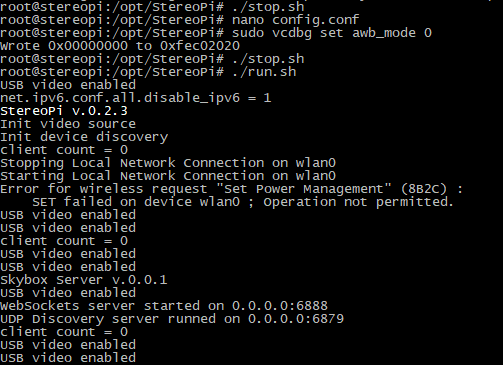

Tried to start script run.sh in /opt/Stereopi but it gives back:
May be something in config.conf should be change or in run.sh ?

Zoldaten, apt-get upgrade is a bad thing, as I mentioned :-)
At least you can see the error stage - "Starting local network connection on Wlan0". Try to look in run.sh and find the workflow we use.
Some tips:
In run.sh we are starting wlan manager:
./scripts/wlan-switch.php &
this file includes "wlan.lib.php"
"wlan.lib.php" has LAN_stop and LAN_run functions.
Looks like your "Set power management" caused by row 164, i.e.:
shell_exec("sudo iwconfig $iface power off");
Also please take a look at row 178:
shell_exec('sudo wpa_supplicant -B -i ' . $iface . ' -D nl80211,wext -c /run/' . $iface . '.conf');
If you have updated driver, may be you need to put it here.
