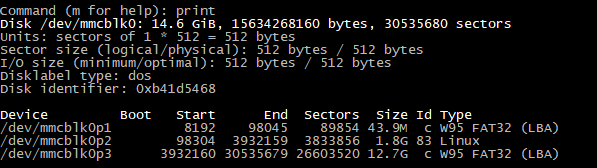

Secondly, i tried df -h and found out the partition table:

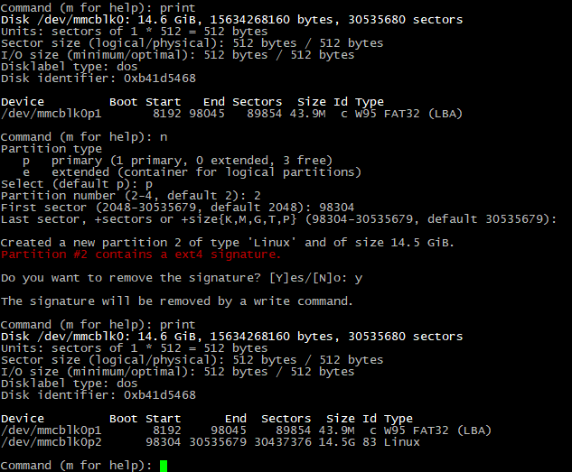

And tried to resize following the man here - https://raspberrypi.stackexchange.com/q ... -partition
But after delete partitions and reboot - stereopi went to endless reboot ((

On a Linux desktop with sd card reader, I used gparted with success. If you change the partition table with fdisk, you say where to search for new data but without moving the data themselves, hence the inability to boot.

fdisk is a low level utility that modifies the partition table. You can work on such low level, but with extra caution and by knowing how the system works.
The step-by-step tutorial on your link (that I did not see at first read) is okay-ish, except that it destroys all partitions after the second one, which is not really a problem in the context of the question (a swap partition is somewhat optional). But this flaw is problematic with SLP because, as said by realizator, it tries to recreate a FAT partition at boot if it does not exist, but at a position which is not compatible with your new mapping.
You can probably resize with similar method at low level, but you should add a FAT partition (and perhaps format it, I do not remember exactly) to avoid the related script to trigger.
Alternatively on a desktop, you can use gparted (on a native Linux installation or with a liveUSB/liveCD) which is designed to resize partitions and handles various situations linked to this task. There still exist situations not suitable for it because they rely on partitions not being resized, but otherwise it is a great tool. Concerning SLP, the gparted method works because the requirement is the FAT partition to exist, which gparted keeps (and actually moves with content) if you do not ask it to remove.

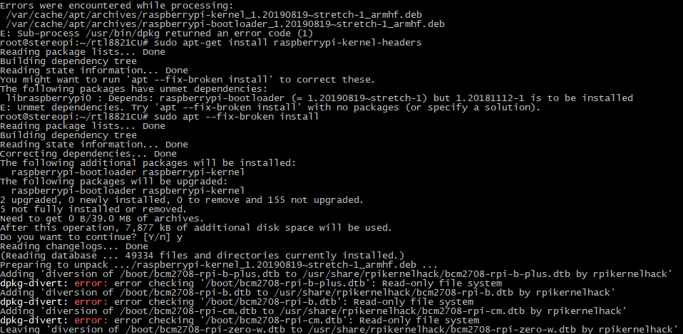

Trying to install sudo apt install raspberrypi-bootloader raspberrypi-kernel leads me to errors: read-only filesystem o_O
But i`ve already remount the filesytem as rw!
Why i go this way ? Because i went that way when install drivers for my usb dongle on openCV image that worked (see my comment https://github.com/gnab/rtl8812au/issues/147)
upd.
i remounted /boot with sudo mount -o rw,remount /boot and successfully updated bootloader and kernel but...
stereopi again starts boot endless...

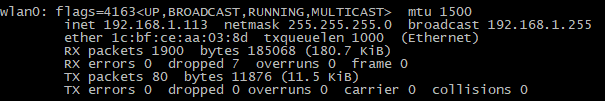

As i use this dogle https://aliexpress.ru/item/32950017313.html
`ve followed this way:
in /opt/Stereopi
run.sh - comment strings 16-23
*resize the partition as there`s no space left to install anything
sudo apt-get update && sudo apt-get install --reinstall raspberrypi-bootloader raspberrypi-kernel
sudo apt-get install raspberrypi-kernel-headers
*sudo apt-get upgrade
reboot
sudo cp /lib/modules/$(uname -r)/build/arch/arm/Makefile /lib/modules/$(uname -r)/build/arch/arm/Makefile.$(date +%Y%m%d%H%M)
sudo sed -i 's/-msoft-float//' /lib/modules/$(uname -r)/build/arch/arm/Makefile
sudo ln -s /lib/modules/$(uname -r)/build/arch/arm /lib/modules/$(uname -r)/build/arch/armv7l
git clone https://github.com/whitebatman2/rtl8821CU
cd rtl8821CU
sudo apt install bc
nano Makefile
CONFIG_PLATFORM_I386_PC = n
CONFIG_PLATFORM_ARM_RPI = y
CONFIG_PLATFORM_ARM_RPI3 = n
make
make install
modprobe 8821cu

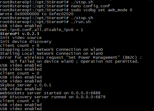

but as far as i went i did sudo apt-get upgrade and ...broke something. Cameras`re working (red lights flash on them) but no web-interface ))
Because of update i think.
Tried to start script run.sh in /opt/Stereopi but it gives back:
May be something in config.conf should be change or in run.sh ?

Zoldaten, apt-get upgrade is a bad thing, as I mentioned :-)
At least you can see the error stage - "Starting local network connection on Wlan0". Try to look in run.sh and find the workflow we use.
Some tips:
In run.sh we are starting wlan manager:
./scripts/wlan-switch.php &
this file includes "wlan.lib.php"
"wlan.lib.php" has LAN_stop and LAN_run functions.
Looks like your "Set power management" caused by row 164, i.e.:
shell_exec("sudo iwconfig $iface power off");
Also please take a look at row 178:
shell_exec('sudo wpa_supplicant -B -i ' . $iface . ' -D nl80211,wext -c /run/' . $iface . '.conf');
If you have updated driver, may be you need to put it here.
