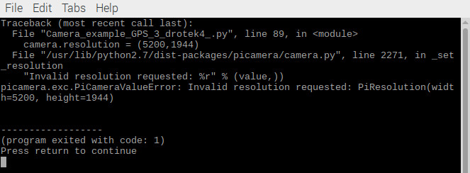

I've just started working on the StereoPi, which I want to use as double (still) camera setup on a Raspberry basis.
Working on my Python scripts from other Raspberries, I found one important limitation by the maximum resolution originating probably from the camera drivers. It seems that the resolution of a two-camera-setup capture seems somewhat still limited by the resolution of one camera, i.e. for double V1 Raspi camera modules to somewhat 2592x1944 px.
Obviously, it would be useful to get a capture with a width of 2x2592. Is there any way to get such a modification?
I guess that that limitation is somehow set within the camera drivers, isn't it?
Any advice is warmly welcome!
Thanks in advance

thanks for your prompt reply. I tried raspistill (e.g. raspistill -3d sbs -o "test.jpg" -w 5200) which works perfectly, however when it comes to Python, it blocks any attempt of increasing the width above the standard resolution
Maybe I am missing some specific tweak, but it seems as if it wouldn't work via the Picamera module.

1. Open config.txt file from /BOOT partition and increase number of GPU memory:
gpu_mem=256
It's strange, but raspistill works with the smaller number of GPU_MEM, and PiCamera needs more.
2. To fix an error from your screenshot, you need to do some changes in this file:
/usr/lib/python3/dist-packages/picamera/camera.py
You need root level to edit it, so I just run:
sudo thonny
to open editor with the super user privileges.
Go to the row 2271, mentioned in your error, and add '*2' at the end of expression. So you have:
(0 < value.width <= self.MAX_RESOLUTION.width*2) and
Do not forget to set "stereo_decimate=False" in your PiCamera settings.
I've attached both files (edited camera.py and my test Python code I used to capture image). Could you please check, if it works for you?
Re: Set max resolution
Posted: Fri Feb 07, 2020 4:51 pm
by pascalfust
Works as a charm like this... thanks for digging into that !!
