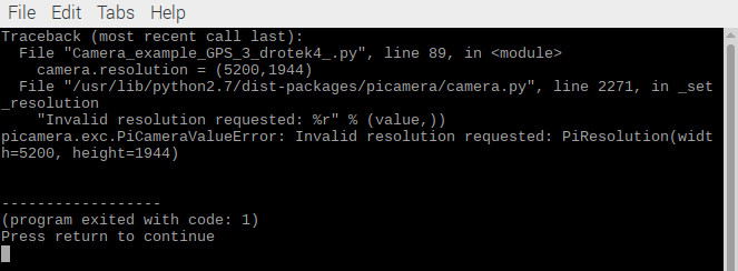

2. To fix an error from your screenshot, you need to do some changes in this file:
/usr/lib/python3/dist-packages/picamera/camera.py
You need root level to edit it, so I just run:
sudo thonny
to open editor with the super user privileges.
Go to the row 2271, mentioned in your error, and add '*2' at the end of expression. So you have:
(0 < value.width <= self.MAX_RESOLUTION.width*2) and
Do not forget to set "stereo_decimate=False" in your PiCamera settings.
I've attached both files (edited camera.py and my test Python code I used to capture image). Could you please check, if it works for you?
