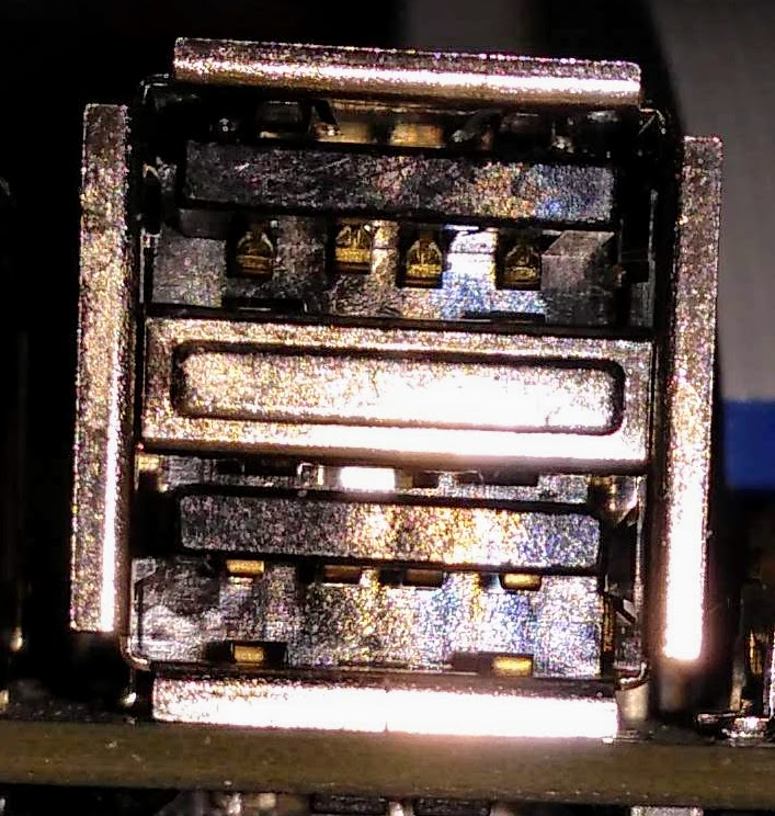

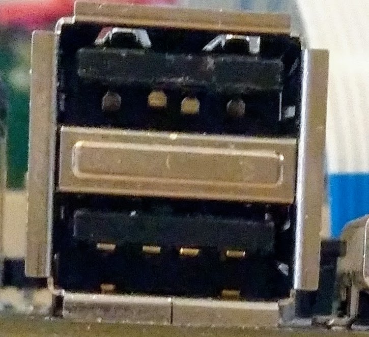

Yes, I have plugged in a keyboard and a mouse. The mouse is an optical one and does not light when the board is operating.
As far as I can tell, everything else is working perfectly. I am running the latest dedicated OS and have taken both video and stills very satisfactorily so I'm fairly certain the rest of the board is working perfectly. I have noticed that the USB sockets seem to be not quite correct.......
By this, I mean that the lower socket seems very loose and the upper very tight. On inspecting with a bright light, they also seemto have their connections at different depths from the front and plugs don't enter the socket fully.
I have just now checked the voltage on the underside of the USB sockets and both read 5v so that also seem to point to faulty sockets rather than the board.
Hope this helps

Could you please make a photo of your USB connectors? You can attach it here to your post, or send me by email to @gmail.com, with my nickname on this forum before '@' sign.
Also, as a plan B to use your board before replacement arrives, you can use 3rd USB on a pins. I usually do a simple adapter, using 4pin Dupont connector on one side (like this one), and USB A connector on another side.

Hi, USB 1 is a normal photo and USB 2 is taken with a flash to try and get more detail. Due to having to take a larger area to maintain focus and subsiquent cropping this is as good as it gets unfortunately.
USB 2.jpg (161.78 KiB) Viewed 9931 times
USB 1.jpg (120.11 KiB) Viewed 9931 times

Codfangler, thank you very much!
Now I understand your situation. I think it is a USB connector problem, as their contact pins inside should not be damaged by any USB device, as in your case. May be bottom connector is still Ok and you can use it before replacement board arrives.
I will contact you by email to discuss replacement details.
