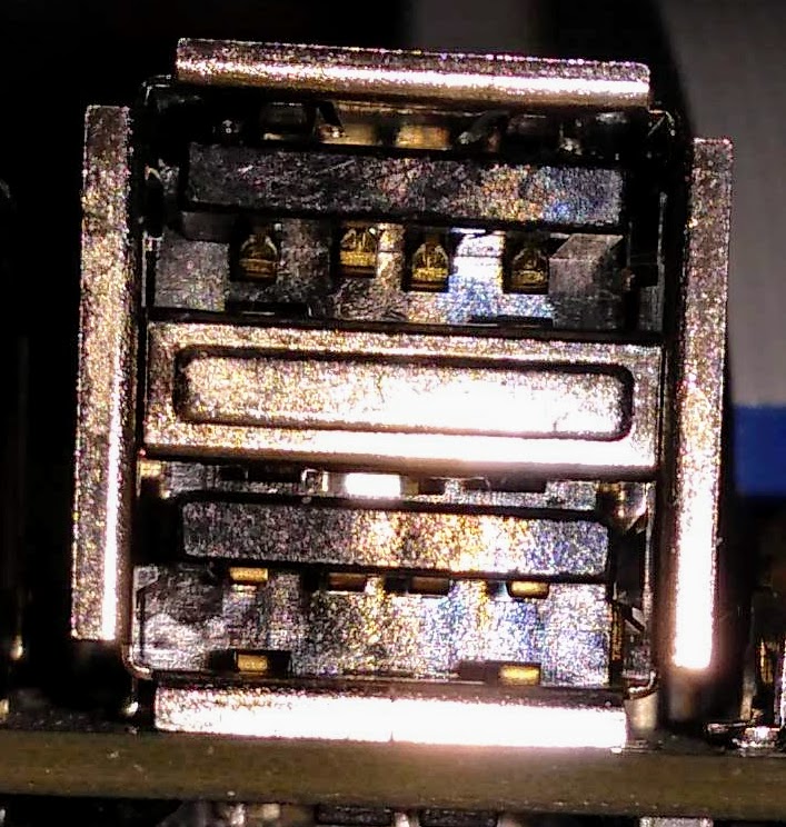

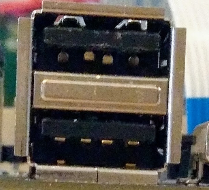

Hi, USB 1 is a normal photo and USB 2 is taken with a flash to try and get more detail. Due to having to take a larger area to maintain focus and subsiquent cropping this is as good as it gets unfortunately.

Re: USB power problem
Codfangler, thank you very much!
Now I understand your situation. I think it is a USB connector problem, as their contact pins inside should not be damaged by any USB device, as in your case. May be bottom connector is still Ok and you can use it before replacement board arrives.
I will contact you by email to discuss replacement details.
