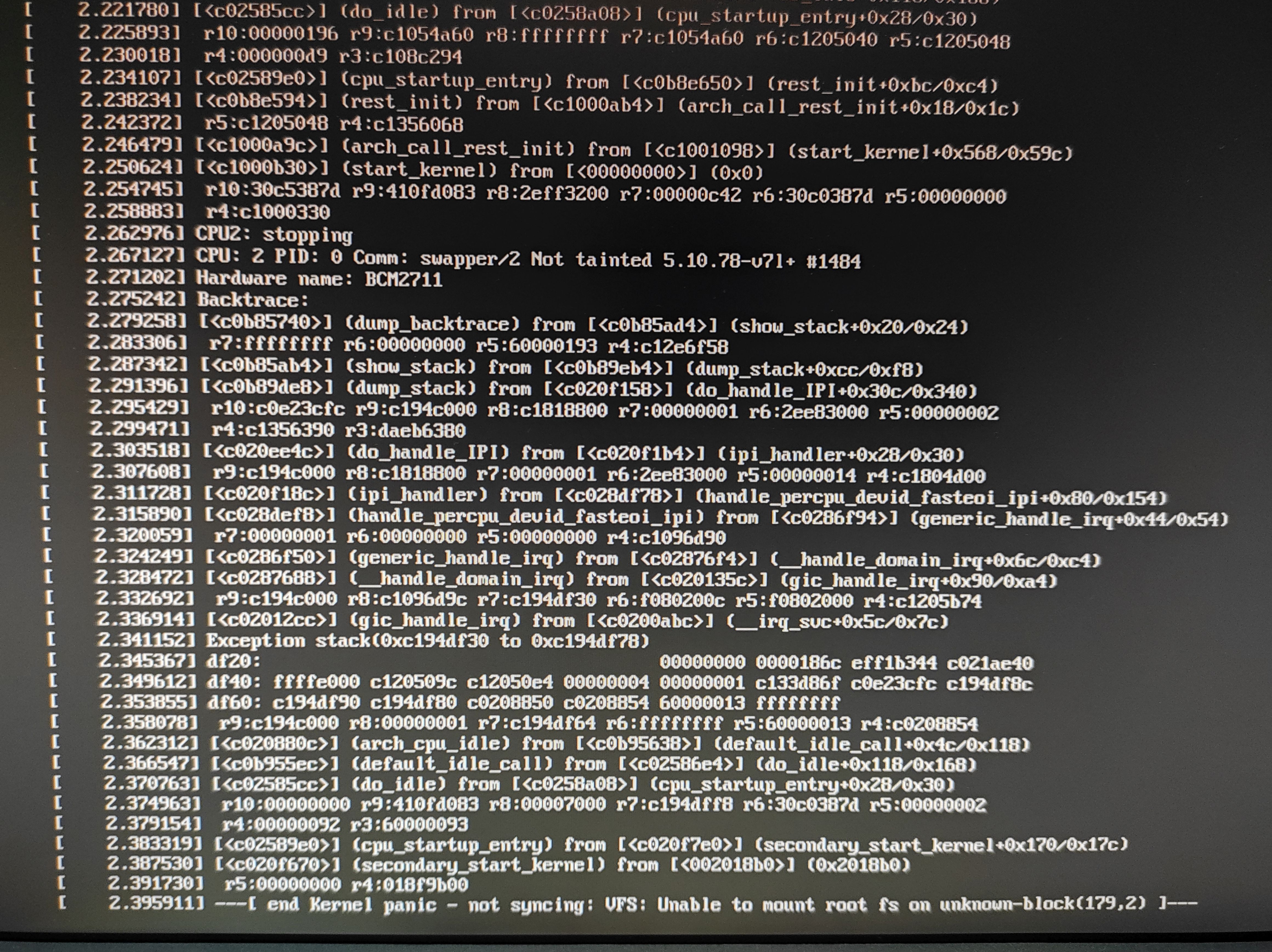

I have downloaded beta-version-slp2-0.11.19.zip version from your link (which is the latest) and using Win32DiskImager tool installed it in the micro SD.

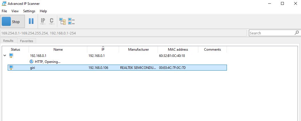

Without modifying anything in the config file, I have connected the ethernet cable from the router and not directly to my PC.
I can't see the StereoPi in the network. This is where I could not work it out.
I have used an IP Scanning software and I can not see StereoPi.

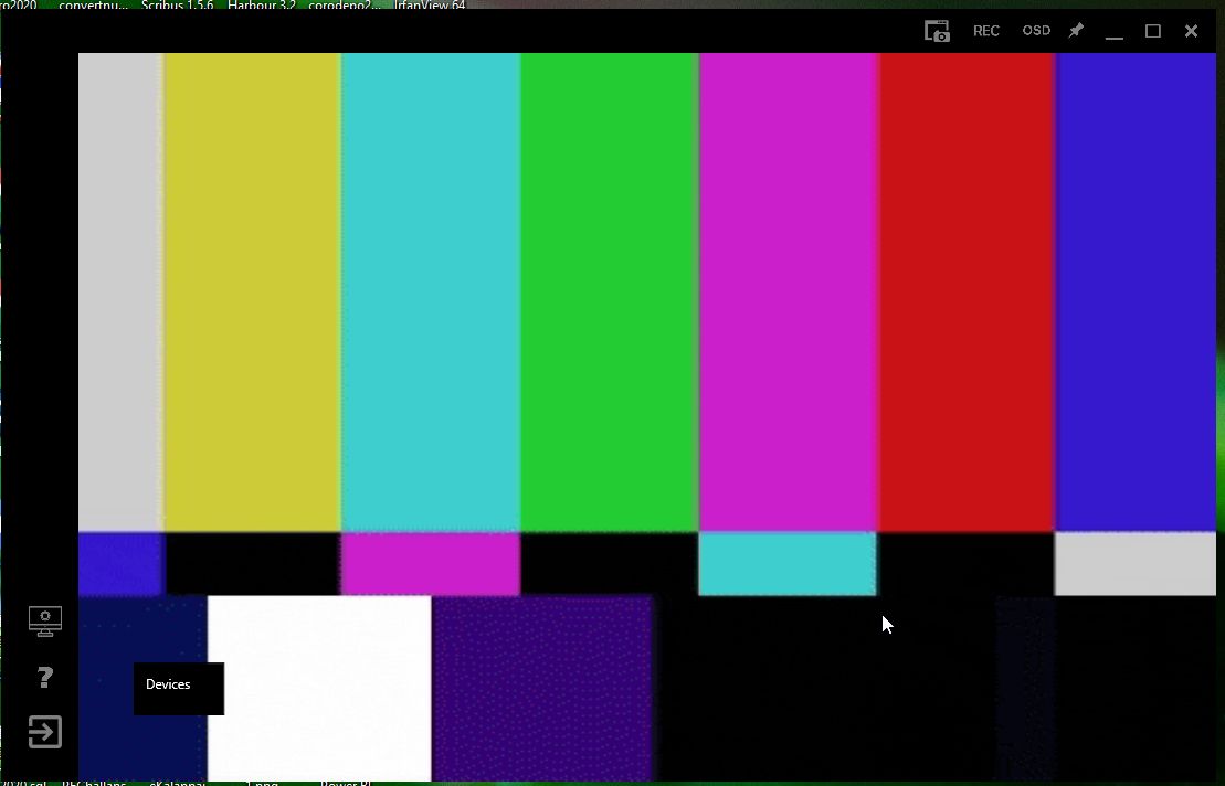

When I used Cosmostreamer desktop version I got the following screen and it doesn't pick up the StereoPi.

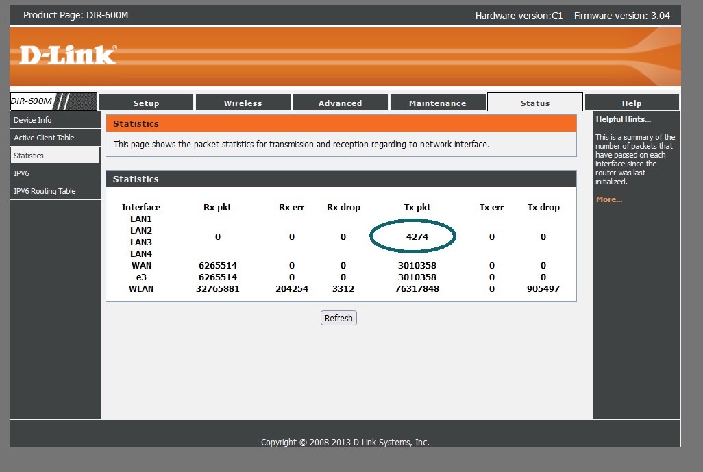

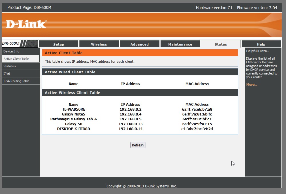

An update:
From the home router also, I don't see StereoPi in the active client table.
Whenever green color light is blinking in StereoPi, the Tx Pkt number is getting increased.

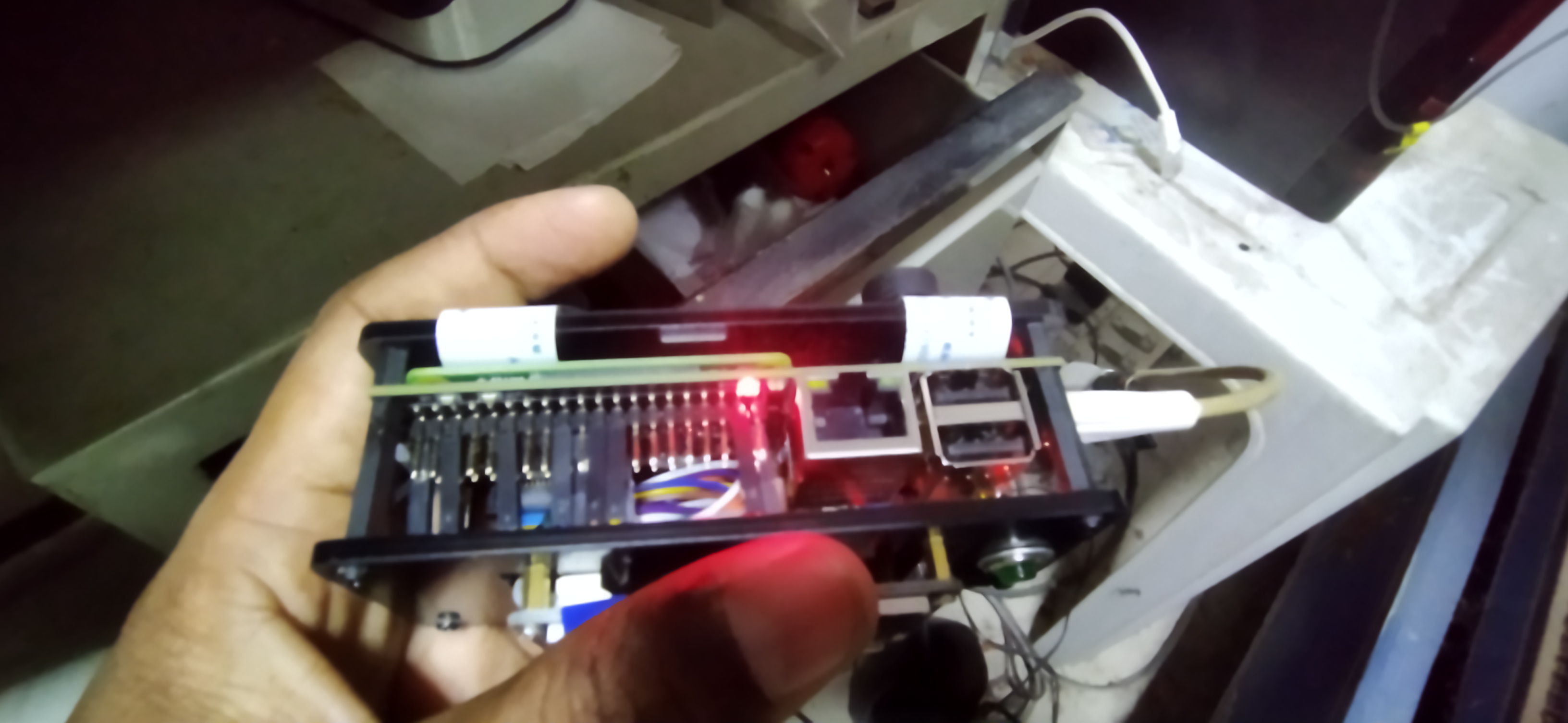

By the way, when you are using the fresh SLP installation and boot the StereoPi, are you able to see the "cosmostreamer" WiFi access point from any of your devices?
Is ACT_LED blinking while the boot process?
Your issue looks unusual to me. Maybe I will do a replacement for you.
Could you please try to do one more thing - please connect the monitor to the micro HDMI output of the StereoPi. This is the last thing I can check remotely.
Re: How to connect via WiFi
Posted: Sun Feb 13, 2022 1:23 pm
by srathinagiri

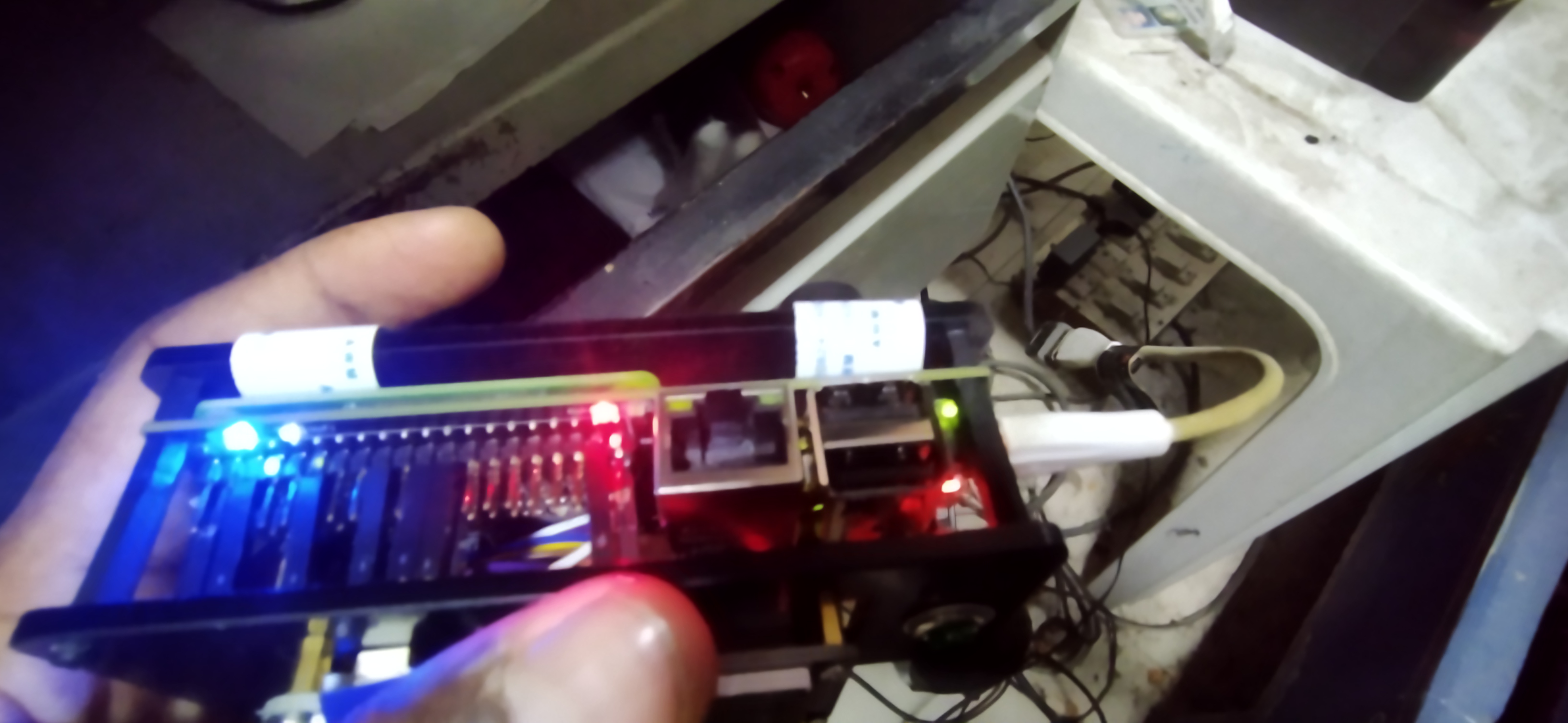

I have tried to connect thru Micro HDMI and I am getting the following screen.
I hope now you can guide me what to do!
