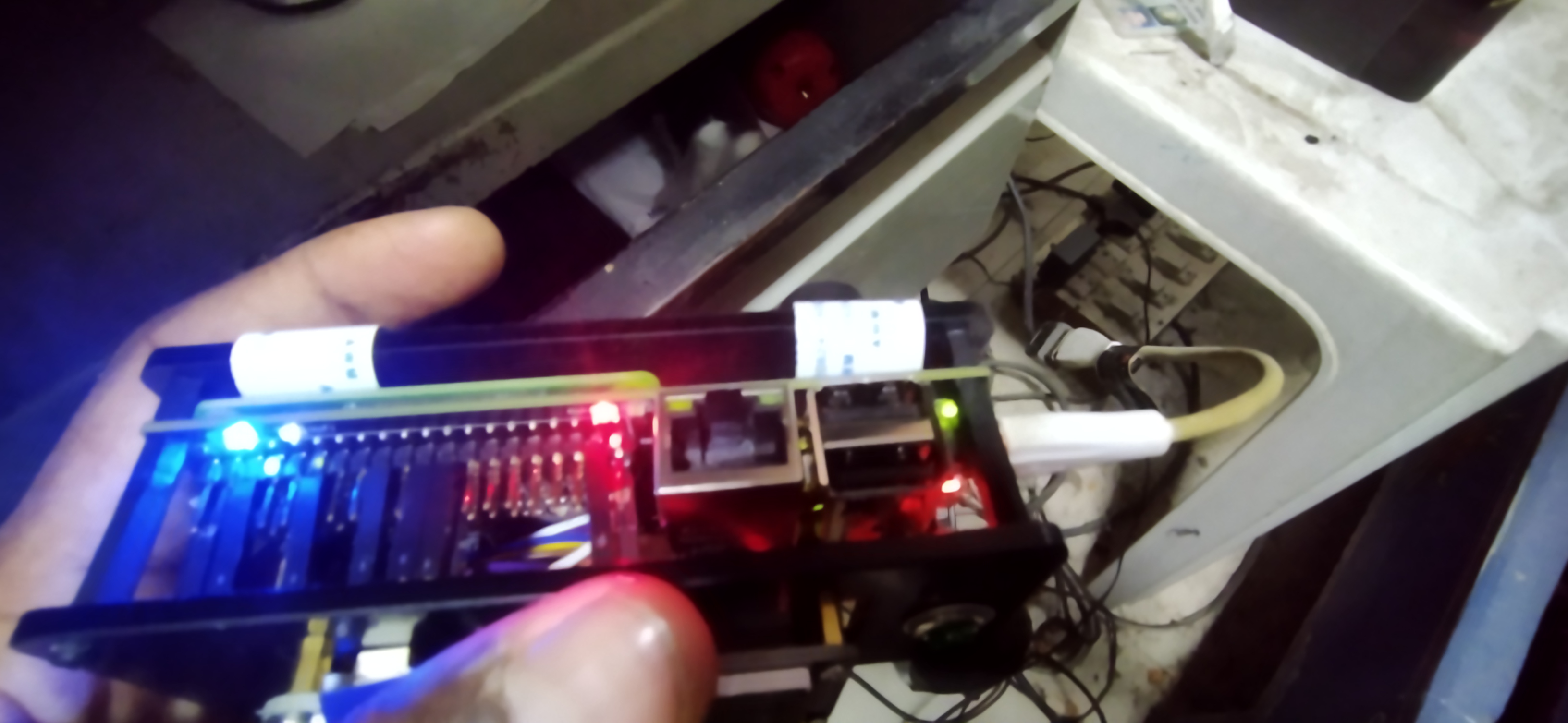

Now, please guide me to connect to the cameras/SLP2? Should I reboot?
I have unplugged and reconnected. Nothing happens. I can not see the device listed in the active clients of the wifi-router.
When in RPIBoot mode, Bluetooth and WiFi lights are on. If I remove power and add again, these light are off.

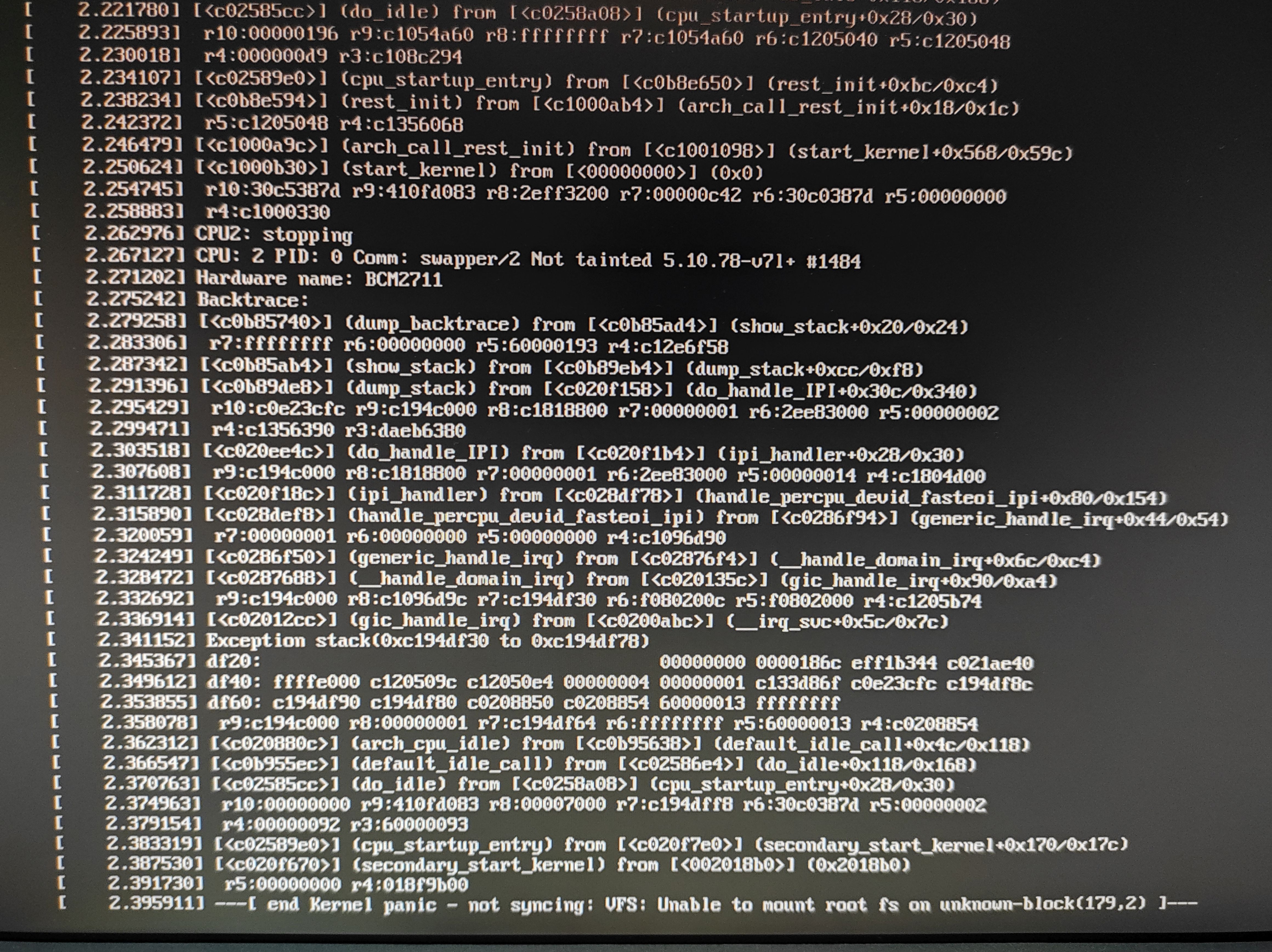

I have tried to connect using MicroHDMI to a monitor. No signal is coming out.
If I have removed the RPIBOOT and USBBOOT Jumpers and connected thru eMMC, HDMI is working and I can see the camera output in the monitor and that too for 10 seconds. After that it becomes still.
During RPIBOOT is enabled in Windows and after Ejecting the USB Drive, all the lights (BT, Wifi and ACT_LED) are ON (As seen in the pic).
After Removing the power and again connected, BT, Wifi and ACT_LED are OFF. When inserting the USB Cable, ACT_LED is just blinking once.
I have attached the config files (config.txt and cosmostreamer) also for your kind perusal. I have tried to make it as an access point. That is why it is enabled.

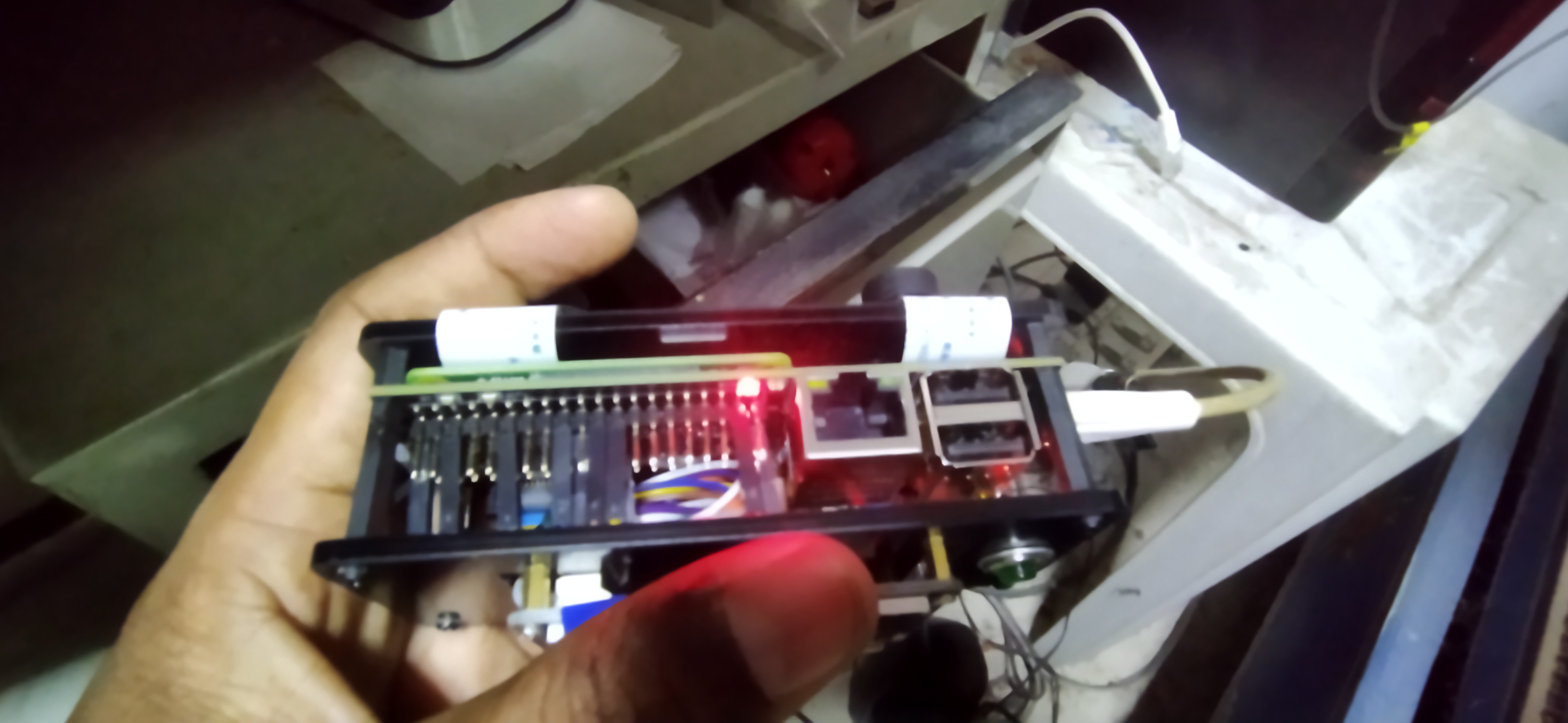

Now both the lights (Bluetooth, WiFi) are on.
But, I could not connect either using cosmostreamer access point or my own wi-fi router (after changing the cosmostreamer.conf file) or wired ethernet also. :(
When the ethernet connector is plugged in the green light is blinking. :idea:
I am not seeing StereoPi in the active client list of the router.
When I connect with Micro HDMI cable to a monitor, it says No signal. :(
When I try to run rpiboot from Windows, it says "Waiting for BCM2835/6/7/2711..."
What could be the reason? How to go further. Please guide me.

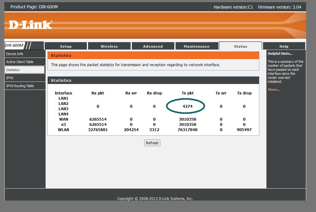

Unfortunately until now I can't connect either through Ethernet or WiFi. :(
Wifi Green light is On. When I am connecting my Ethernet cable, orange color light is on. Green color light is blinking. I have made static ip disabled. (For making static ip I need MAC address in my router D-Link DIR-600M. (How to get?))
My country is India. Country code is IN.
Can you please tell me how to do/enable the following?
1. Why cosmostreamer as an Access Point is not working? For that are Country Code and other details important? It is not showing in Android or Wifi laptop.
2. How to find MAC address without connecting the device? So that I will try to connect through static ip. @dnaman how did you connect with static ip?
3. Either through Ethernet or Wi-fi network interface how to make StereoPi to be shown in the client list?
4. When I try to run rpiboot from Windows, it says "Waiting for BCM2835/6/7/2711..."
I don't know what am I missing.
I have enclosed the cosmostreamer.conf (as of now I have enabled for Wi-Fi network interface) Please help me out.
cosmostreamer.zip
(1.49 KiB) Downloaded 874 times

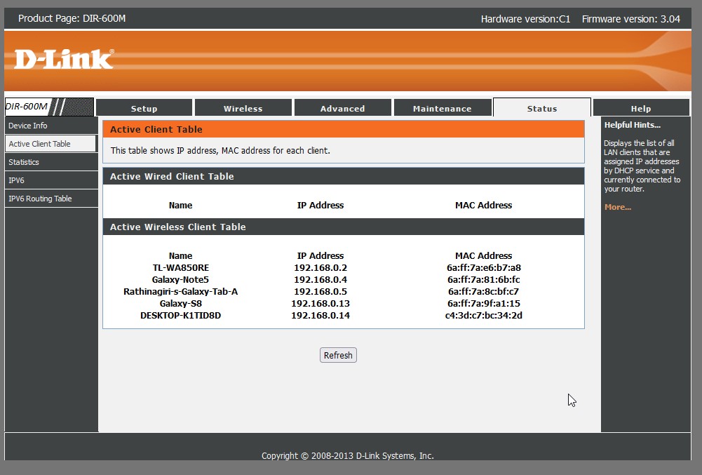

In my case, router doesn't show any device as connected. :(
Re: How to connect via WiFi

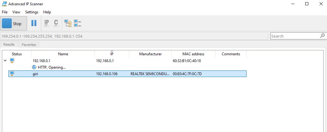

srathinagiri, let's try to debug this step by step.
1. Please forget about rpiboot, you don't need it at all with your CM4 Lite and micro SD. Please remove both jumpers USB_CLI and RPI_BOOT and keep them in a safe place.
2. Let's test the Ethernet connection first.
a) Please check that you are connecting your ethernet cable to your router, but not directly to your host PC
b) Please disable all wifi settings, and remove the static IP settings for Ethernet interface (you can use the attached config file for this)
c) When your system boots, you should be able to see the StereoPi in the network.
As an alternative to step b), you can use the fresh SLP2 image without any configuration changes - Ethernet connection should work out of the box.
How to find StereoPi 2 in the network:
- in Win10, type stereopi.local in the Edge browser - you should see the administration page
- use any network IP scanning software
- look at the router's clients information
- use Cosmostreamer Win10 desktop application - it will find the StereoPi in the network and show you the pop-up window

Sorry for not answering. I am on a business tour. Once I am back home I will do what you have suggested and revert back. Thank you for your detailed instructions.

As suggested by you I have removed both the jumpers USB_CLI and RPI_BOOT.
I have downloaded beta-version-slp2-0.11.19.zip version from your link (which is the latest) and using Win32DiskImager tool installed it in the micro SD.
Without modifying anything in the config file, I have connected the ethernet cable from the router and not directly to my PC.
I can't see the StereoPi in the network. This is where I could not work it out.
I have used an IP Scanning software and I can not see StereoPi.
When I type stereopi.local in Edge, it says, Hmmm… can't reach this page

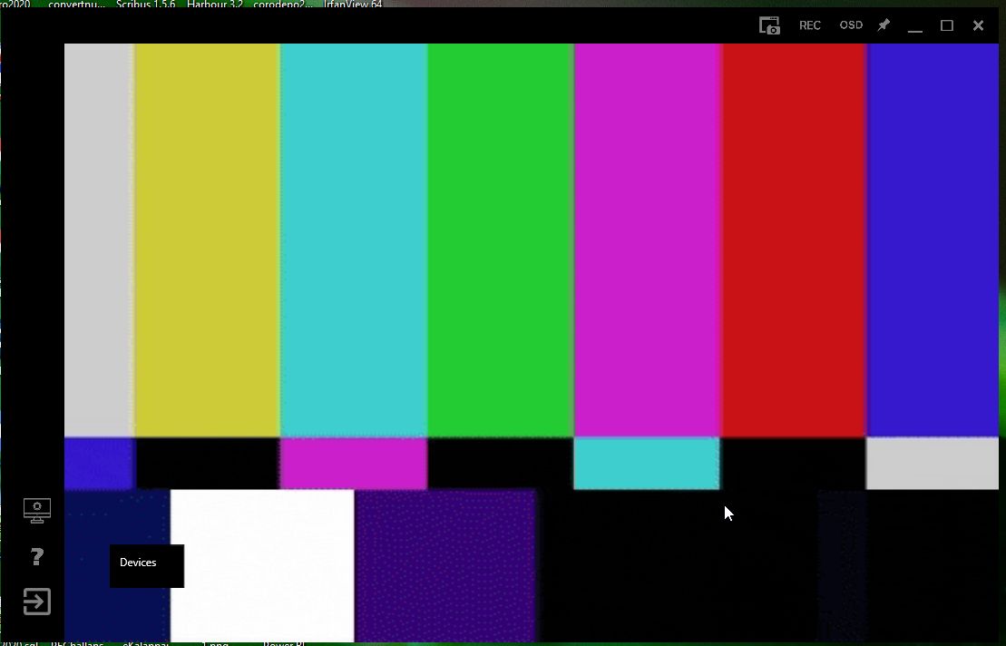

When I used Cosmostreamer desktop version I got the following screen and it doesn't pick up the StereoPi.
1. I will verify from my home router and revert back whether the same thing happens.
2. Whether we need country code to be setup for Ethernet also?
An update:
From the home router also, I don't see StereoPi in the active client table.
Whenever green color light is blinking in StereoPi, the Tx Pkt number is getting increased.

For the Ethernet you should not set any other parameters (like the country), it should "just work".
By the way, when you are using the fresh SLP installation and boot the StereoPi, are you able to see the "cosmostreamer" WiFi access point from any of your devices?
Is ACT_LED blinking while the boot process?

Could you please try to do one more thing - please connect the monitor to the micro HDMI output of the StereoPi. This is the last thing I can check remotely.

I have tried to connect thru Micro HDMI and I am getting the following screen.
I hope now you can guide me what to do!
