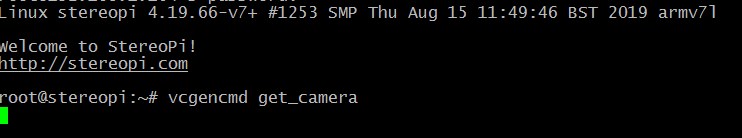

1.
vcgencmd get_camera
gives nothing with two cameras connected:
And freezes SSH-session.
2.
gives the same result.
*Ofcause, i remember of rw protection on partition.
But!
If i disconnect one of cameras and reboot. Everything works - i mean commands above gives something like supported=2 detected=1 and raspistill

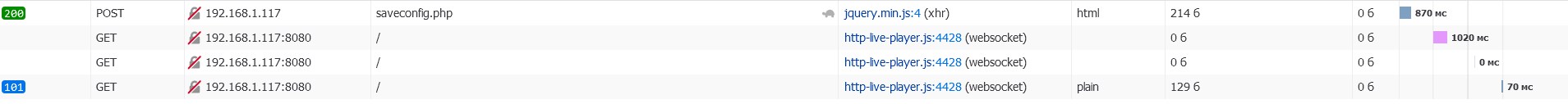

Admin panel looks well, i see cameras restart after push button "save", but it doesnt change options:
Cant catch why client try to get 8080 port after saveconfig.php...
