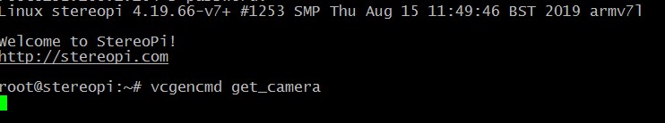

1.
vcgencmd get_camera
gives nothing with two cameras connected:
And freezes SSH-session.
2.

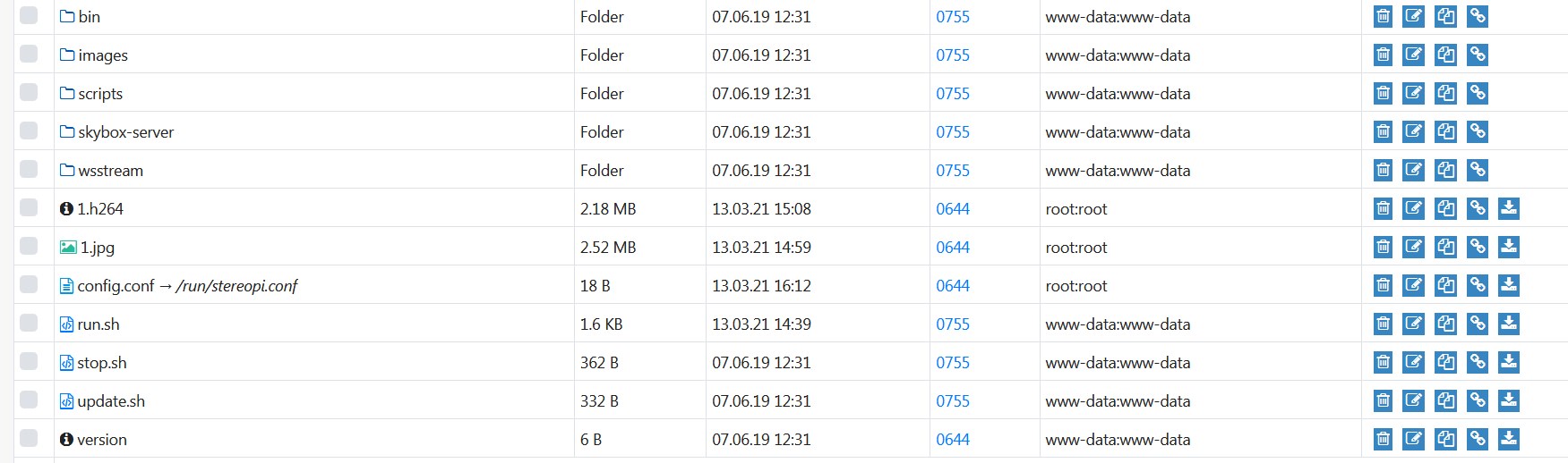

Could you share what rights dirs have, mine:

1. When our scripts are running (run.sh), they are using raspivid. So when you try to run "raspistill", it shows you an error. For the manual console run of "raspistill" or "raspivid" please stop our scripts first by stop.sh. Note: if you try to kill the raspivid process, but not run "stop.sh", our scripts will run it again. We have a self-check logic to run this again if something goes wrong.
2. /opt/Stereopi/config.conf is a local, system-used configuration. While booting, our system copies /boot/sterepi.conf to /opt/Stereopi/config.conf and work with it. So if you change anything in /opt/Stereopi/config.conf, your changes will be overwritten by the next boot. So please use /boot/sterepi.conf to change settings
3. As for the shot and record buttons in the admin panel after the update - could you please try to catch JS errors in your browser console after clicking those buttons? This will help a lot.

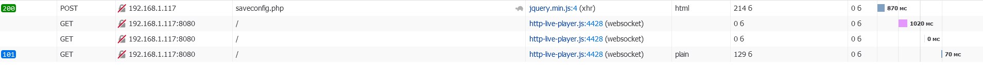

Admin panel looks well, i see cameras restart after push button "save", but it doesnt change options:
Cant catch why client try to get 8080 port after saveconfig.php...

Re: Bad gateway and no browser stream incoming after upgrading
Post by zoldaten »
But after reboot /opt/Stereopi/config.conf again with 644 rights (
How to fix that to 777 to make it automatic ?

zoldaten
Posts: 48
Joined: Fri Apr 26, 2019 7:07 am
Post by zoldaten »
My SLP updated image works well exept config.conf which needs 755 or 777 rights.
I`m trying to find how to change rights on boot or what change it back to 644. All other files in the same dir have 755.
