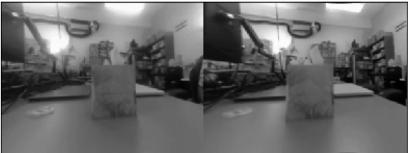

After some earlier advice we've managed to create a high quality disparity map! However, we're having a lot of trouble getting the actual distance from our disparity map.
Here are two frames from our video of a tissue box:
Here is our disparity map:

The tissue box is 200mm away. We're guessing that the third value is (Z/W) is what we need but we aren't sure of the units. We read somewhere that the disparity map returned by opencv is scaled by 16, and we've made the assumption that the returned units are cm. This gives us 1.1743402 * 16 * 10 = about 192mm, which is our best result thus far.
