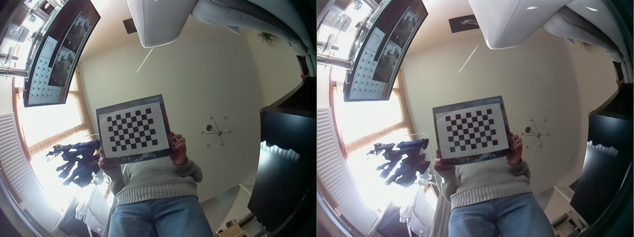

I am running the Stereo Pi Fisheye tutorial. I am on part 4, the calibration. I seem to calibrate both individual cameras but it fails on the Stereo calibration.
File "4_calibration_fisheye.py", line 170, in calibrate_one_camera
result = calibrate_one_camera(objpointsRIght, imgpointsRight, 'right')
(cv2.TERM_CRITERIA_EPS+cv2.TERM_CRITERIA_MAX_ITER, 30 1e-6)
cv2.error: OpenCV(3.4.3) /home/pi/opencv-python/opencv/modules/calib3d/src/fisheye.cpp:1371:error:(-215:Assertion failed) fabs(norm_u1) > 0 in function 'InitExtrinsics'
Any ideas what could be going wrong? Is it the pictures?
Could it be there is a delay between cameras? How to check for this?

Hi Bensailor,
I mentioned this problem in my last article.
The reason is one of your images. You should find this image and exclude it, and I use "halving" method for this. If you will have a problem with this, please send me your images set, and I will try to localize it.
Looks like it is often problem, and I need to try to catch this error and find wrong image automatically (but this is not easy).
UPD> Your left and right cameras are definitely swapped on your image...

I've downloaded your photos.
I don't know, if you try to turn on checkerboard visualization here. I always turn it on for the first run.
So as I can see chessboard was not found at all. I.e. there are no any images in your set, where OpenCV were able to find checkerboard.
Here are some tips:
- Light. You have a window on the left, and have a "counter light". Light should go from your camera and highlights chessboard, but not vice versa. Try to orient your camera to the area without bright lights
- Size of the chessboard on your images. You use 200 degree camera, and checkerboard looks tiny. Try to keep it closer to the camera. You can look at a sample image set from our repository to estimate acceptable size of the chessboard on the image.
- I noticed your chessboard image is not flat. This will not stop corners detection algorithm, but may affect on the calibration quality.
(For more tips please read part "4. Let's calibrate.." in our article.)
As a first step I'd recommend you to make another session with no counter light, and with keeping checkerboard closer to the camera.
Next step (if calibration is still not good) - flatten checkerboard setup.
You can also use advanced approach. As I mention in our article, we use a couple of 320x240 images for the depth map, but 640x480 for calibration. You can use a couple of 1280x960 images for calibration - in this case corner finding process will be much more successful. You need to look at this piece of code for this trick.

Sorry for long reply been away, and its been chaotic with current situation. I now have some time and really want to solve this.
One thought i had with why you cant detect checkerboards is i used a 8x6 checkerboard. Sorry i should have mentioned this before.
I have tried again, with a bigger 8x6 checkerboard and properly stuck to hard cardboard and better lighting, but still run into same problem with able to calibrate left and right but not stereo pair.
Also i have the same code as you but it doesnt display any images, which i find strange
