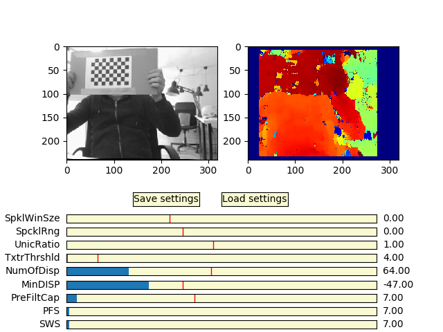

I managed to identify the problematic pair, and the script finished without errors. I then moved on to script number 5, and unfortunately, this is as far as I got. The output of the depth map is really underwhelming, and while I managed to improve it slightly by adjusting the bars in the interface, it's a looong way from being good. I added the initial depth map as well as the one I managed to generate as attachments. As you can see, the bottle is detected somewhat, but other than that, it's pretty bad. My question is, how to optimize these results.

According to your depth map on your first image, I see some "depth" inversion on your left edge of a table. Closest to the camera parts are blue, and far elements are red. This problem usually has 2 reasons:
1. Your left and right images are swapped. Please check you have the same camera capture settings for the calibration and for the capture.
2. You need to adjust MinDisp and NumOfDisp settings
If you can send me an archive with your images (ideally with the removed "bad" images) and a sample image, I will try to make an experiment and find other issues (if any). You can zip all files and put it somwhere in the cloud (Google drive etc.)

Ok, looks like I found a problem source.
To say briefly, you've taken calibration chessboard images with one camera setup, but image for your depth map with another setup. Under "setup" I mean the positions of the cameras with respect to each other on your camera mounting plate.
That's why it is recommended to fix cameras as robust as possible, because if you move one of them, you need to recalibrate your setup.
What am I did:
1. I did a calibration based on your images set
2. I used your image with the bottle and a keybiard for DM tune, But after calibration I noticed, that key points (like a top of the bottle) is not equalized horisontally.
3. So instead of your bottle-keyboard image I used one of your scenes photo for Depth Map calibration (resized it from 1280x480 to 640x240 before).
I used a "scenes" window on this screenshot as a ruler. You may compare the position of the bottle's cap on the left and right photos (left cap is higher), and the position of your hand on the chessboard photo (position on the right photo is higher).
So the idea is: fix cameras, so they can not move even slightly, after that do your calibration, and conduct your experiments. If you re-assemble your setup, or move one of your cameras, please do recalibration.
p.s. I decreased all DM settings to zero, except mindisp and numofdisp. THis helps to find appropriate settings faster. After that you can tune other parameters to get smoother DM.

If it helps - I tried switching back imgLeft and imgRight, and I got this result. It's relatively close to what you got, only switched (red = far away, blue = close).

we noticed that our version of the code was slightly older than the one on your repository, so we updated it, reran the calibration and dm tuning with the images and your settings. Below is the result, which is very consistent with what you get.
