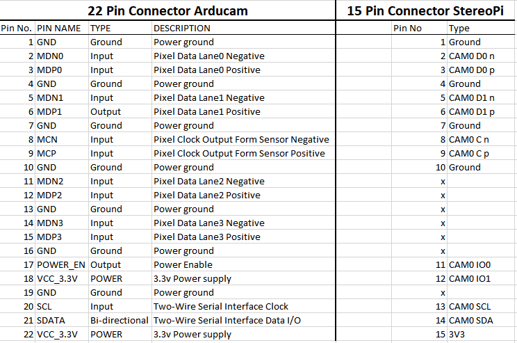

I also compared the pin-out from my Arducam with the pin-out from the StereoPi schematic:
Except the data lane 2 and 3 everything matches. But this two lanes are not required, because MIPI-CSI can also work with only 2 lanes (0 and 1). Even the raspberry pi zero is missing lane 2 and 3(see Raspberry Pi Zero schematic) on its connector (and with the zero, the camera worked). So the cable should perform well.
