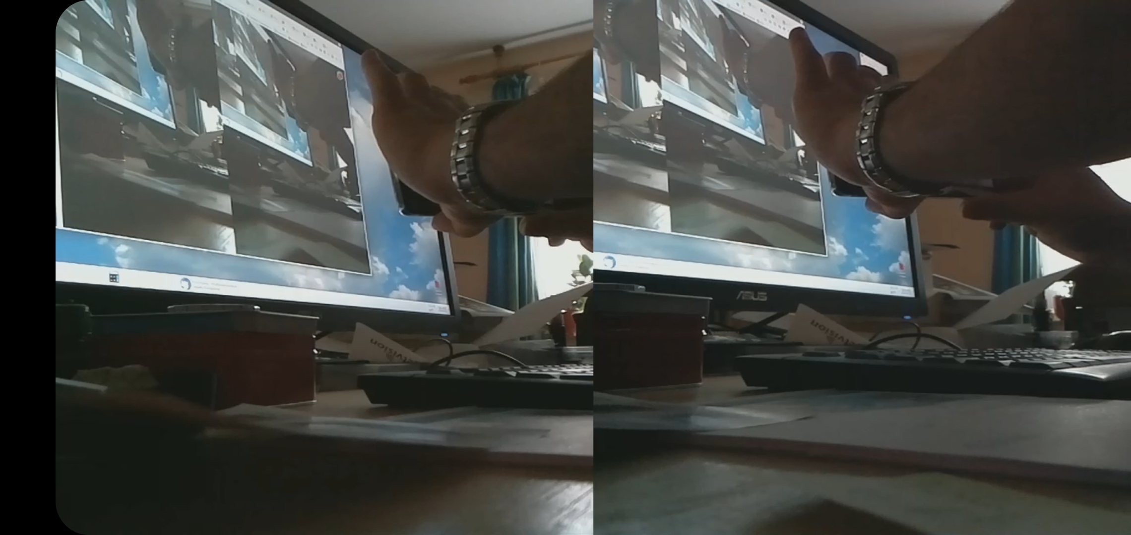

Post by Taki »
Hi Eugene,
I can confirm it works. I uploaded it via web browser and after a few moments, i had a stream on both, my browser and my smartphone. The V1 cameras need obviously more light ;)
Thanks for the good work!
Taki
