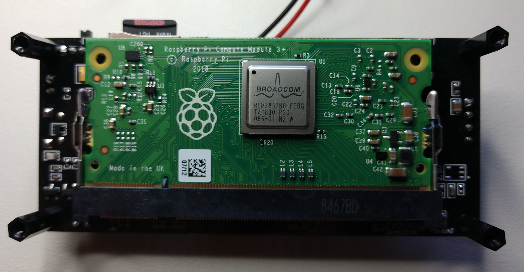

My board does not seem to be booting. I have a Raspberry Pi Compute Module 3+ connected (I have no other way of testing this module, but it is brand new). I have two Raspberry Pi Camera v2.1 modules connected. I am providing 5.0VDC at up to 4.0A. The board is drawing between 0.123A and 0.129A steadily, depending on what is connected. The only sign of activity I have is the three red LEDs are coming on labeled 1.8V, 3.3V and another one by USB SLAVE. I do not have the USB SLAVE jumper shorted.
I have tried two different MicroSD cards: one with the SLP image, and another with Raspian that works in a Raspberry Pi. I tried two different monitors. I have tried without the camera modules connected. I have tried without any USB devices connected. I have tried removing and replacing the compute module many times. If I connect an Ethernet cable, I get no lights on the jack. I have waited several minutes each time to see if an image does eventually show up on the screen, but each time, just 3 red lights.
I don't know what else to try. Please help!

Looks like you are using not "Lite" edition of CM3+, but eMMC equipped. Can you clarify this please?rlhelinski wrote: Sat May 25, 2019 9:58 pm My board does not seem to be booting. I have a Raspberry Pi Compute Module 3+ connect (I have no other way of testing this module, but it is brand new).

Yes, that is correct. This is not the CM3L. See attached picture. Is the eMMC-equipped module compatible?
- IMG_20190527_103847843.jpg (445.54 KiB) Viewed 76386 times
Re: StereoPi Not Booting
Yes, of course. You can upload Linux image to eMMC.
To say briefly, you can use either micro SD, or eMMC (like in reference RPi devboard), as they uses the same SDIO lines.
You can read details here in our Wiki.
One notice for you. If you'll upload our S.L.P. image to eMMC, Linux partition will take 2 Gb of the eMMC size. All other space will be formatted to FAT32 for saving photo and video.
