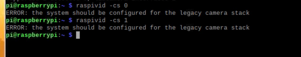

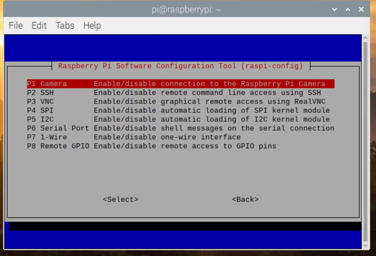

i didn't altered the test.py but i changed gpu_mem to 512Mb but the same error .i attached the results for the 2 commands you asked me to do and after that i tried to change the mode to legacy but i didn't find the option in the raspi-config as you can see.do i need to disconnect the ribbon and reconnect it.

It looks like you're using the fresh RaspiOS, which does not have the MMAL/raspivid/raspistill video stack.
The easiest way is to get the ready-to-use OpenCV image here: https://www.mediafire.com/folder/nzr90vj8wp1l3/SLP
