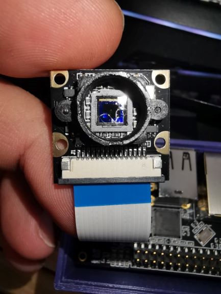

Just picked up my stereopi deluxe kit. I assembled the waveshare 160 degree cameras onto the board to test and found significant artefacts in one of the lenses. I have attached a photo, there are three circled all together
artefacts circled in yellow
After seeing this, I removed the lense from the camera and found that the sensor has some kind of substance on it that I assume is glue, likely from when the lense has been attached.
Whats the best course of action to take?

on closer inspection, it seems that the sensor itself is cracked. I've sourced a replacement which should arrive saturday hopefully

Well, Mr-Qu33f , as they says "shit happens". It's first time I see new, not used and already defective Waveshare camera! :-)
I planned to propose you replacement procedure, but I see you've already ordered new one. Let me suggest you to refund your additional camera. I'll write you personal email to discuss how can I transfer money to you.
Hope it is Ok with other cameras and, the most important thing for me, with the StereoPi!
