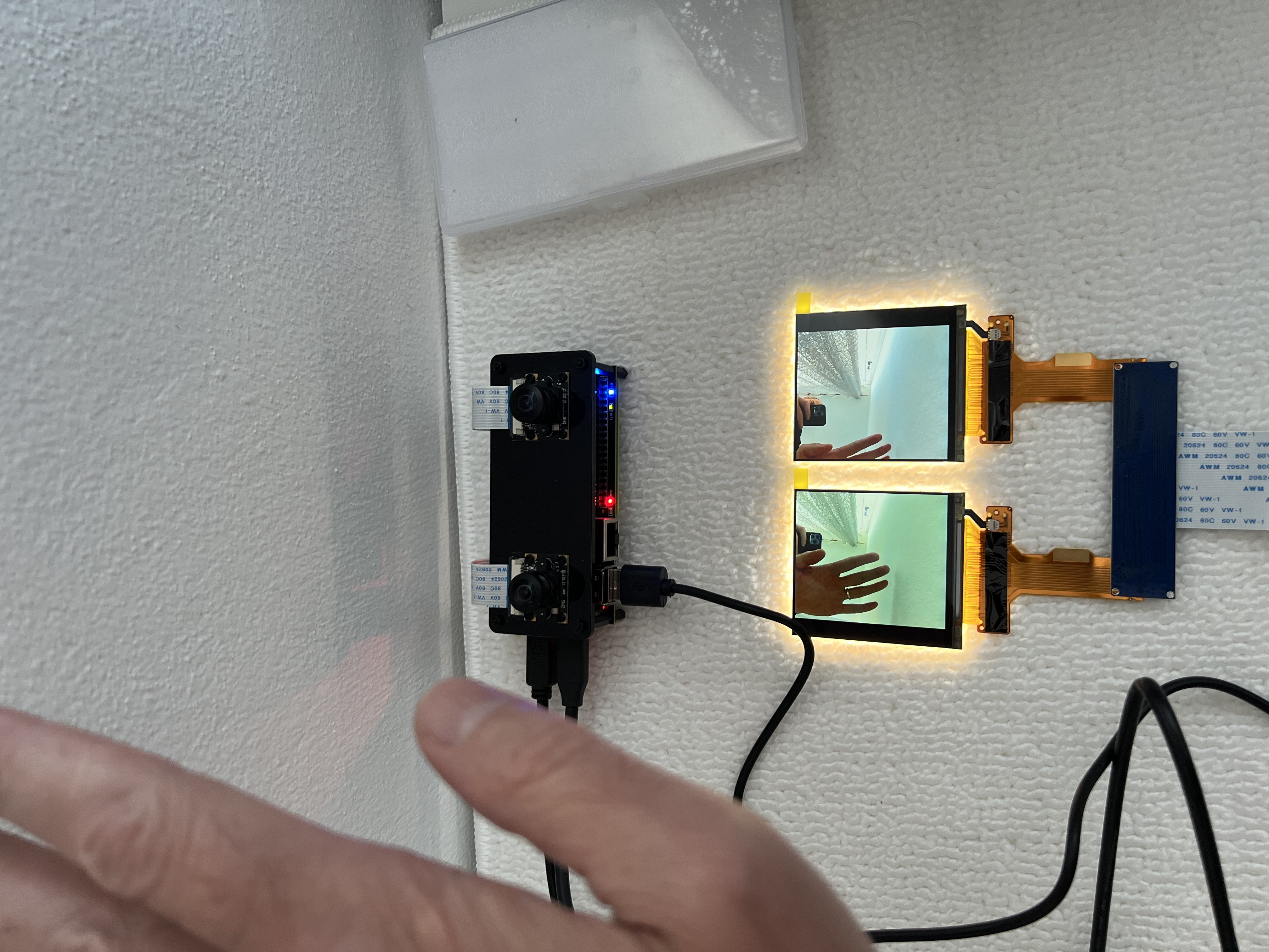

Our search of horizontally oriented screen led us to this item. Yes, it's bulky and need a 3D printed case, as well as plastic gear with lenses like this one. But it finally works with custom settings and resolution 1440x1440 per eye, or 2880x1440 as the total HDMI output resolution.
