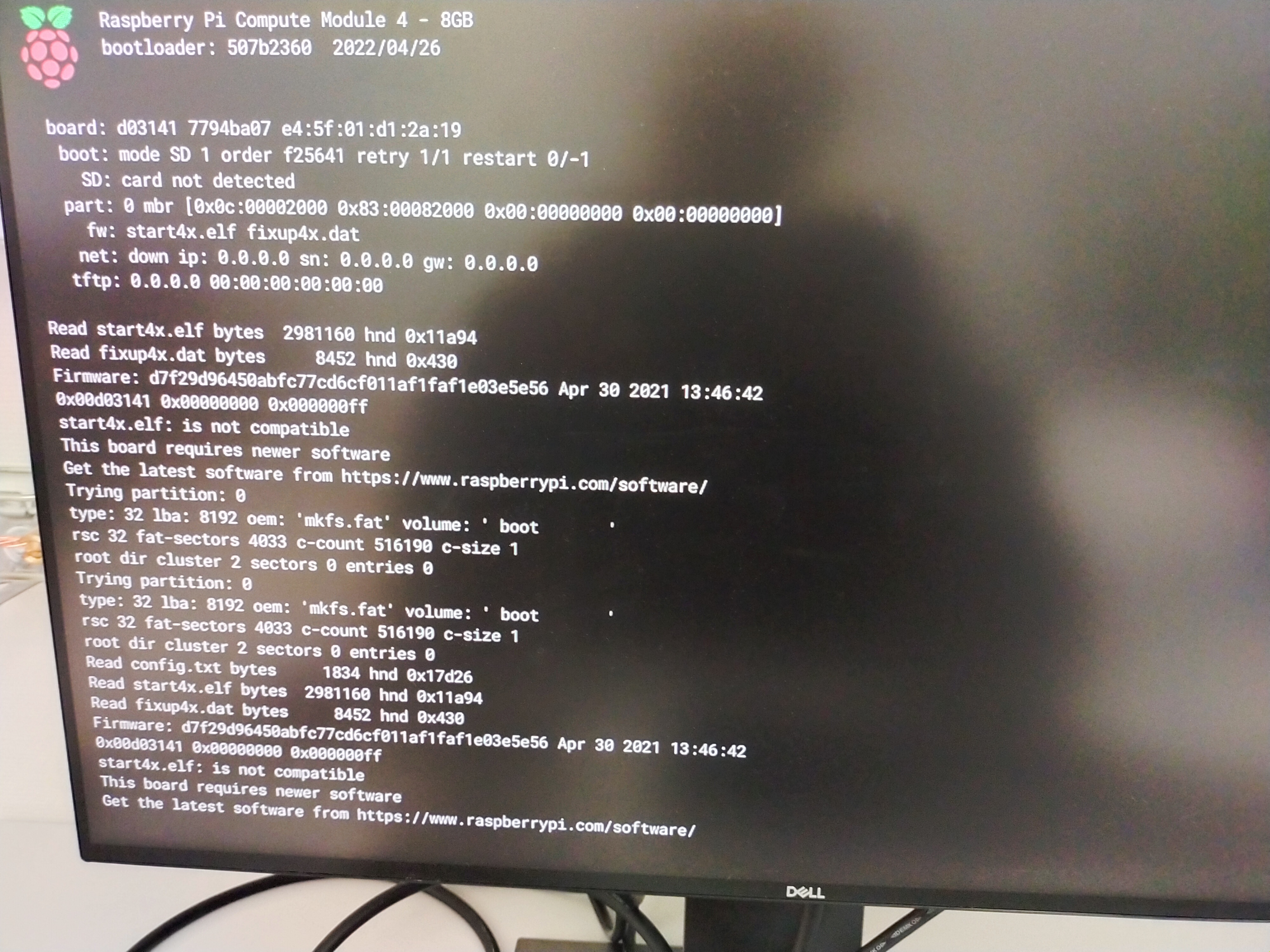

I have recently received a Steropi v2 board, and a CM4108032. Following the different steps on the wiki page, I have tried to use the SLP2 images provided. I managed to mount the system using the rpiboot feature, and write the image on the eMMC using RpiImager. However, it seems that there are some kind of troubles, from what I understand, the SLP2 version on the link is not compatible with my CM4. You can see enclosed a picture of the screen I have when booting the system.

Uh... I had never faced an issue like this. I'll try to find CM4108032 to test this. It looks like 8Gb has some specific EEPROM, which requires kernel update in SLP.
