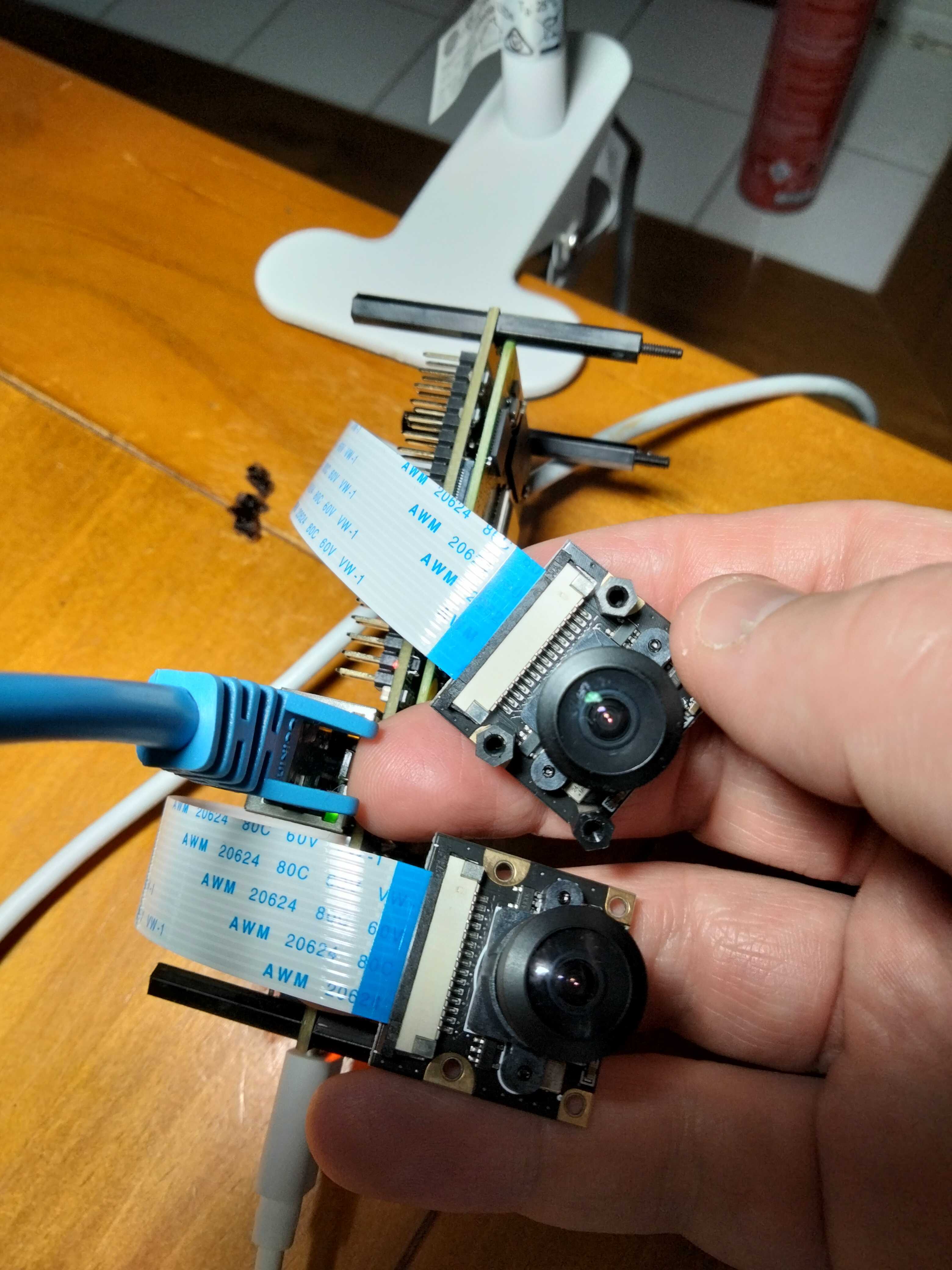

Could you please share a photo of the camera with the ribbon inserted?

Thanks for your response. Excuse my delayed response, I was on a work trip. Here is a photo of connected cables in the camera
I'd tried 6 different ribbons and none had worked. The ethernet lights no longer light up and i cannot connect to the device using ethernet or wifi.

I unplugged the pi4 compute module and reset it in position, this brought back the wifi and ethernet, and 2 cameras are now being detected. My installing of the pi4 module was bad. I still have a black screen in stereopi.local but 2 cameras are being detected. I'll play around a bit more and see if i can get it going
Re: cameras not detected
Uh, it was the CM4 installation. Yup, installing it up to the sensible "click" is crucial.
