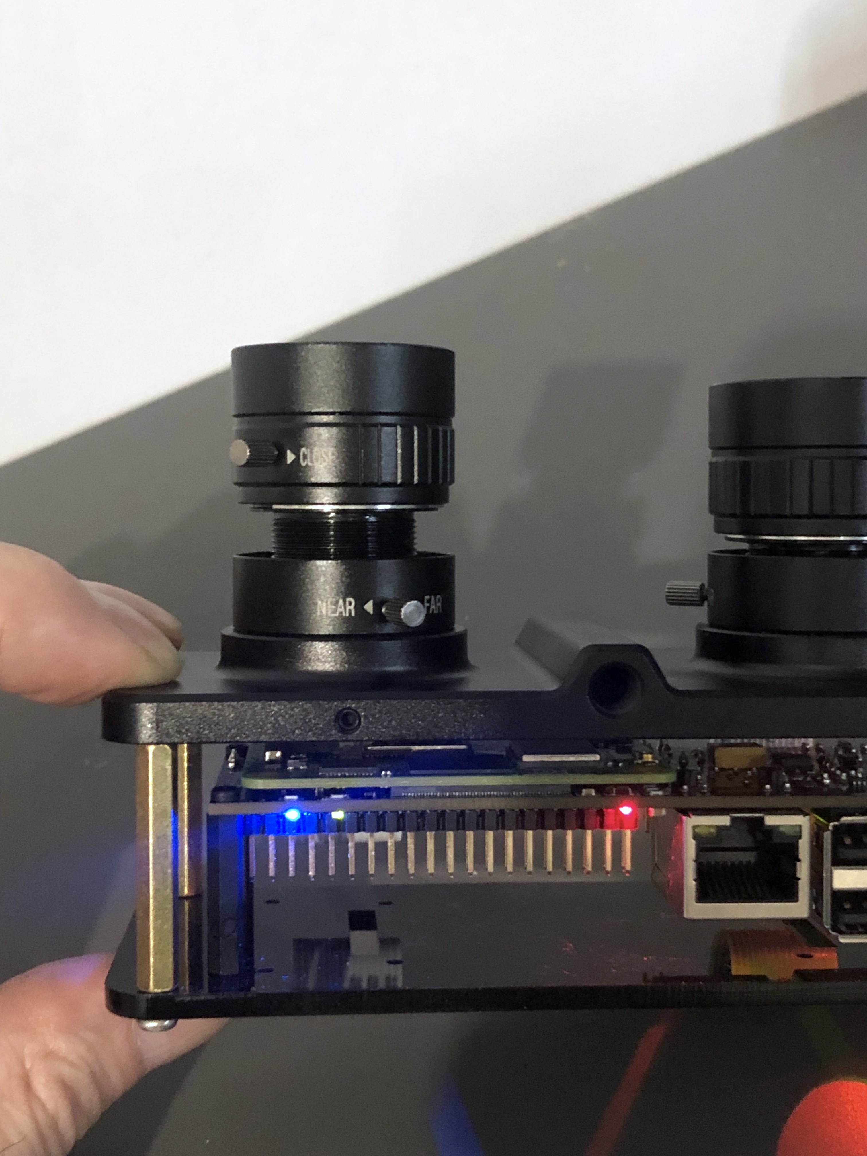

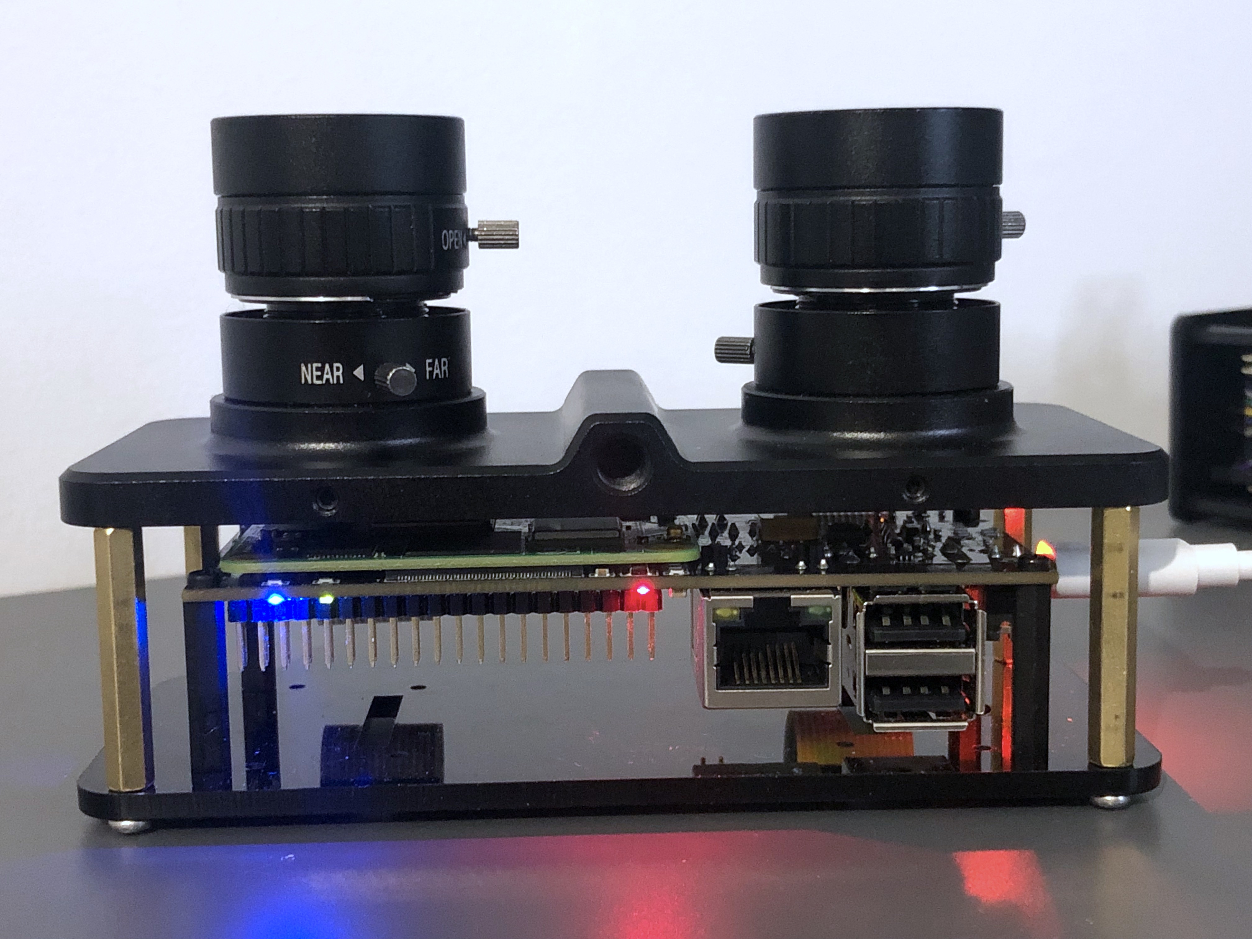

joedevivo, you intrigued me with your 6mm lenses issue.
Did you try to tighten the iris fixing screw and rotate the very top ring after that? This adds one more level of focus freedom for the 6mm lens :-)
Could you please share a photo of the 6mm lenses installed?
In my photo, you can see two 6mm lenses focused without the C-CS adaptor ring.
Re: V2 HQ Housing Assembly Focus issue
Posted: Wed Oct 20, 2021 9:05 pm
p.s. Here is the photo which can clarify the 6mm lens adjustment margin. This feature in not obvious from the official datasheet for this lens. Look at the left lens here:
I mean other lenses might have the same "feature" of extra adjustment.

Eugene, every time I look at those pictures (and my 6mm lenses do the same thing of course) it seems totally wrong to me to have to unscrew the lens like that simply to achieve the infinity position (and farther still to focus on anything closer).
On mine, it looked like it was open about 5mm so I tried a 5mm C/CS adapter but that was too much. (Also the 6mm lens doesn't screw fully home in the adapter because of the step in the adapter bore).
I do have some 1mm and 2mm adjustment rings on the way but since they are rings, they will take up thread length on the lens and may be impractical.
As far as I can see, a better way to do it would be to shorten the height of the bosses on the lens mounting plate. Is it possible to buy the mounting plate(s) separately?
