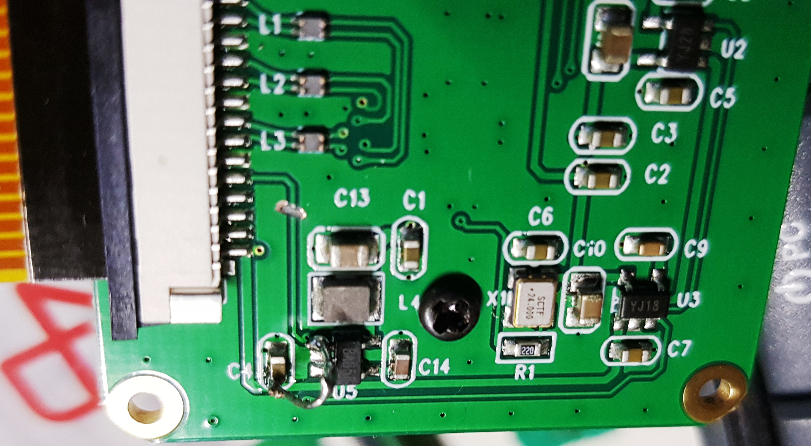

I then checked the I2C lines of the 2 cameras: they indeed contain the identification frames of the cameras: BUT ONLY ONE IS POWERED !!!
I tried to find information to drive the "CAM_GPIO" signal, without success.
I then used an electronic technician's solution (which I am ...): scraping a track and soldering a bridge! View the photo.

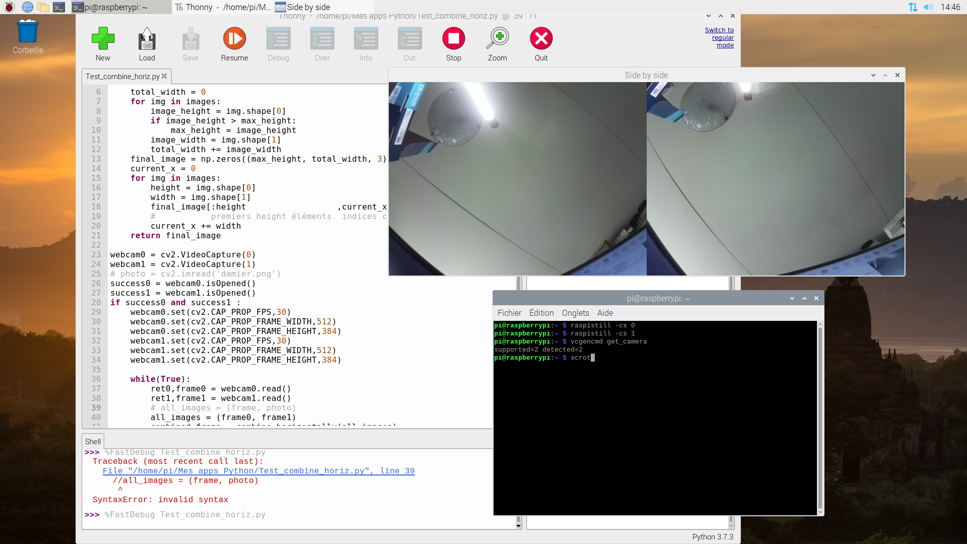

Now the 2 cameras are operational. View the photo

- Screen copy with the 2 camera activ
- 2021-05-07-144648_1920x1080_scrot.png (1.07 MiB) Viewed 79196 times
- Photo of the 2 hardware camera modifications
- Modif camera IMX219.jpg (1.51 MiB) Viewed 79196 times
