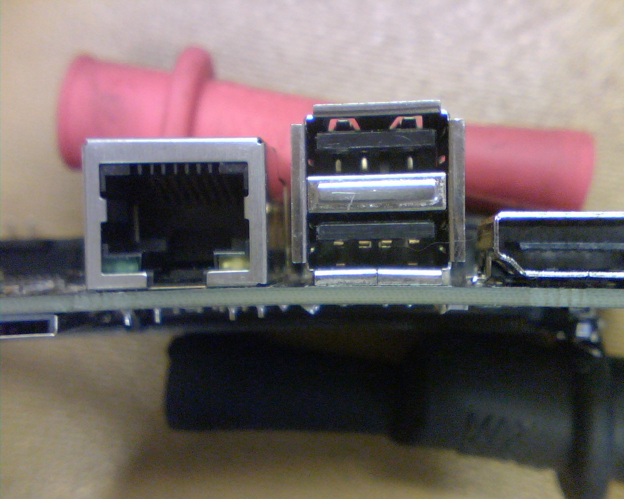

Now that I have removed C23, C24, and C47 I still have the same problem, short between ground and 5V. My board failed after installing a USB WiFi dongle. Should have looked there first. There are no pins to connect to the dongle as it looks like they were pushed down and bent when I inserted the dongle. Photo attached. Now assuming the short is in the USB port and hopefully mine is an anomaly. Will remove and test. Hopefully C23,C24 and C47 are not polarized as I did not see any marking to indicate they were.
- StereoPi_USB.jpg (284.89 KiB) Viewed 23099 times
Re: Fried PMIC
ChuckE, your situation with USB connector contacts bending is exclusion in this batch. I can suggest, that this is connector problem (production defect). Let me suggest you replacement board, I will send it to you from our new batch. We expect to start shipping next week. If you will be able to repair your sample, you will have two StereoPis
UPD> If you're curious, at this moment from our first 630 pcs batch we have 3 replacement cases. Your case is USB connector problem, and two another cases concerns camera connector problem. That is now we have 0,47% of defective units in this batch. I think this is good quality, and we'll try to decrease this 0,47% in the future.

I am grateful for your great customer support. I know that your second batch is expected to start shipping on the 17th as I have ordered a second Stereopi. I am happy to report that with extreme effort I was able to remove the USB port, replace PMIC and caps, and the unit has successfully booted up. I will have to remotely access it through the network connection to see if I have not damaged the camera connections or anything else too severely. Looking forward to working with the units, ChuckE.

Unfortunately it did not last long, must have damaged board removing USB socket. Hopefully this week for new boards.
