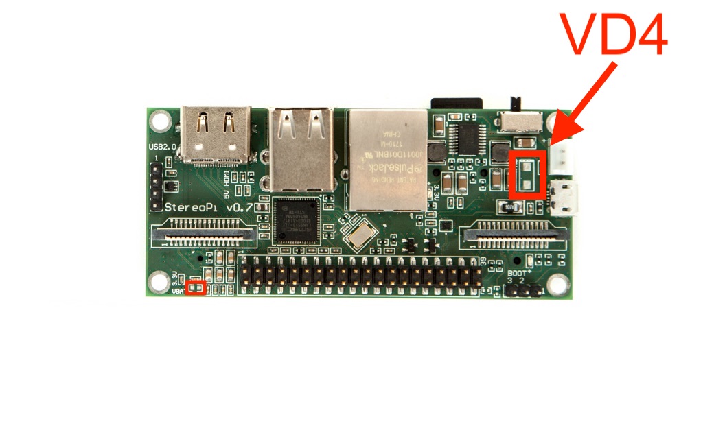

2. While our early stress tests, we found one component, which was the most temperature-sensitive. It is diode Schottky, or VD4 in our schematic, power part. This diode sits right in a critical place. If it is overheated, the USB hub is disconnected, and you are losing USBs and Ethernet.
3. If you will take a look at the very first StereoPi edition photo in our Wiki, you will find this VD4 is not soldered. I'm attaching this photo with the highlighted mount place. After our tests, we chose another version of this diode (more robust) but looks like in your special case it cause this problem.

VD4 mounting place
VD4 mounting place
