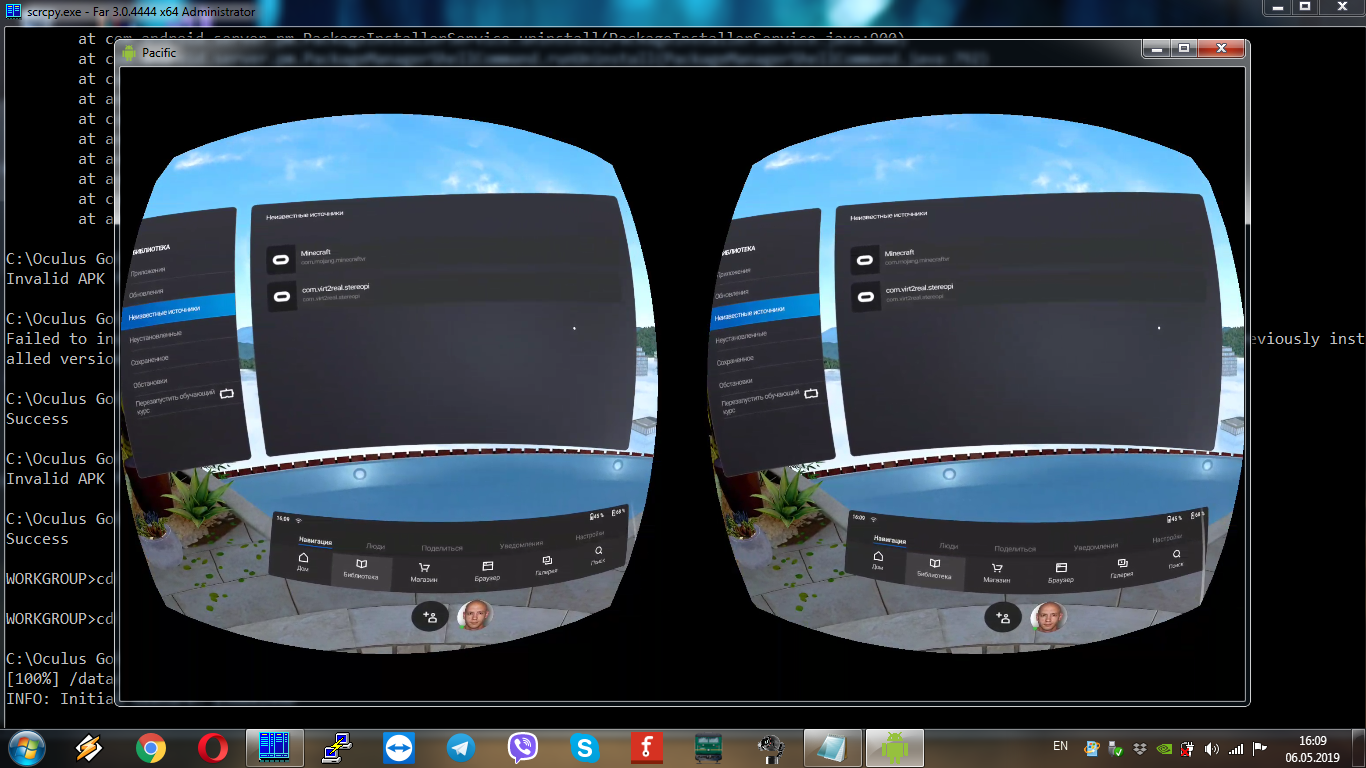

Here is an StereoPi.apk for Oculus Go. Archive also contains adb.
Install application:
Uninstall:
After installation application will be available in Library -> Unknown Sources -> com.virt2real.stereopi
adb install StereoPi.apkCode: Select all
adb uninstall com.virt2real.stereopi- Realizator

@wildag, Gol uploaded updated APK with fixed manifest file. This ZIP also contains adb.exe we used to upload. Please check if it works for you.
Also I've updated our Wiki by adding Oculus Go application section in S.L.P. image description.

Awesome! Thanks for uploading it. I've loaded that StereoPi-OculusGo app, and it worked! Very cool to see yourself in 3d

ororot, black screen means that app is started, but StereoPi is not found.orotot wrote: Tue May 14, 2019 6:09 am Hi all,
I think i was able to side load the StereoPi.apk to my Oculus Go - it is now showing up in the Unknown Sources menu. When i launch the app on the Go tho it is just a black screen. I presume it is a connection problem to the StereoPi.
1. is it a usb connection to the StereoPi?
2. did i miss something - i will go back and re-check the wiki
3. is is a wifi connection - that would maybe also make sense.
thank you !!![]()
1. No, it is not USB connection to the StereoPi. You need to have your Oculus Go ang StereoPi to be in the same network. StereoPi can be connected to the router by Ethernet (RJ45 connector) or WiFi, it does not matter.
2. I think you need just check network connection for both Oculus and StereoPi
3. For WiFi connection setup you need just to fill up 3 fields in stereopi.conf mentioned here. Set "wlan0", but not "wifi0", as "wifi0" settings is for built-in WiFi on the classic Raspberry (not for StereoPi).
