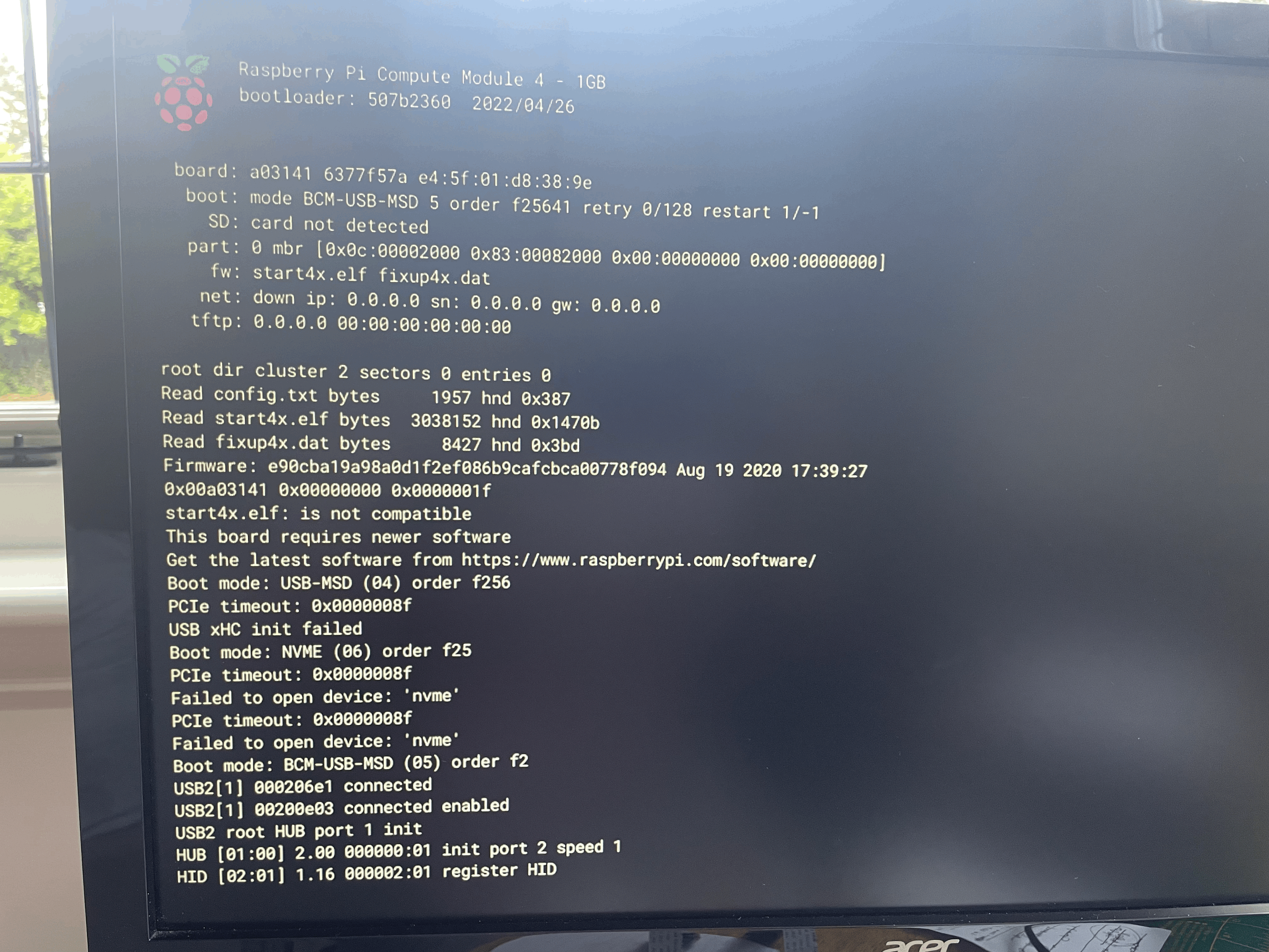

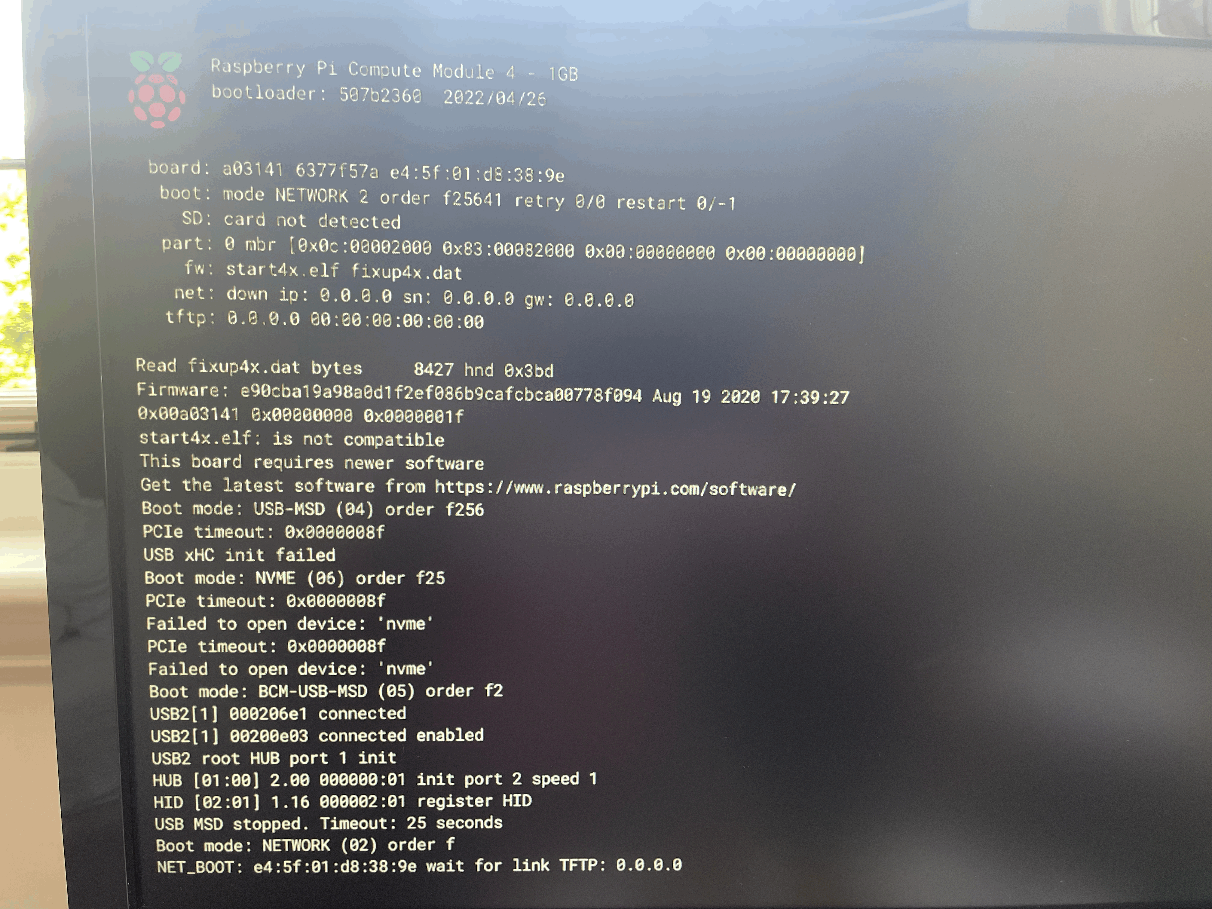

SLP2 and CM4 with 32GB eMMC
Hi Realizator,

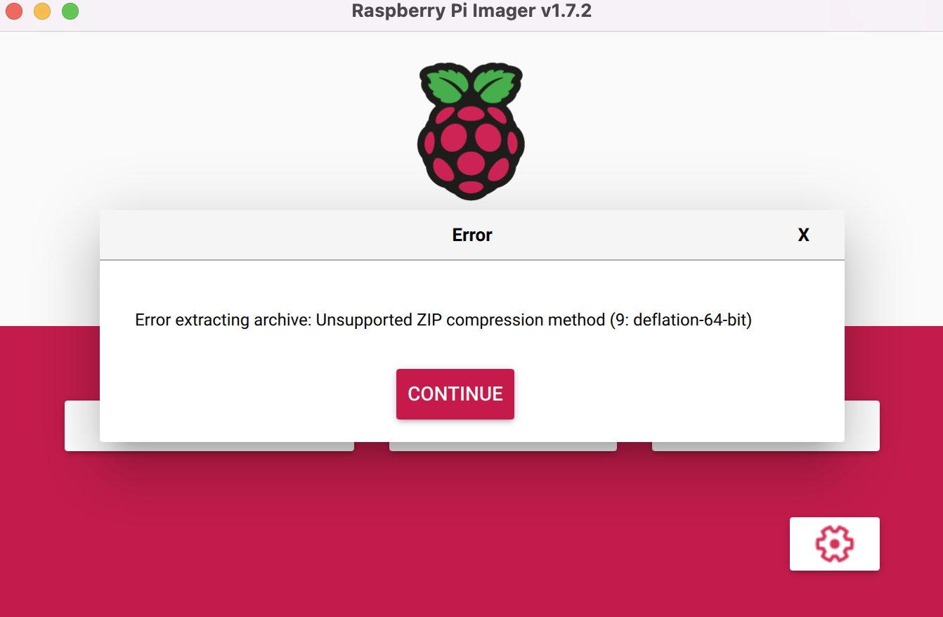

I'm struggling to get my Stereopi v2 to boot. I have mounted the CM4 eMMC on Mac OS via the terminal using the below guide:
https://www.jeffgeerling.com/blog/2020/ ... mc-usbboot
This allows me to use the Raspberry Pi Imager to find the eMMC under the storage button. I downloaded the img file here:
https://www.mediafire.com/folder/nzr90vj8wp1l3/SLP
I can only use the file called slp2-0.8.19.img.zip because both the OpenCV image and the beta version both give the attached error when I go to write to the eMMC.
I write the slp2-0.8.19 image successfully, then when I go to boot, it starts, but doesn't complete and I get the attached messages in an endless loop.
Please can you let me know how I can solve this?
Thanks in advance!

Re: SLP2 FAQ
Hey MJR2022,
Older SLP V1 (i.e. slp2-0.8.19.img.zip) won;t work with StereoPi V2, since this version is old and doesn't know about CM4 existence. Thus it's not booting.
Did you try to unarchive image file first, and record it to the eMMC then?
Your screenshot says you're on Mac. I'm using Balena Etcher, and it writes both images from the "mediaflare" successfully. Could you please check it this way?
