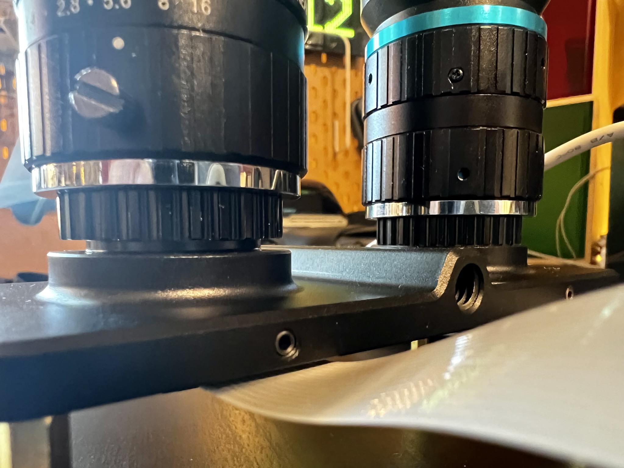

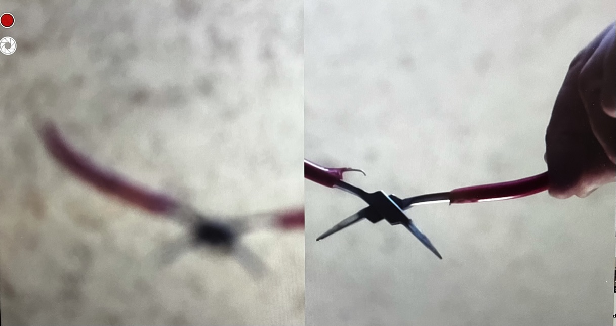

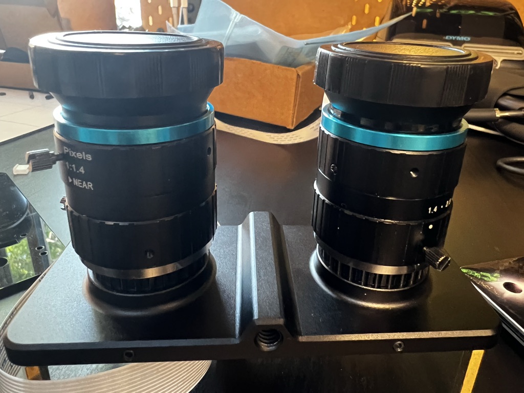

I've finally got everything working but my images are too blurry to do anything with. I'm using two HQ camera modules with two 16mm official raspberry pi telephoto lenses. I am able to get them to focus if I significantly loosen the lenses, but then they're too loose to stay where they are. Any ideas how to fix this. Am I missing some part?

The issue is that the 16mm lens is C-mount, and has a different working distance. You can notice that HQ camera has a special black ring to adjust this distance, and this led to difficult solution with additional components and threads.
The easiest solution is to use an appropriate C-CS adaptor ring. As I see on your photo, you are using the 5mm ring provided with the HQ camera or 16mm lens. The ideal ring height for 16mm lens is 7-8mm. If you have no this kind of a ring, you can use this kind of set with a few 2mm or 3mm rings to adjust the height of your 5mm ring.

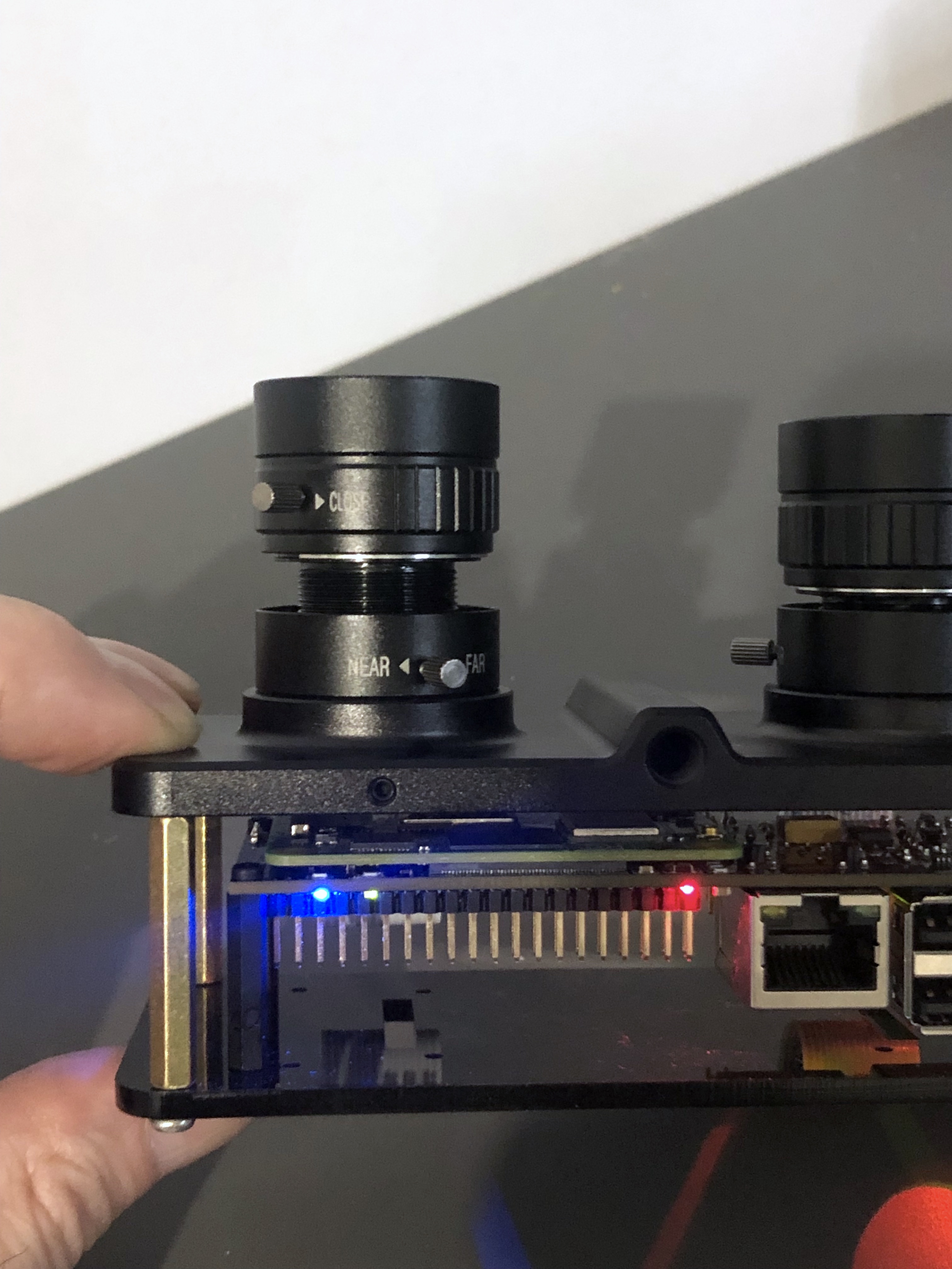

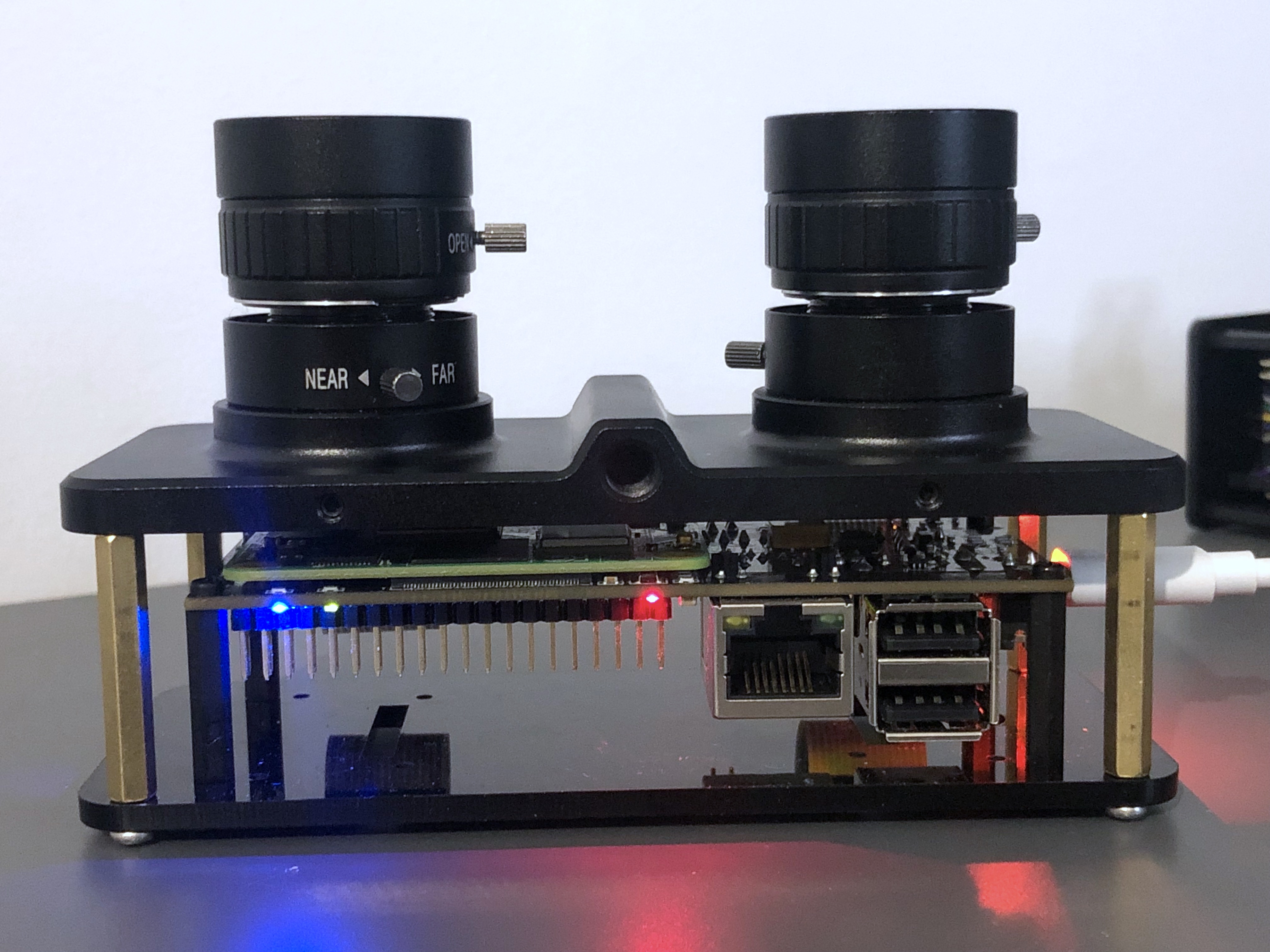

Did you try to tighten the iris fixing screw and rotate the very top ring after that? This adds one more level of focus freedom for the 6mm lens :-)
Could you please share a photo of the 6mm lenses installed?
In my photo, you can see two 6mm lenses focused without the C-CS adaptor ring.
Re: V2 HQ Housing Assembly Focus issue
p.s. Here is the photo which can clarify the 6mm lens adjustment margin. This feature in not obvious from the official datasheet for this lens. Look at the left lens here:
I mean other lenses might have the same "feature" of extra adjustment.
