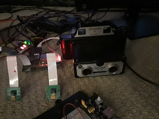

I really like your project with installing digital contend in old-fashioned camera! Cool! :) I think adding a "make photo button" on GPIO and connecting to your camera button is a good option!
