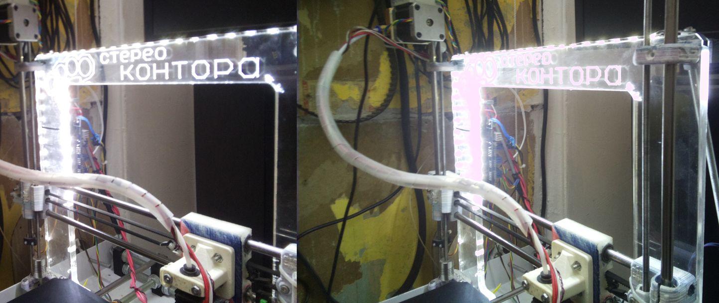

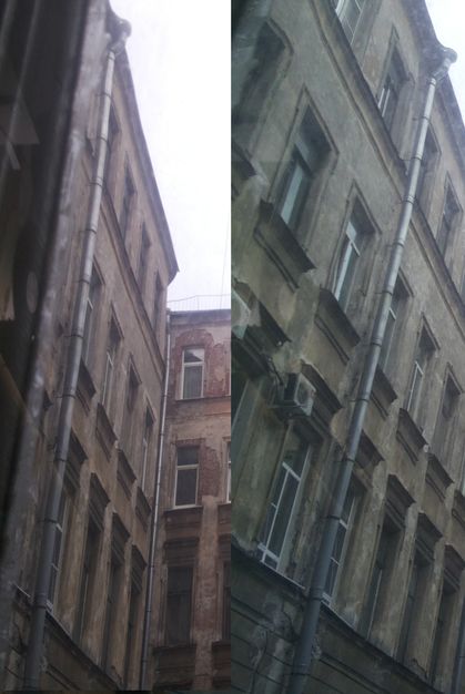

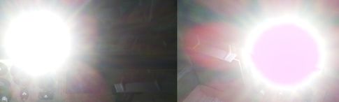

I have a problem with right pictere. It has a pink tint in overexposed areas. Why? I have swapped cameras, tryed 3 flexes, re-flash firmware. Anyway: tint only at right image. Also I have a light difference in colours, please watch pictures:

We had a similar thread here. I've also asked RPF guys to dig this issue, but no luck yet. All we know is this bug exists on Sony sensors stereoscopic mode (IMX219 for V2 camera and IMX477 HQ camera).
I also noticed another way users are trying to use - libcamera approach.
Could you please tell me which StereoPi and CM versions are you using, and with which RaspiOS you've tested this? I'll try to open a new issue at the RPF forum.
UPD> I opened the new thread on the RPF forum...

Thanks. My setup is stereopi v 0.9, stereopi-0-2-3, IMX219.
