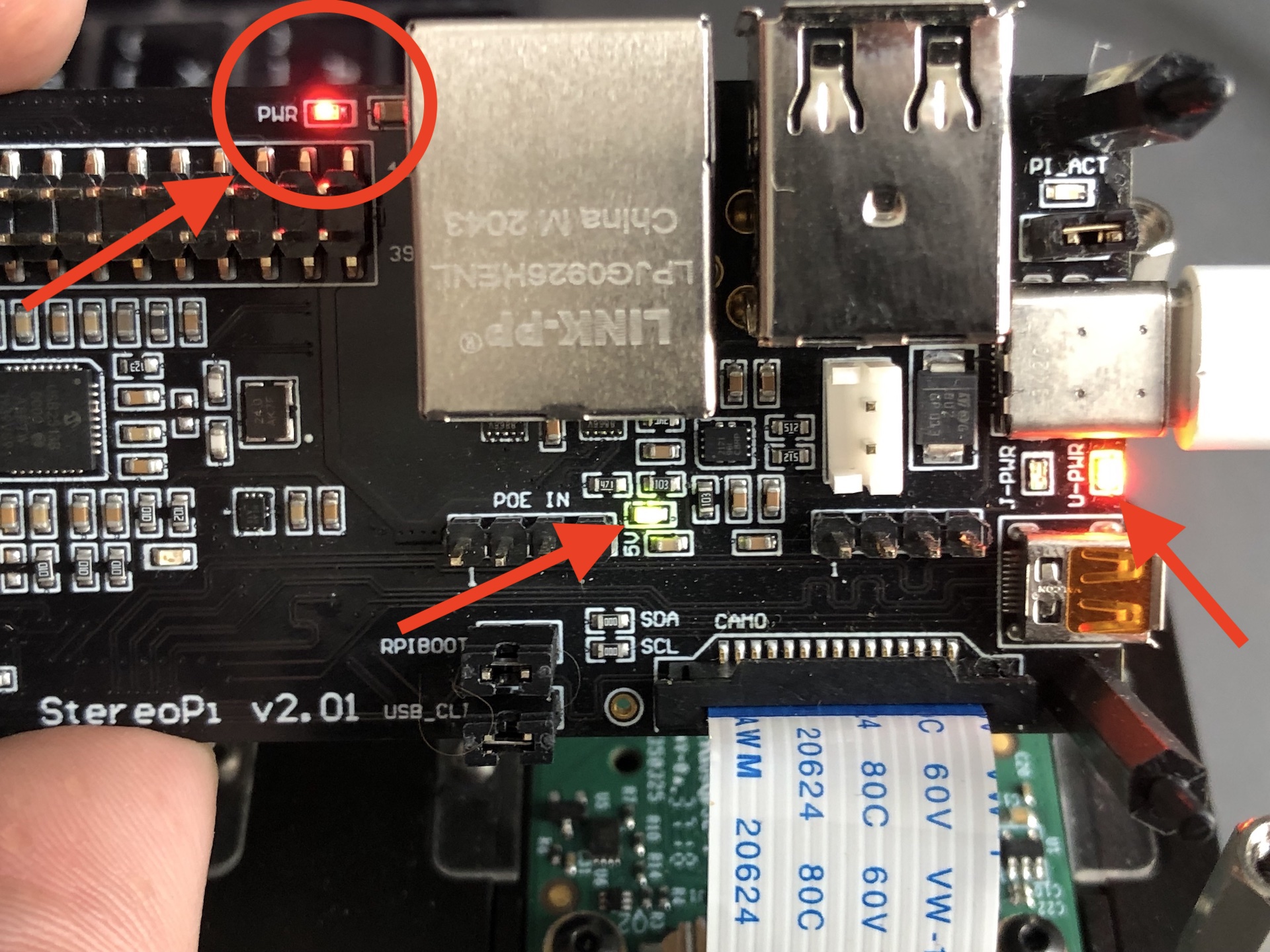

1. When you connect the USB C cable without the compute module attached, two LEDs on your StereoPi v2 should light up:
If you see only one LED (U-PWR near the USB C port), it means the board "feels" the power, but is not turned on. Please check your "switch" jumper is inserted (near the PI_ACT LED).
2. When you connect the USB C with CM4 inserted you should see one more active LED, which is "PWR". This means your board is powered on now and will either boot (if no RPIBOOT and USB_CLI jumpers attached), or go to the "mass-storage" mode for the eMMC upload.
Here is the photo of the board with all LEDs active:
The attachment with-cm4-noted.jpg is no longer available

Bingo! I didn't have the jumper connected to the jumper next to the PI_ACT LED. Once I did this, my Mac recognized the BCM2711 in the USB tree.
