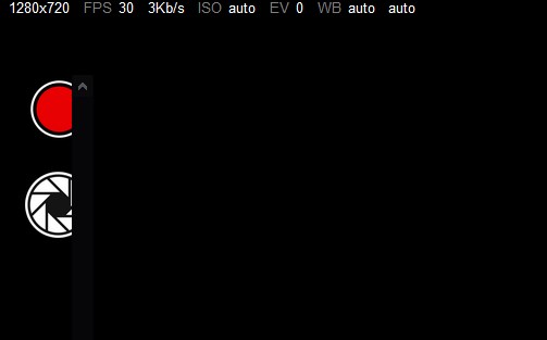

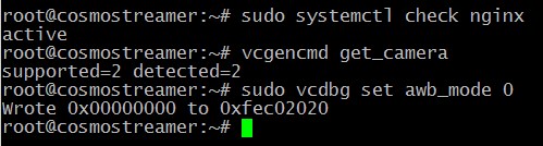

hi!
I`ve uploaded to CM3 stereopi SLP2 but have blank screen with only GUI-
I ckecked cameras presented and server working connected by SSH to stereopi -
And i couldn`t start up AP ( May be something here should be done -
Where to find what means what ?
Thanks for patience.
zoldaten
Posts: 48
Joined: Fri Apr 26, 2019 7:07 am
Re: SLP2 discussion
Post by zoldaten »
ok. got it working. just needed to set up camera settings in options menu.

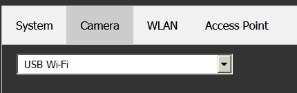

Ok I got SLP2 image flashed OK.
About the Wifi: I get cosmostreamer to act as access point and I can connect to the camera with laptop ok. I would like the stereo pi to connect my home wifi but I haven't been able to get it join network for some reason.
Cosmostreamer.conf file seem to have few settings that are relevant. First one is ap_iface and so on that setup stereo pi as an accesspoint. It does work. Then there is wifi_iface settings that would logically be the same as those in stereopi.conf file, but adding network information to those settings does not get stereopi to join network... Am I missing some setting or having bad luck otherwise?
Based on quick testing I have been able to do so far there is couple of things I need to get right. First I only got recording working for 1280x720p setting (I have HQ Raspi cameras) setting cameras to 1080p seemed to hang the interface. Other thing is that my lenses are 2.1mm crap CCTV lenses and their field of view is less than 180°. It there a setting where you can change lens parameters? From shell or somewhere (GUI does not seem to have any settings for lens parameters)
