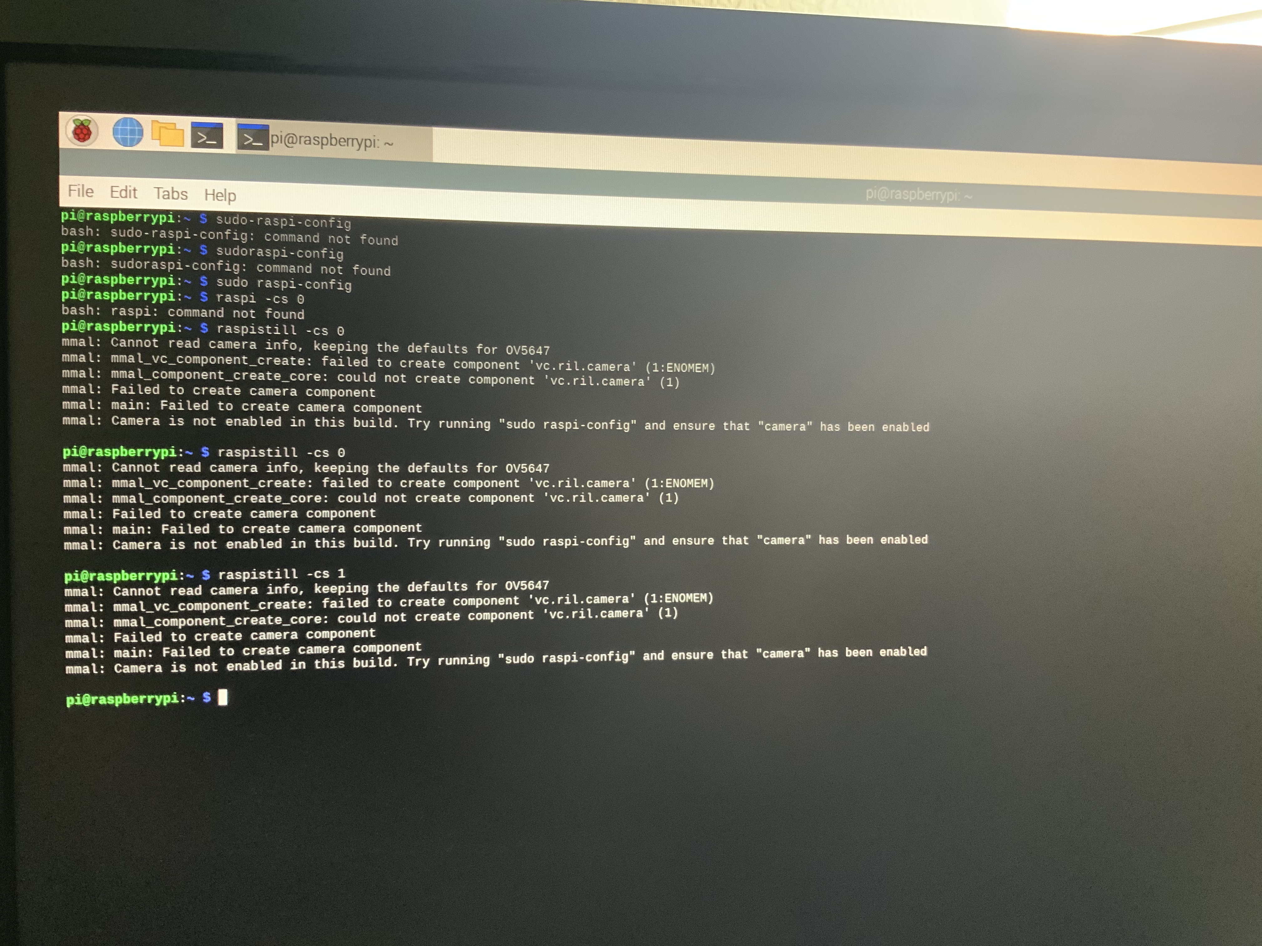

Thank you for the last suggestion; however, we still appear to be receiving the same error code after making those changes. After attempting to install a new raspberry pi OS, we are not able to find the “stereopi.conf” file which may be affecting this. Are you aware of where this file could be located or how it could be replaced?

- Error Code
- EE7375CE-A108-4E00-8B6A-6AE77C1986E2.jpeg (3.99 MiB) Viewed 17293 times
Re: Fresh Raspbian Image Start-up
RoggieC, the fresh RaspiOS have no "stereopi.conf", as it is SLP-specific file.
The errors I see on your screenshot say cameras are not detected. If this setup works fine with the SLP, it means this is the software issue.
