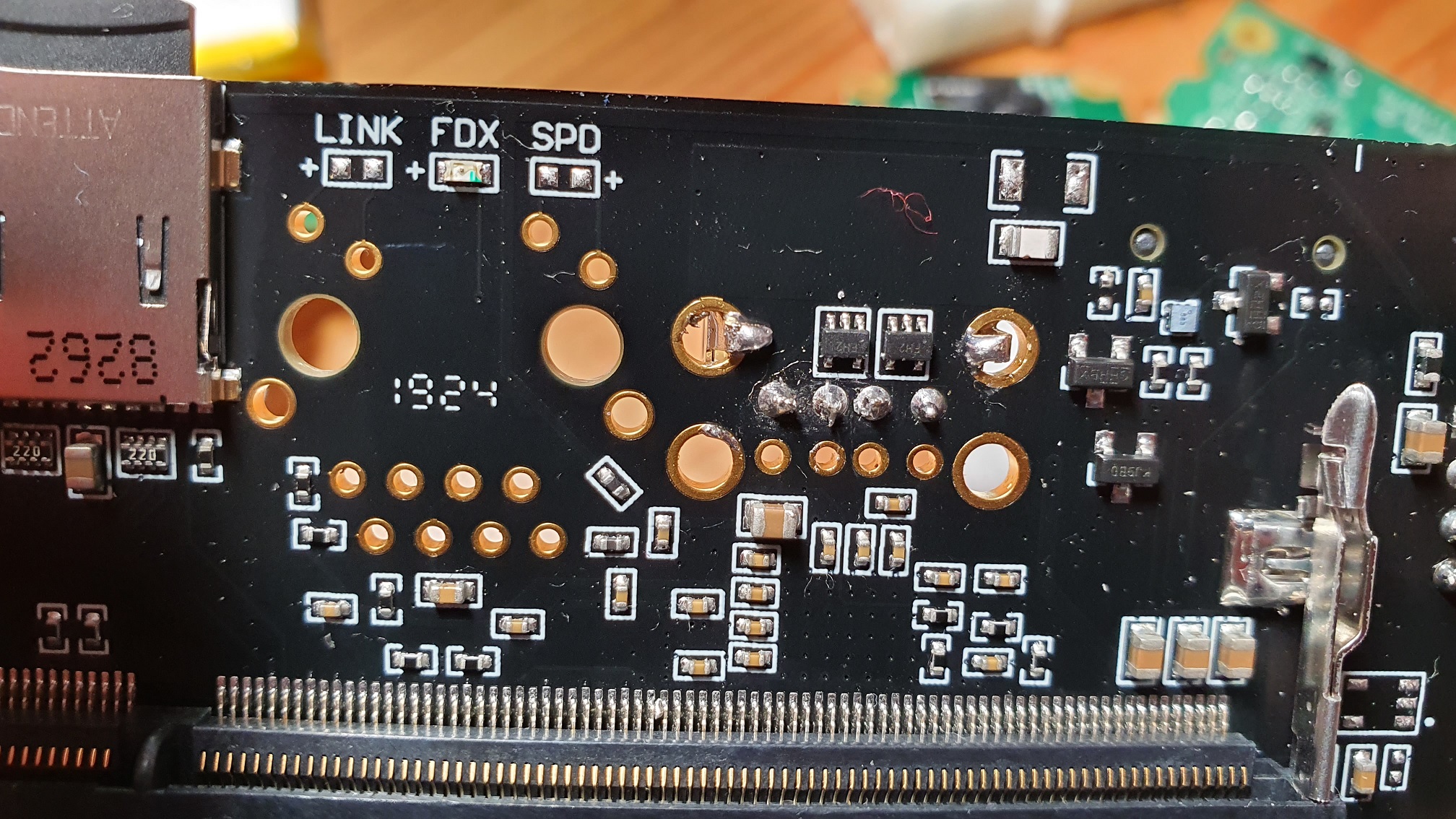

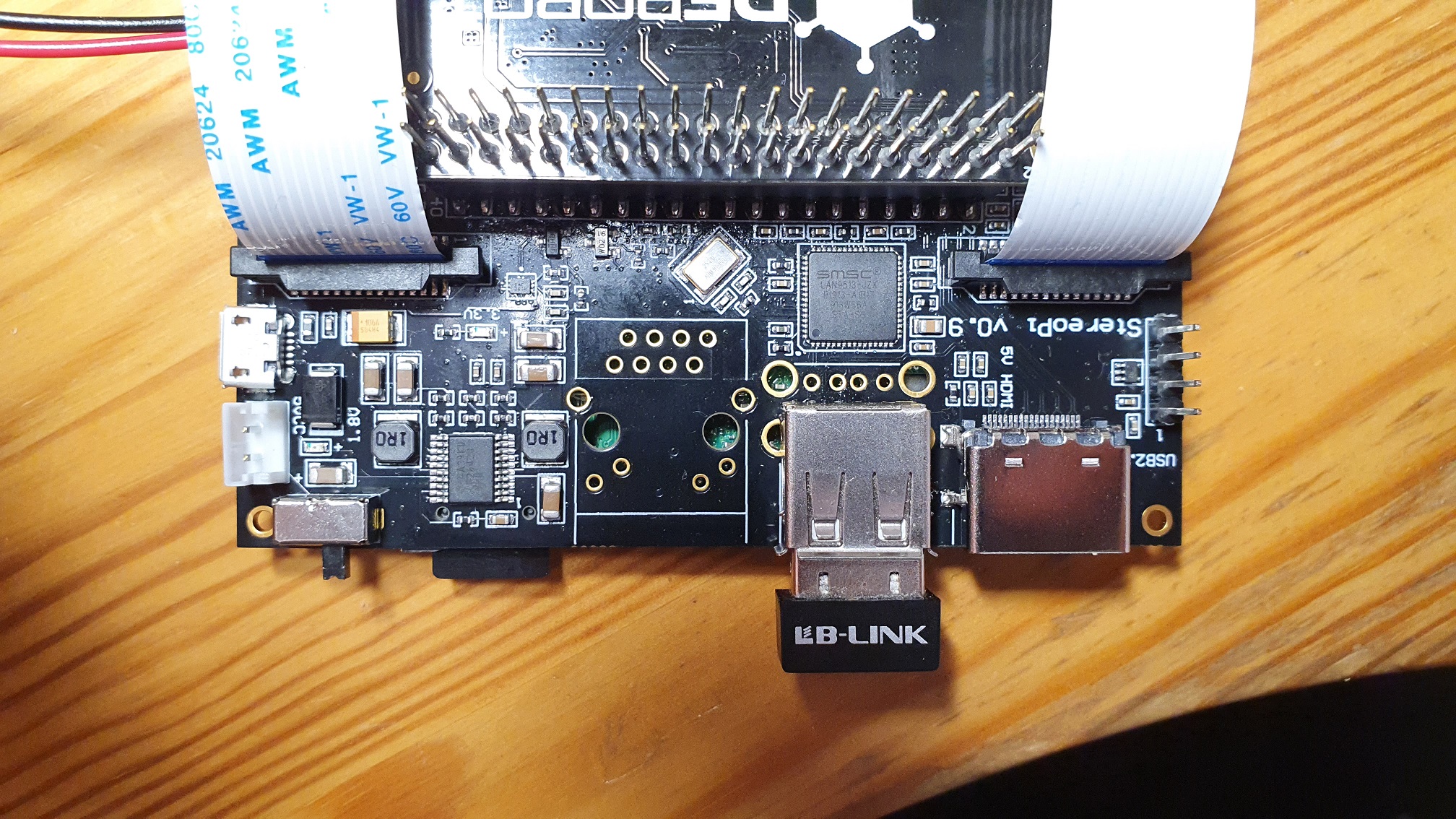

I have similar issue with StereoPi Slim: I soldered a single USB A female connector in order to remain slim. I have an RTL8188CUS chip based LB-Link Wifi adapter that should be Raspbian compatible according to this link: https://elinux.org/RPi_USB_Wi-Fi_Adapters . I use SLP v0.2.3 and set the SSID of my home network and the password, still I cannot see the StereoPi with IP scanner, stereopi.local link does not work either. I wonder if soldering a single USB connector should work (the one which is closer to the edge) or only a double USB connector works? I don't know much about Raspbian and how it enumerates devices, which is the first USB, with the connector nearer to the edge or the other one? What if the one I soldered is the second one and Raspbian does not use it unless the other connector is used also?...

- 20210515_234957.jpg (959.13 KiB) Viewed 103433 times
- 20210515_234910.jpg (861.37 KiB) Viewed 103433 times

Update: the wifi dongle works if I connect it to the USB port pin header, but it would be nice to make it work via the soldered USB connector...
Re: StereoPi Slim Edition USB Issues
Sorry, it is solved: it was a soldering issue. I have just resoldered the USB port and now it's working!

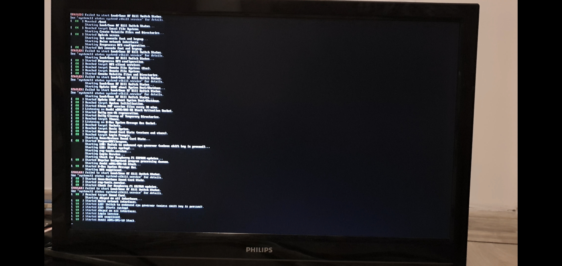

I'm afraid I need your guide... After resoldering, the USB wifi dongle worked well, I installed the software needed for a Waveshare 1.3" TFT HAT (looks the same as you tried, just 1.3" 240x240px with joy + 3 buttons). Now I cannot SSH to the Stereopi, Angry IP scanner does not show it. The LED on the LB-Link wifi dongle is lit (before resoldering it was dark), so I think that the dongle should work. During boot I can see some failed messages, however I cannot see the connection between them and the wifi (sorry for the blurred image, it is a screenshot of a video made by my phone). Could you please help?

Which OS are you using? If it's SLP, is this v1 or v2?
As the basic troubleshooting, you can try to install the fresh stock Raspbian, screen drivers, and your dongle drivers and check, if it works on the regular Pi. After that just insert this card to the StereoPi. If USB WiFi works, it means that everything is Ok with your dongle and soldering, and we'll dig the software settings. If not - it means we might have some hardware questions.
Your error messages say the system can't run rfkill - it's a part of WiFi initialization process. This can be both software and hardware issue.
