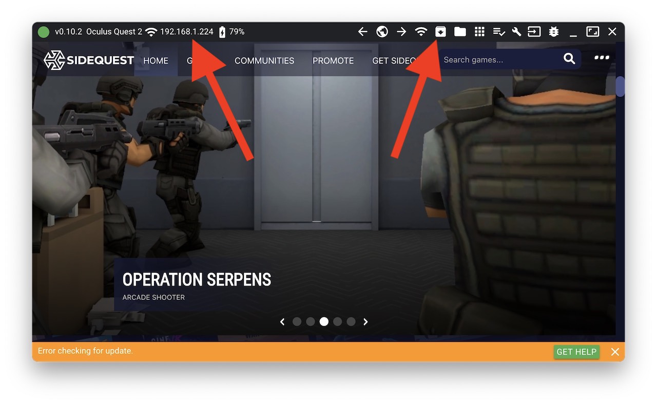

Use the SideQuest application to upload it to your Oculus Quest 1 or 2.
Right red arrow on this screenshot shows you the button for the APK installation.
Please note, SideQuest is showing the IP address of your Oculus at the header of the window (left red arrow). You might need this info on the next step.

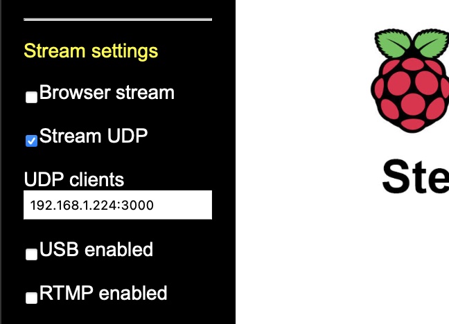

2. If you are using SLP1 Raspbery OS image, you need to put the IP address of your helmet to the "UDP clients" field, including port 3000, and press "save" at the bottom of the settings window.
On this screenshot, you can see example settings for our Oculus, which got IP address 192.168.1.224 from the router

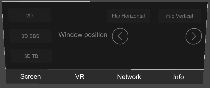

1. "Screen" mode
In this mode, you will see your video on the virtual screen. On this tab you can choose the video mode:
2D - show you the video "as is". Use it for a single camera mode, or for reviewing the alignment of your cameras
3D SBS - stereoscopic mode for the side-by-side video. Please set the appropriate mode on the StereoPi
3D TB - stereoscopic mode for the top-bottom. Please set the appropriate mode on the StereoPi
"Window position" - choose the distance to the virtual screen (near-mid-far).

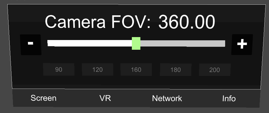

2. VR mode (2x180)
In this mode, the video from each (wide-angle) camera is used as a texture for the hemisphere, and you are looking at it from the center of the sphere. Moving your head you can look around, like in the real life.
In this tab, you can set the FOV for your camera. Press one of the preset buttons, or use "+" and "-" buttons for the precise settings.

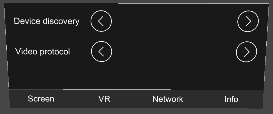

3. Network
If you are using SLP 1 - ignore these settings. For the SLP2 you can turn on/off auto-discovery mode, and choose UDP or TCP stream type.

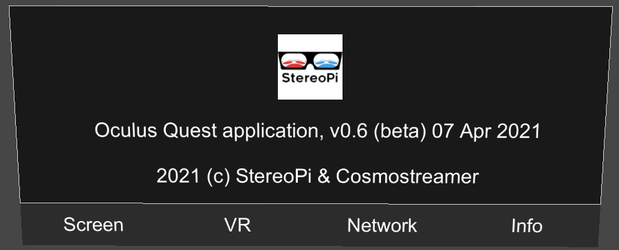

4. App info
You can find the current version info here.
