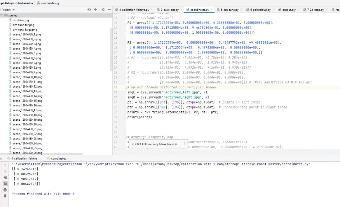

Now I just want to find the 3D world coordinates of any point in the image with known coordinates. I am using these projection matrices and use them in the cv2.triangulatepoints() function. It gives me a 4x1 matrix. This function gives answers in homogenous coordinate. So I convert this in 3D coordinates by dividing the 4th value in this matrix with the first three values of the matrix. and this will give me world coordinates of the specific points according to my knowledge as far as I have gone through this cv2.triangulatepoints() function.
I am getting a difference of almost half value for X, Y and Z coordinates.i.e for the original distance of 3 meters it is only showing 1.5 meters in the result.
I am following his approach (https://stackoverflow.com/questions/461 ... n-2-7-with)
I have attached the picture from my code for the cv2.triangulatepoints() function.
P.S: The problem is the wrong coordinates that I am getting by this approach. Also, I am not sure if I am using the correct method or not to find the 3D world coordinates. I am stuck at this point. I have no idea what to do next
Kindly guide me if I am following the wrong approach

I have no experience in the domain, but I see that the only input of the function are your calibration matrices and the coordinates of your homologous points.
Thus, I would suspect that the calibration is not good enough.
I suppose that the RMS value you talk about is computed as reprojection error of the calibration points, which denotes that the computed matrices correspond to those points, but were those sufficiently significant? Did you checked the rectified images?
I suppose that you use the coordinates in the rectified images, do you also use the matrices corrected for the new projection?
With a rough calculus, using a 1171px focal, your points seem too far apart for the 14cm/3m pair you gave, or the base is bigger or the object is closer. Also, the "center" terms of the matrices look a bit suspect to me, but not sure.
