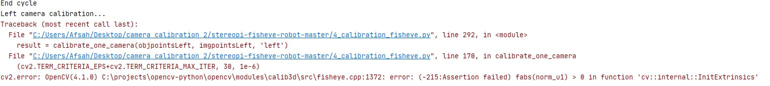

I am new to camera calibration. I was using this code for stereo calibration to calibrate a single (left) camera only. I have comment out all the code lines for stereo and right camera calibration. It works to recognize corners of chessboard but it gives this error when proceed to left camera calibration. I am applying this code for one camera only at this stage because I have to use it further in my project to calibrate 2 cameras. I wonder if this code can work for single camera or not? can anyone guide me please. if it cannot be used for single camera then I will go directly for 2 cameras calibration.
thanks in advance
thanks in advance

If I read it right, the original code first calibrate the two cameras independently (camera matrix + distortion) and then calibrates the system of two cameras (relative translation and rotation). Thus you can use the calibrated data for one side only if you want even if you do the whole procedure. You can probably calibrate only one camera by commenting the right parts, but I would advise to read the OpenCV documentation so that you understand a bit more what is done.
I did not played seriously with the calibration part, but several problems reported on the forum were due to bad input data. In particular, you can set drawCorners to True to check if all detected chessboards are at the right position and in the same orientation in each image. If I am right, the chessboard also needs to be tilted (one side closer to the camera, with different angles) so that the perspective is detectable by the algorithm.
