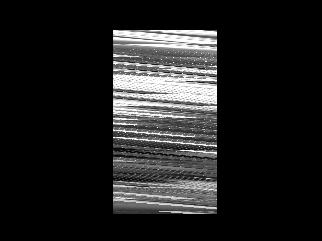

Unfortunately the image produced from this is not as I would expect, clearly something has gone very wrong. Image attached.

2. Actually, your YUV output is not broken, but just have a horizontal "shift" for each row. You set 100x100 resolution, but actually low-level capture part has some resolution requirements (like width is dividable by 32 and height by 16). When you use an "easy" capture, PiCamera will actually scale image to your resolution, if it not fits internal rules. But with the YUV you need to keep follow these requirements, as it is low-level access.
Luckily Dave Jones (PiCamera author) put this useful answer on StackOverflow. And the first piece of Python code does right this thing that you need - it takes Y component of the captured image only. Please notice camera resolution (120x90) and array size (96, 128) he used for the frames:
https://raspberrypi.stackexchange.com/q ... wnsampling
