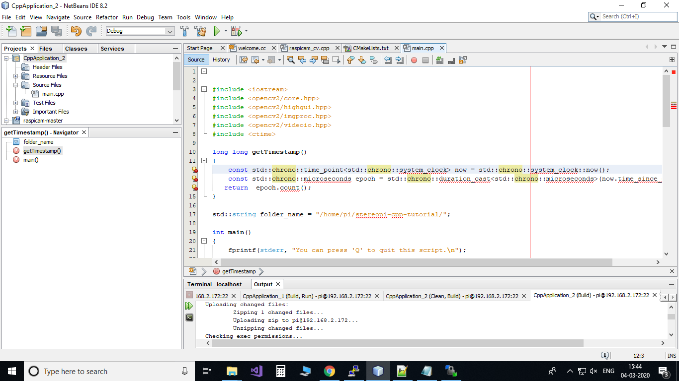

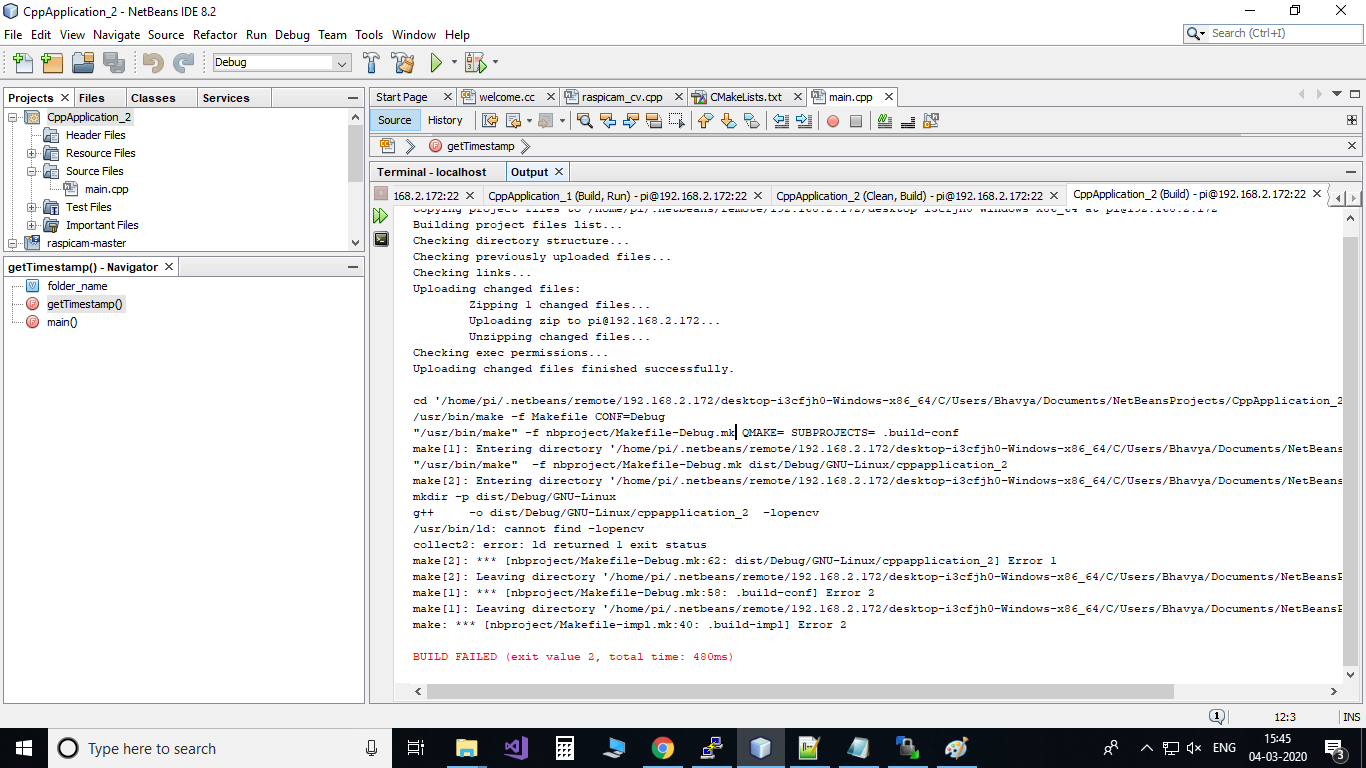

I'm using the 64bit desktop,I have connected hdmi cable and mouse and keyboard,I have changed user name to pi.and I'm going to do my c++ code in netbeans IDE 8.2,and puTTY compiler im using as console.I'm going to execute the script1.cpp but build failed. Im attaching the files below. help me to proceed next.

Re: How to work with Stereo Pi
Can you exclude your desktop from this experiment?
Try to connect mouse, keyboard and HDMI monitor directly to your StereoPi, and compile/run examples like shown on our video?
