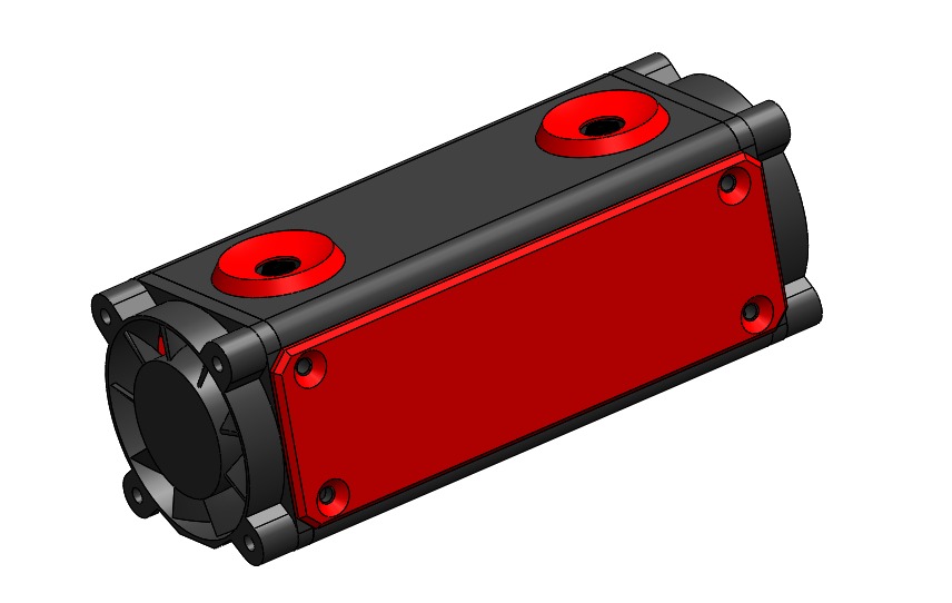

JFYI, one our StereoPi users designed this "overkill" fan solution for extra-warming.
Also I'd like to notice, that with CM3+ in comparison with CM3 we got about 20 degree celsius lower working temperatures in peak load modes.
